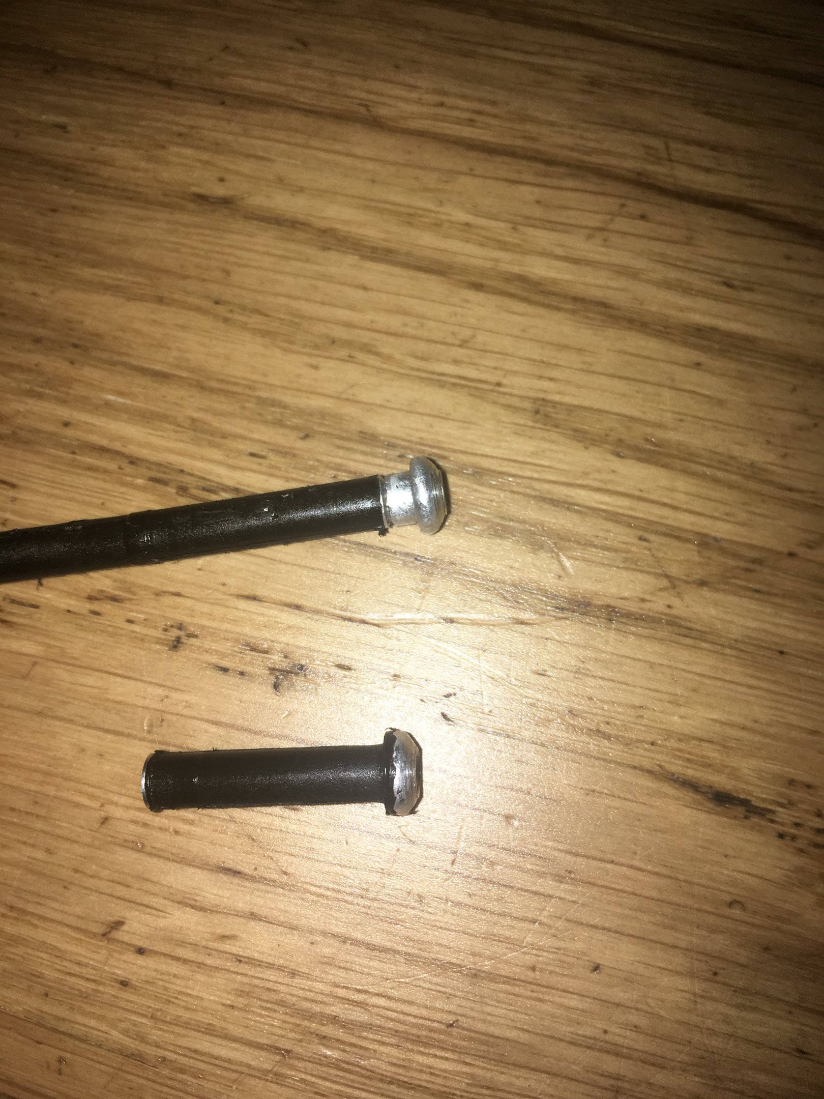

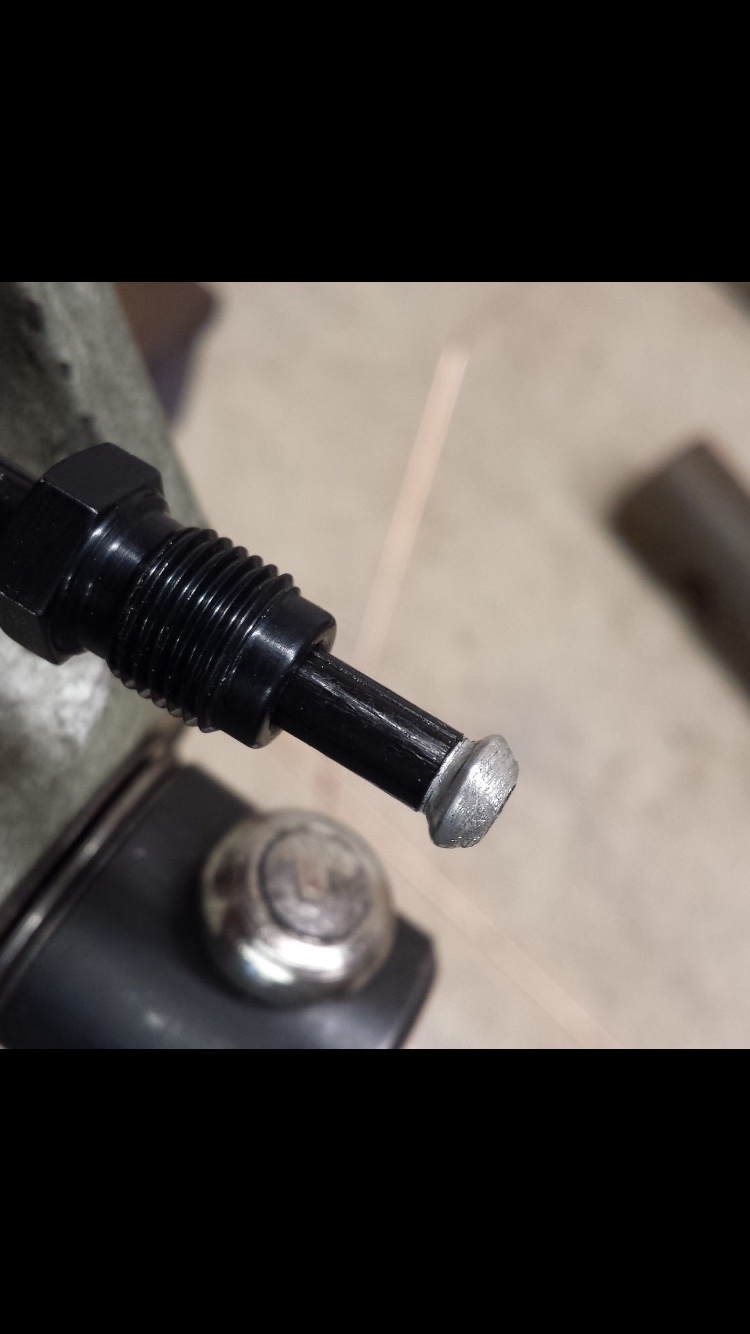

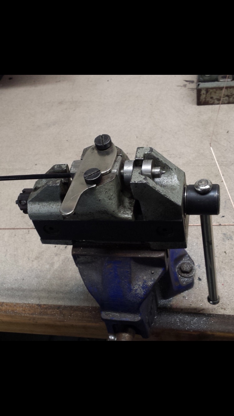

I used a proper old school tool that my dad had in the garage.. probably cost a fortune these days!..
I then cut the plastic off after I had formed the end, as you have, using a Sharp blade and a needle file
Looks like a solid piece of kit! I think the moulds are the way to go, dont see how it wouldnt give the exact same result everytime
