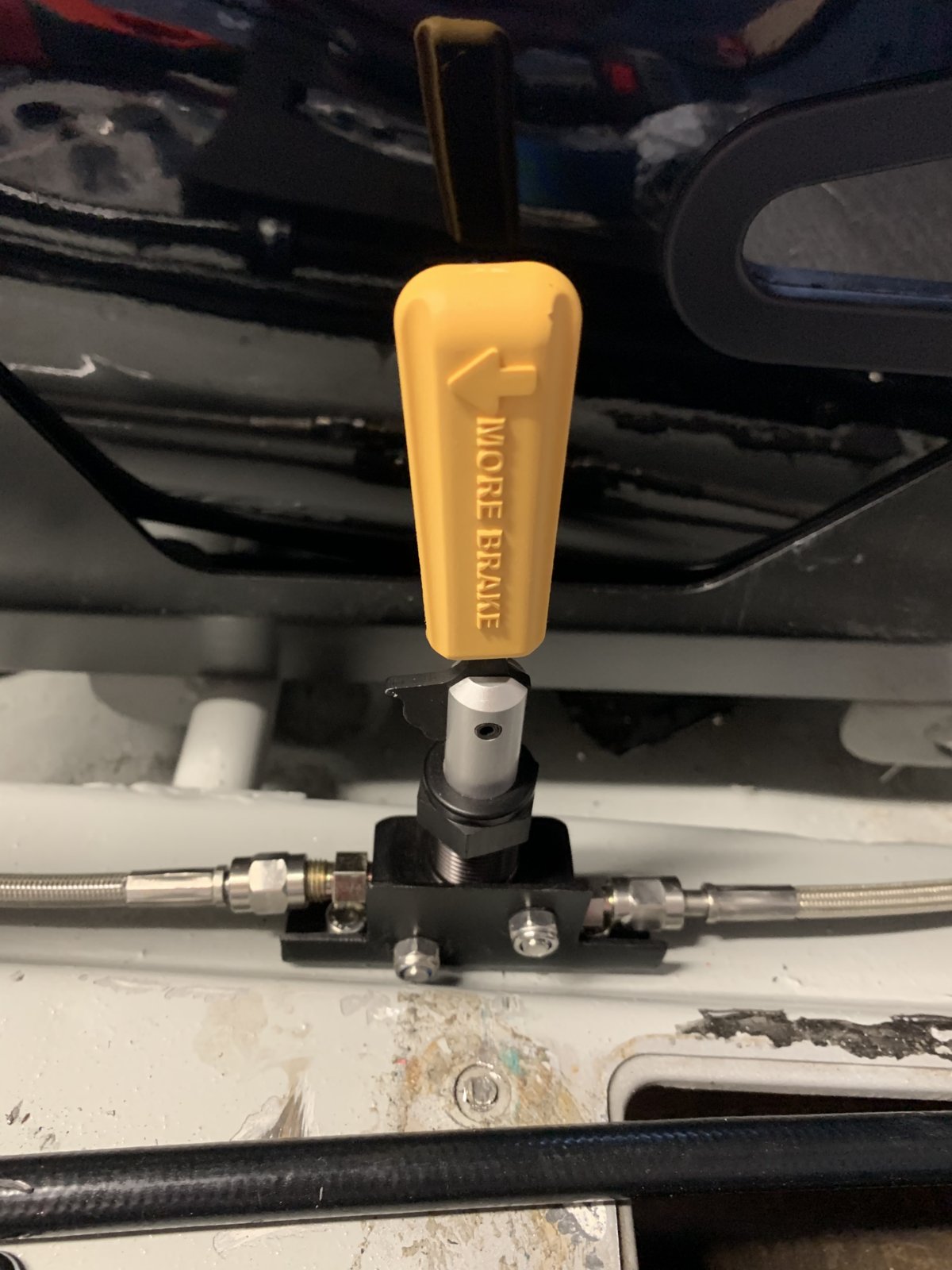

Thank you. Is this the proline kit?
Did it fit ok in the end?
It is yeah. And no it did not fit well ?
Was missing locking nuts for the rear bulkhead adaptors and somert else which I had to order off eBay and I ordered one hose off Hel brake lines site through their custom hose section as one from prolinemotorsport was wrong and he was being difficult. Ideally the hose from the bulkhead to the bias valve I need to reorder as it’s a foot too long. Would need to exit out the AC blanking panel to be perfectly straight ?

I’d get one of the prolinemotorsport kits in a basic colour, what fits, fit and resize and reorder from Hel. There really well priced.
The hose I had to reorder was the first rear section. So from master to bulkhead. He sent me a straight fitting into the master and the wrong bulkhead connection. So I ordered a 90 bend and correct bulkhead fittings etc and was 24.95 delivered next day.
