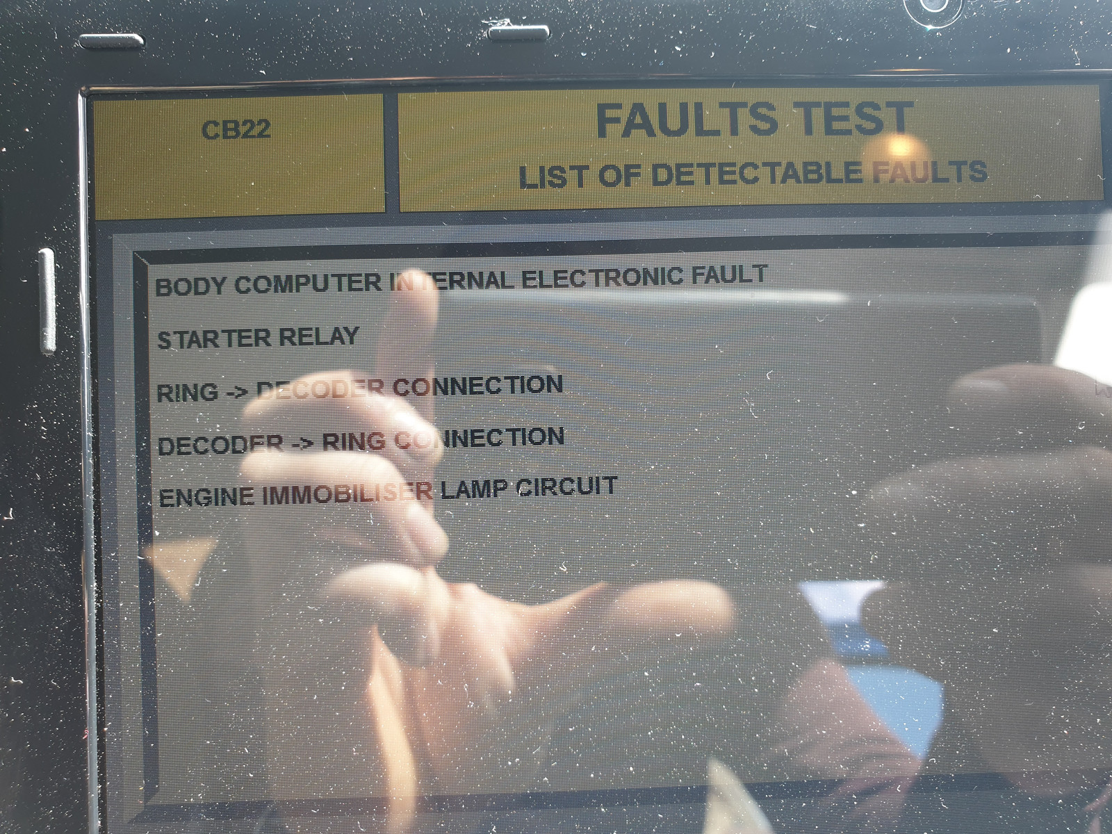

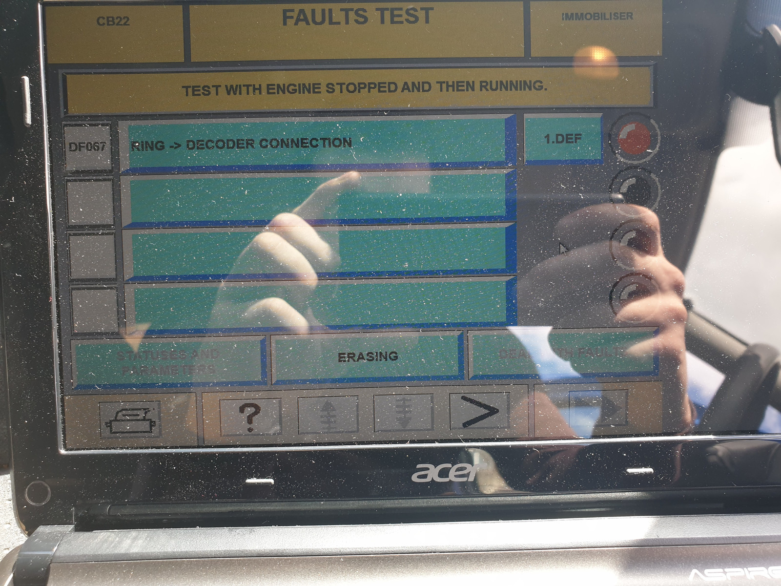

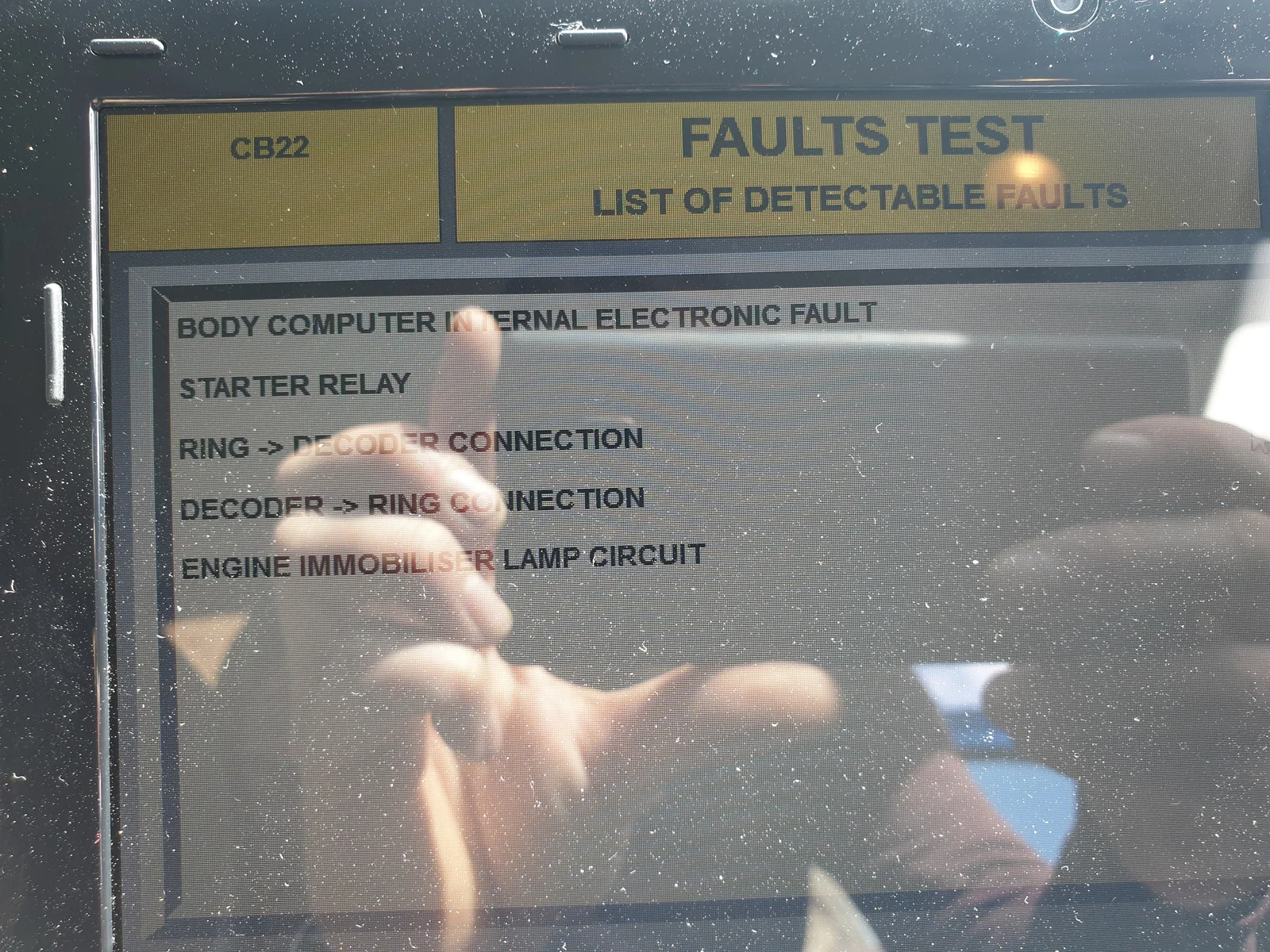

I managed to get it on a clip today and it came back with these immobiliser faults.
J273
  RB 182
I cant see it being that as this is a brand new key i had around a year ago and ive just changed the battery to make sure, Ill go try my spare key see if i get the same fault.
