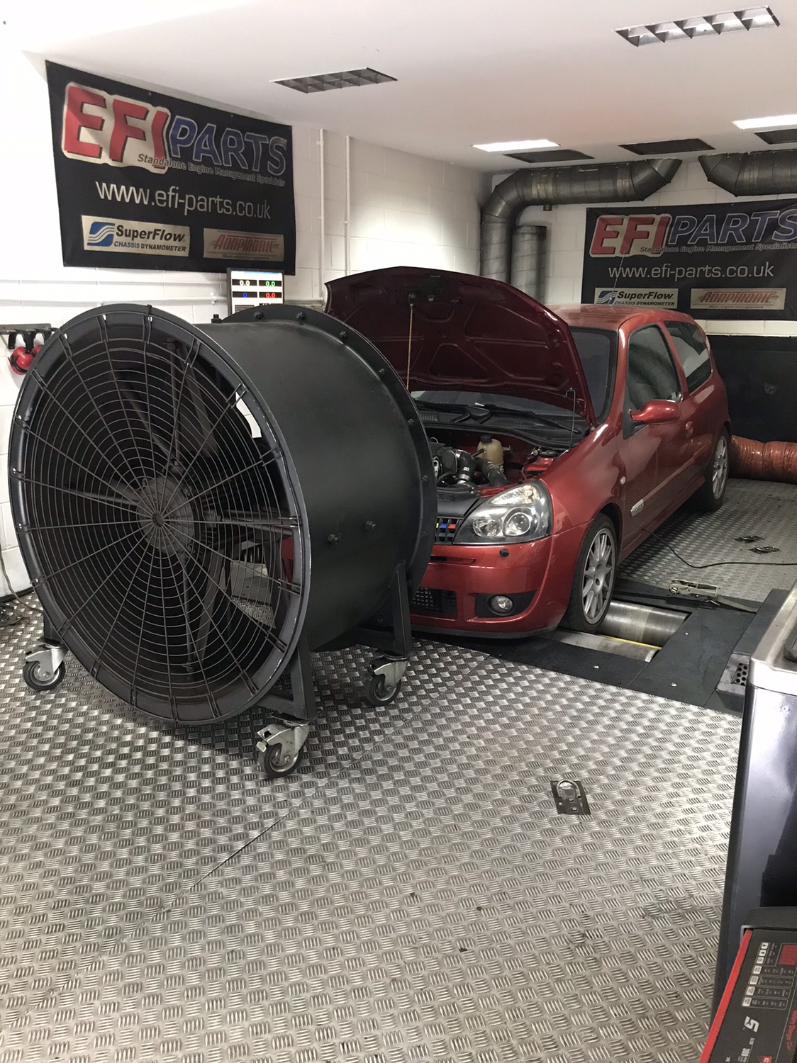

Picture of the car on the rollers.... just because!
