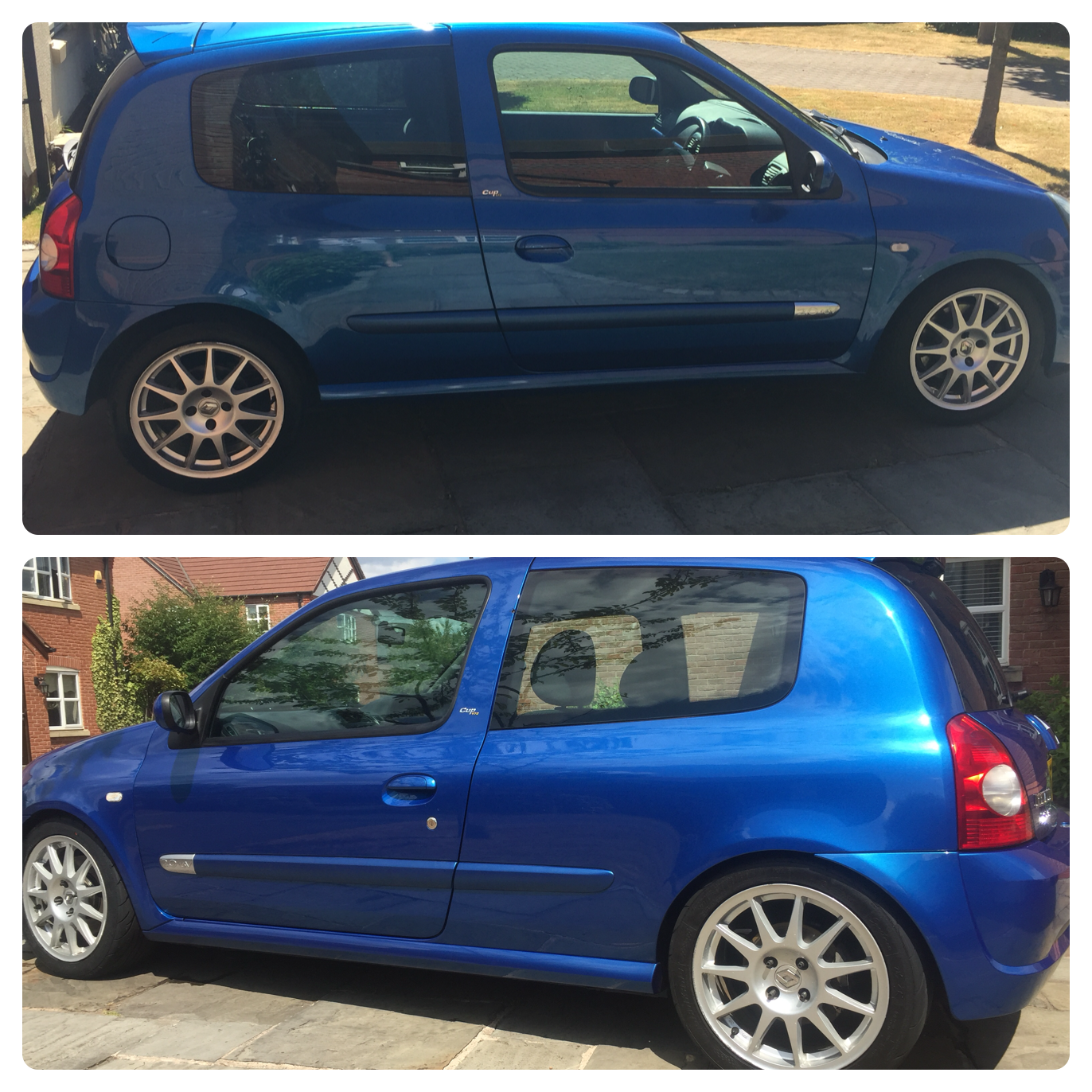

So I picked up my first clio around a week ago, and now the project starts turning it into a track toy!
Picked up and ready to be delivered!
(Currently sorn with no MOT)

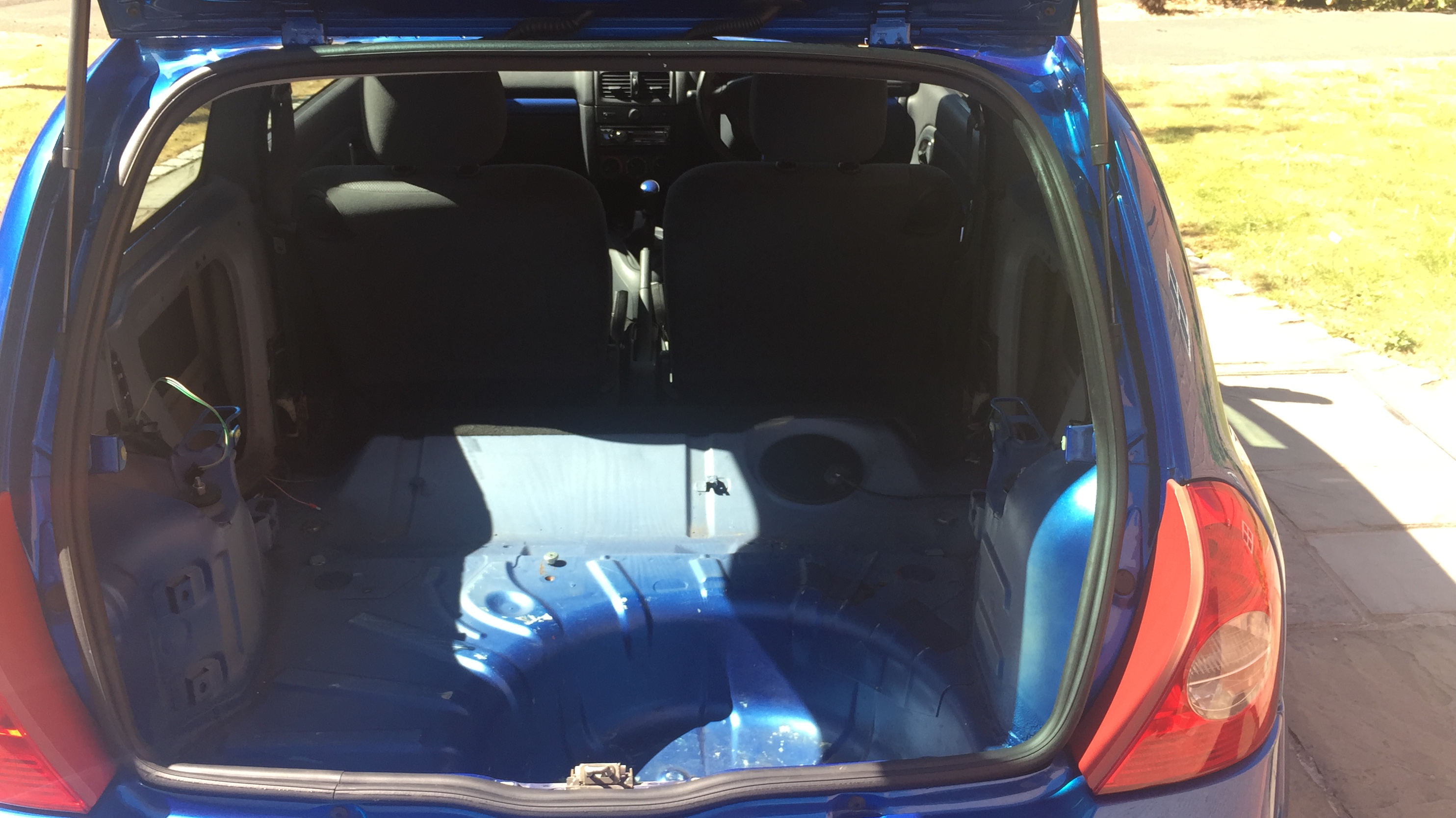

After taking delivery and a wash and strip out of all the rear it was ready for its MOT!
After a couple of days in MerseyClio and some top work with @bloke , Clio now has a clean bill of health!

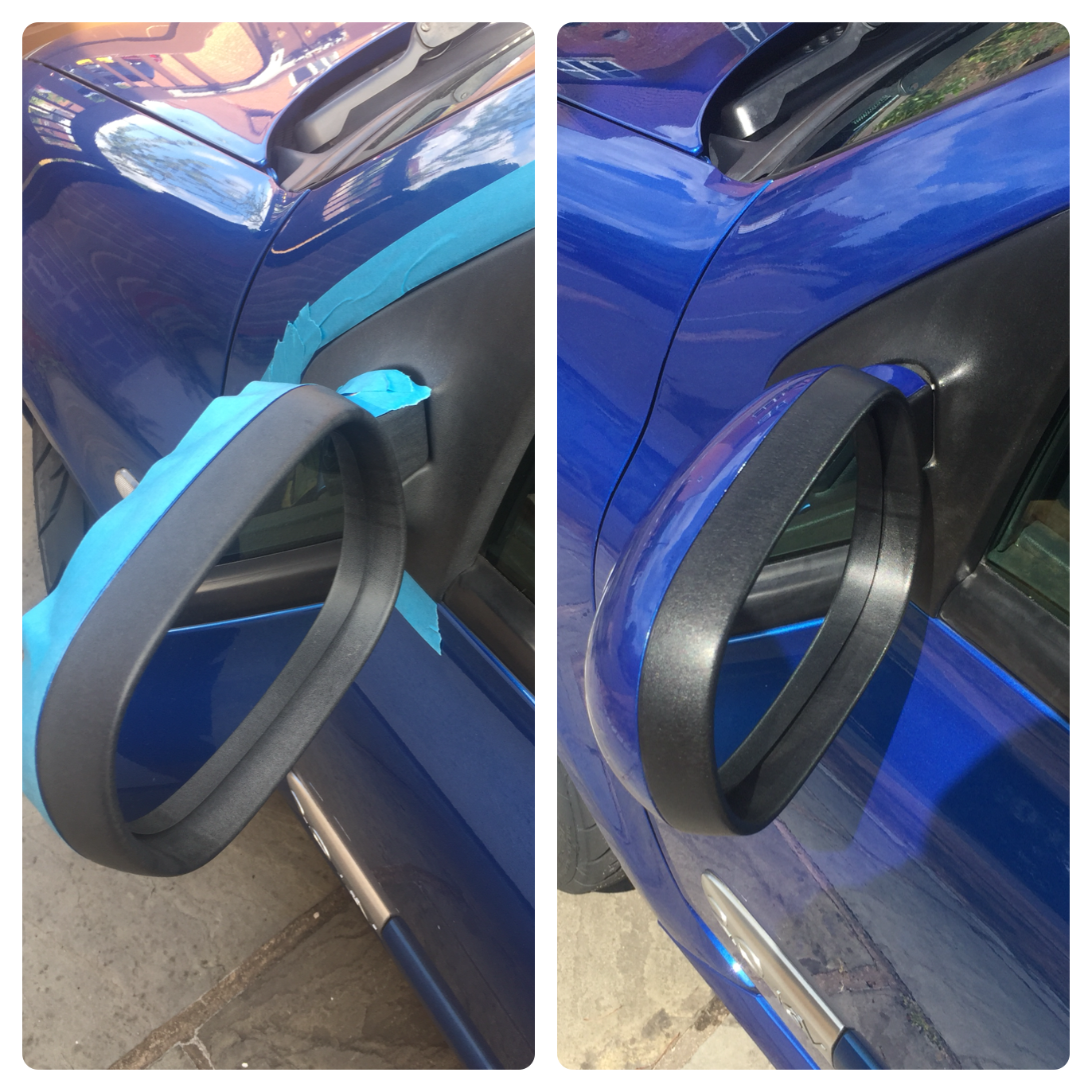

After that it will be a deep clean, restore plastic trims and machine polish.
Jamesgsi1983
  N/A

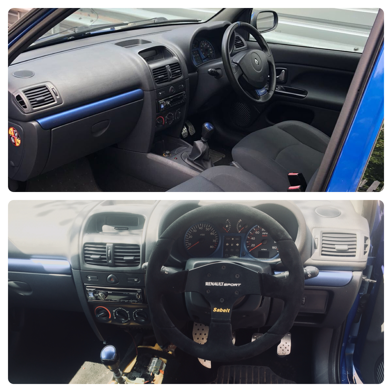

Bit of work completed over the weekend following track geometry set up at TunedUK. Rich did a top job to be fair, feels much better on the road now and more responsive.
Spent a bit of time cleaning after it’s work.

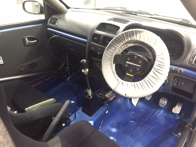

So a fair bit has happened to the car recently, and a fair few pics will probably follow....
To start you can see some of the progress being made....

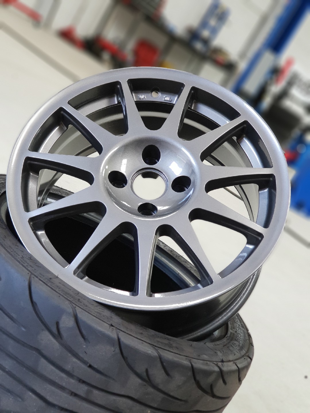

Great refurbishment on the wheels sorted and ready to go back on the car

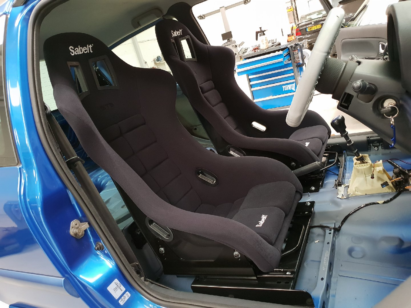

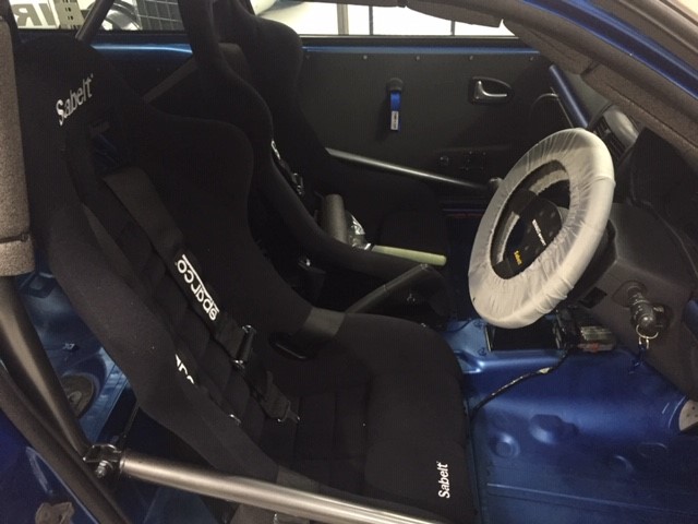

Seats now mounted in the car on sliders and OMP sub frames

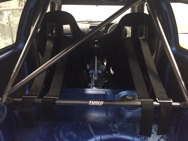

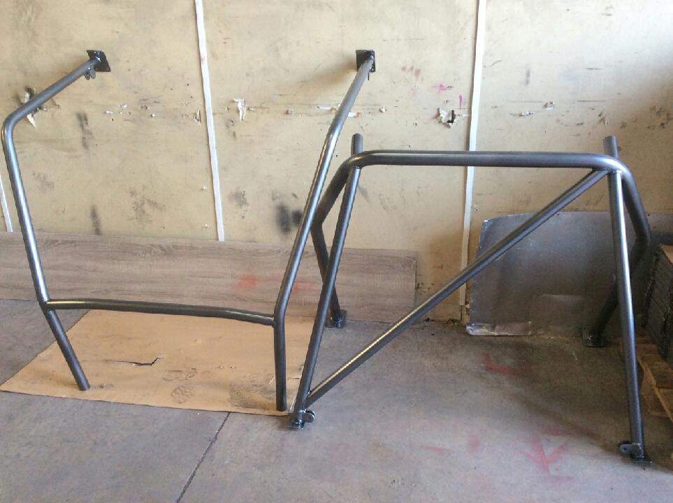

Sparco cage prepped and sprayed to colour match the newly refurbished wheels

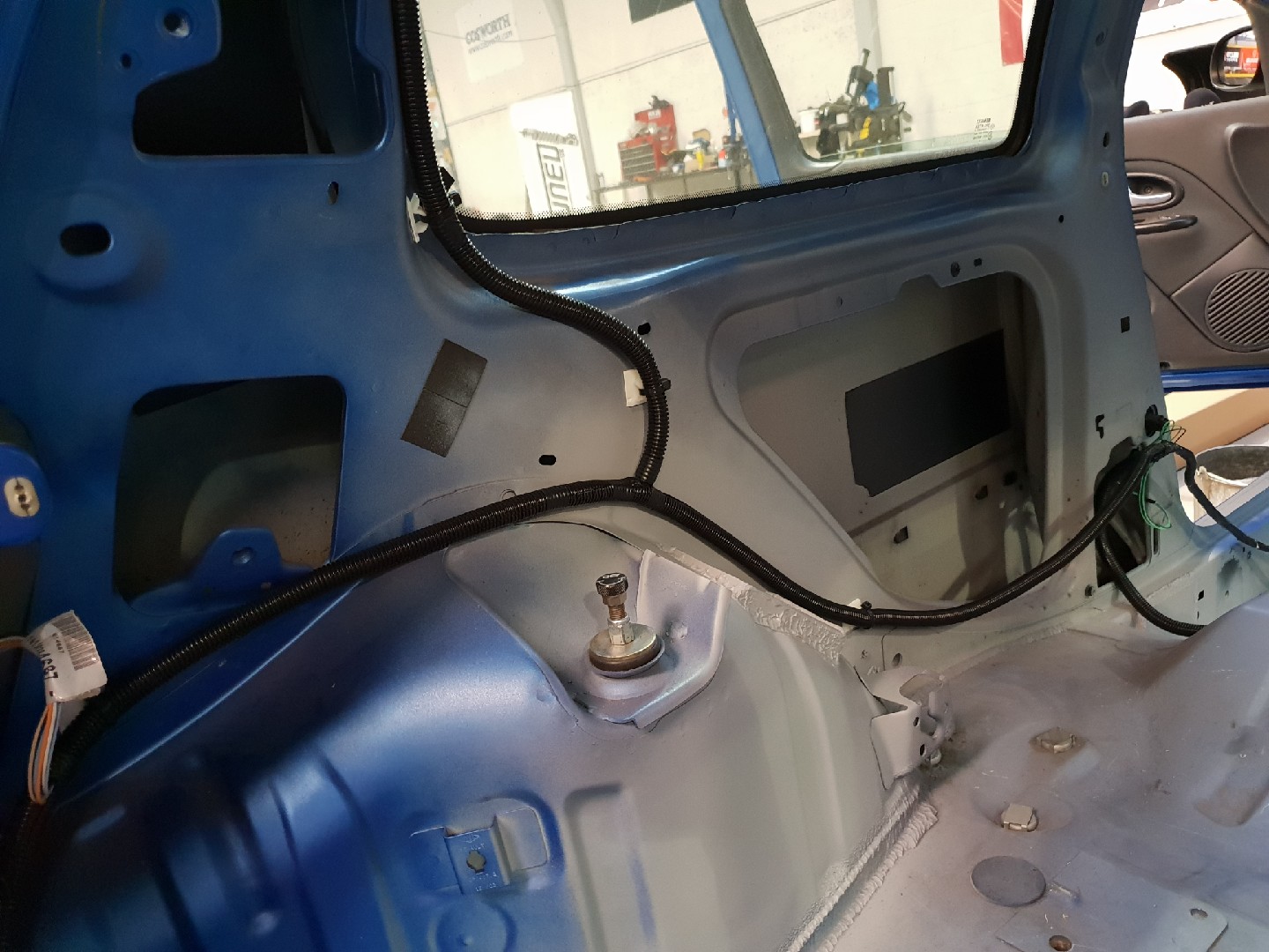

Cables have all been contained and redundant wiring removed on both sides
Now in progress:
New PMS shifter being installed
Interior being painted
Roof lining removed
Cage fitting
Door cards replaced @Track-car-doorcards
Battery relocated
Exterior decals
Harness fitting
No doubt more planned but it’s coming together!!

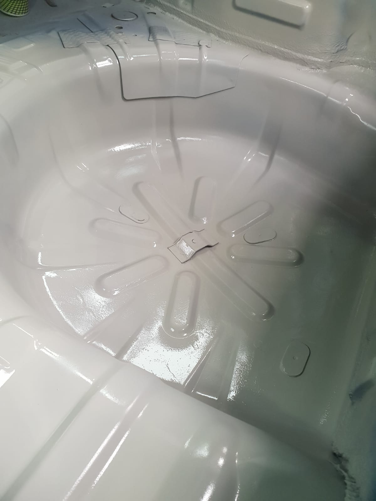

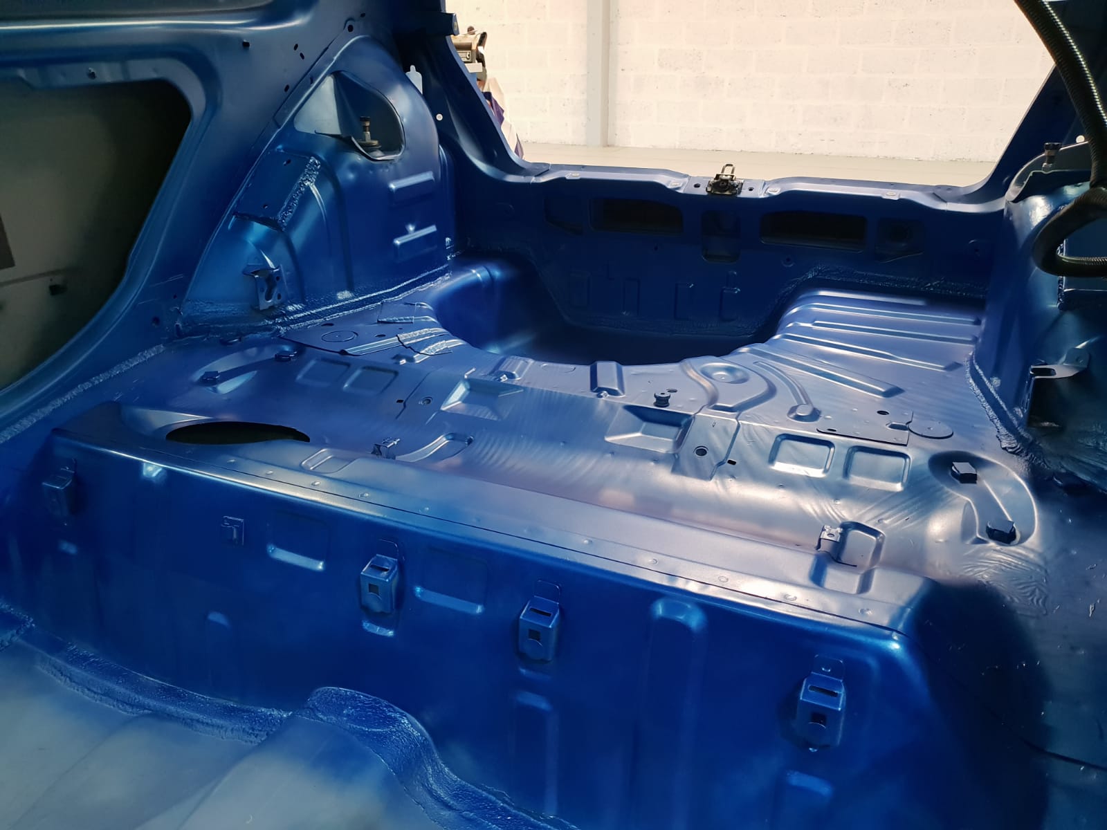

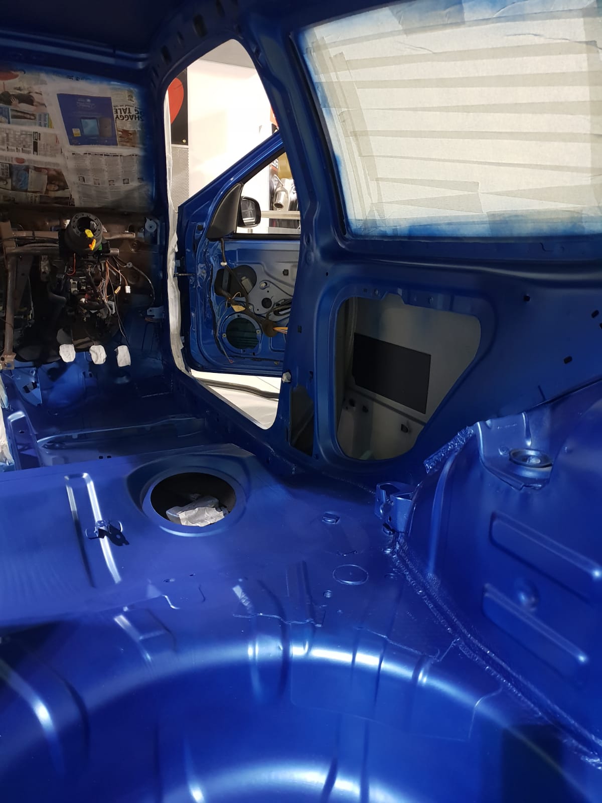

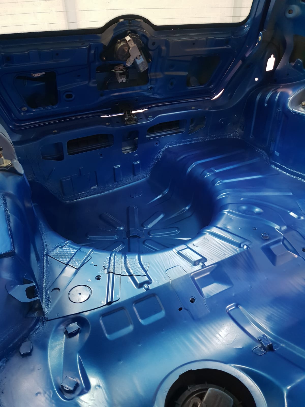

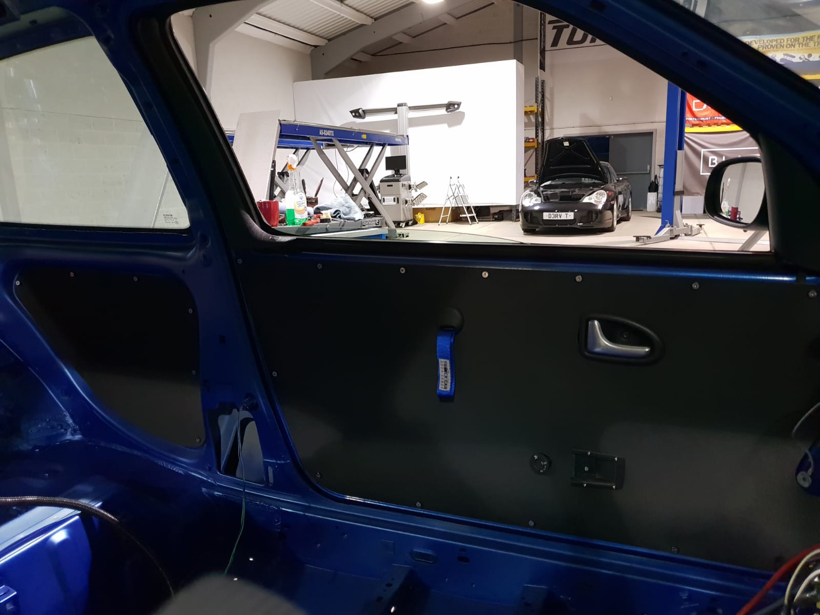

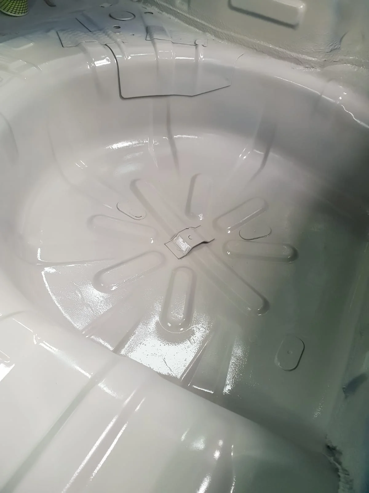

Things have been progressing with the car, and after the cage was test fitted, it’s now been stripped fully and painted inside
Before:
After: (primed)
Checking the cage colour suits the cup blue:
Sprayed fully:

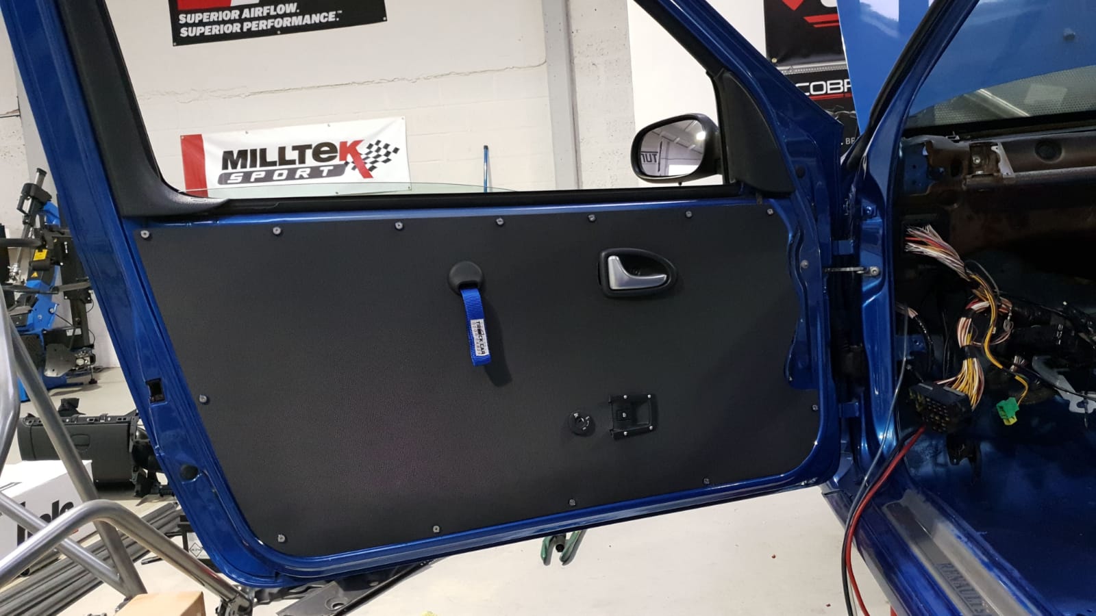

Door cards fitted: (@Track-car-doorcards )
Car is now starting to be pieced back together......... further updates next week

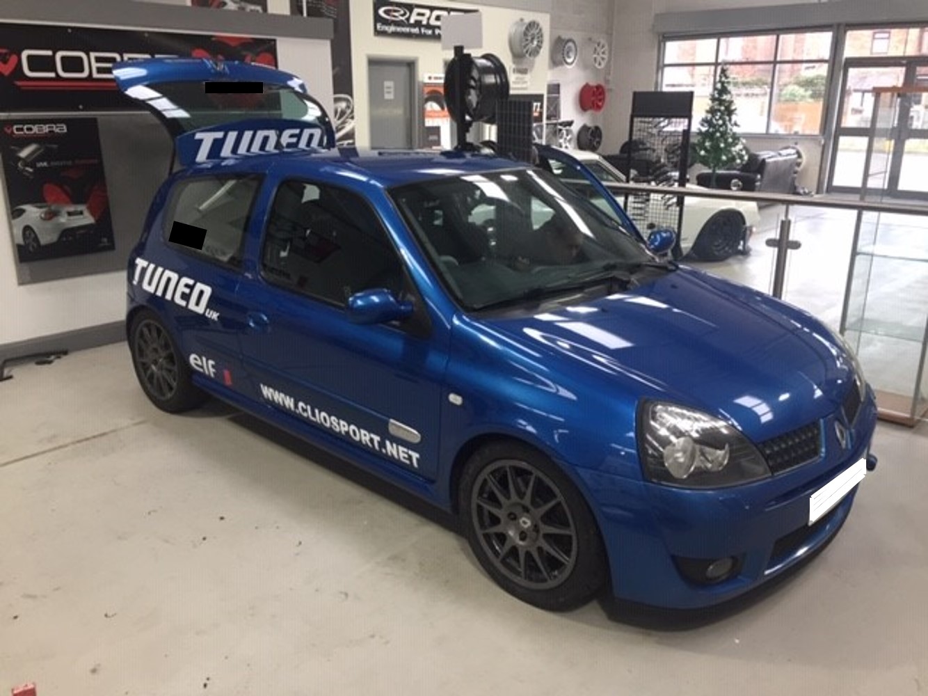

Further updates after a lot of time has been spent on it by Rich at TunedUK, along with some of his suppliers.
Not far off being ready for its first outing, however just waiting on delivery of a new passanger floor foor rest, fire extinguisher and the front bumper resprayed to finish off a top quality track toy!
Future plans will depend on how it runs on the first few outings, however its likely to be sent to @bloke for a turbo mid 2019.
Some pictures below, and I will update once again when its 100% complete for its first run at Oulton.

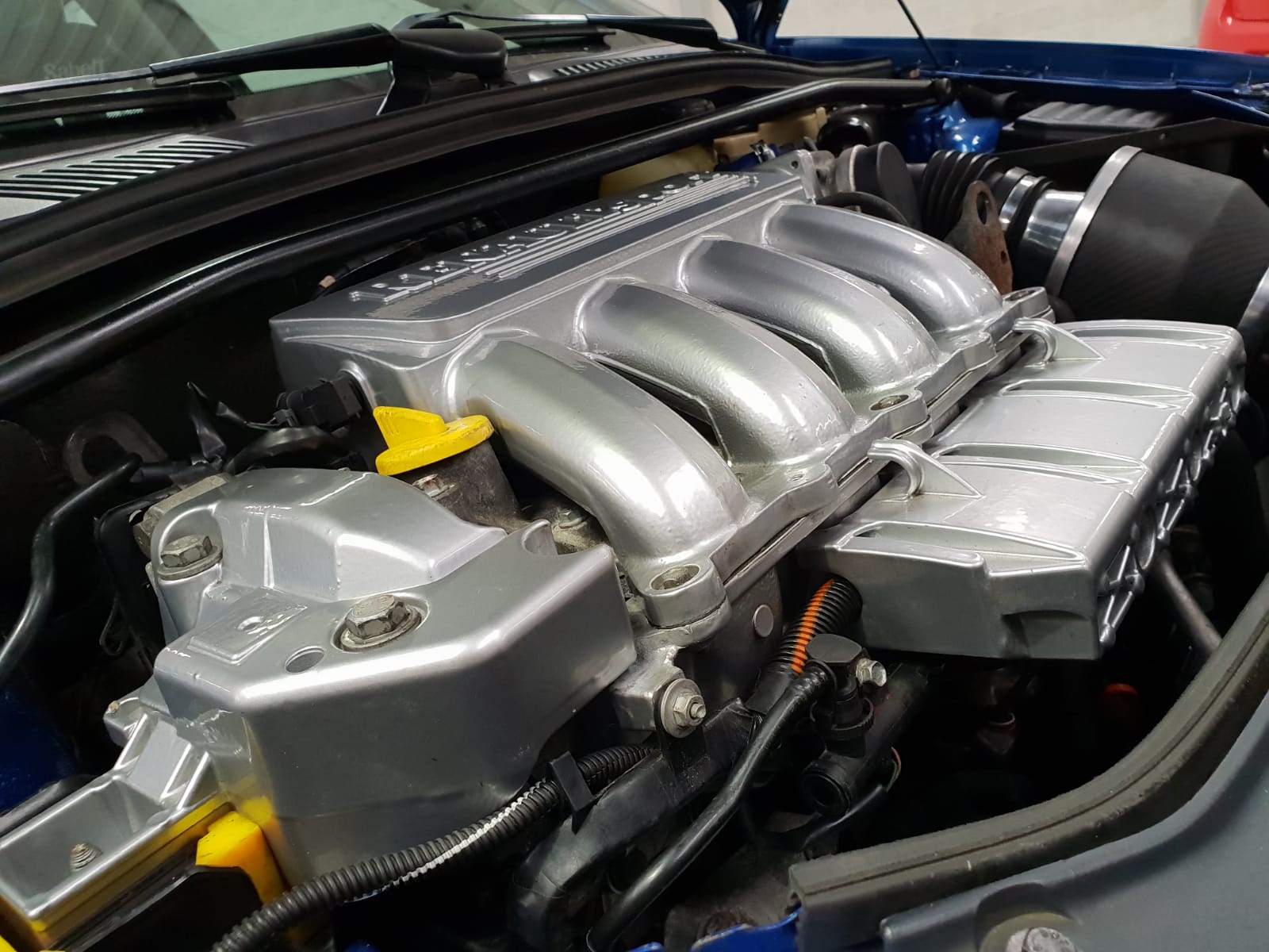

Inlets planned to be matched, polished and refurbished in gun metal to suit the rest of the car and then mapped locally.........

Picked up the car this weekend after Rich @TunedUK finalised the last few bits.
Car feels awesome, however suffering with the dreaded linkage resonation following the shifter install which will be sorted shortly.
Handling is on the money and hopefully should challenge a few in the bends at Oulton!

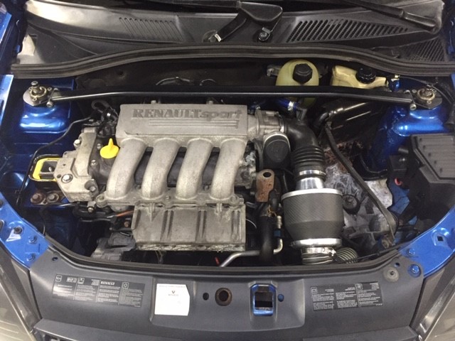

Jamesgsi1983
  N/A
Much better than the old ones and hopefully should improve power delivery based on them being matched.
Just need to spray the engine lifting bracket now as it’s letting the bay down!

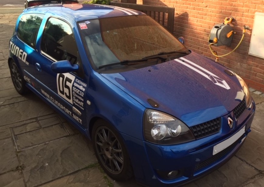

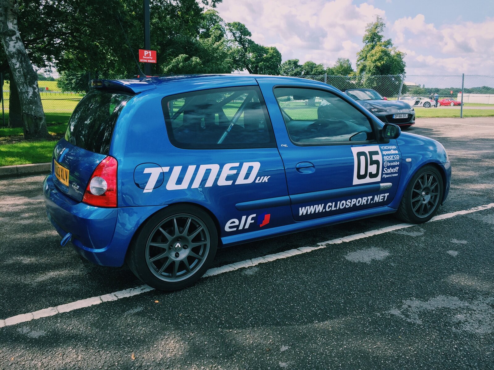

So the car went really well on its first outing, handling well on the BC's and the alignment completed by @TunedUK was spot on.
Few bits to tweak for the next one, and its off to @bloke for a small issue and a remap he's sorting with Chris at EFI.
Think it will be another day of setting up while N/A, then I think its time to boost........

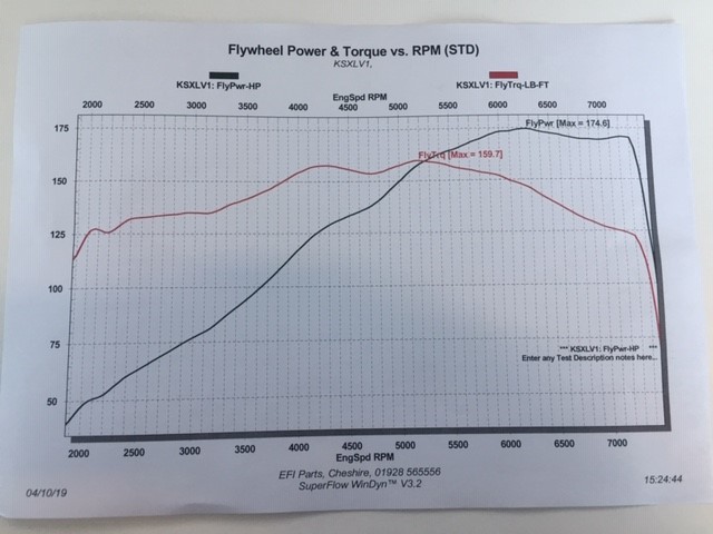

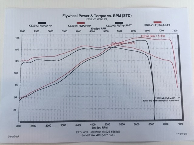

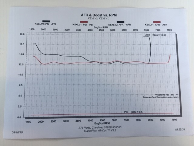

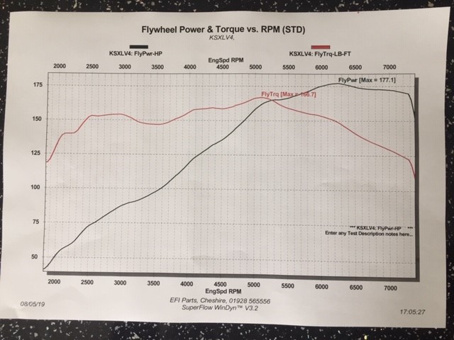

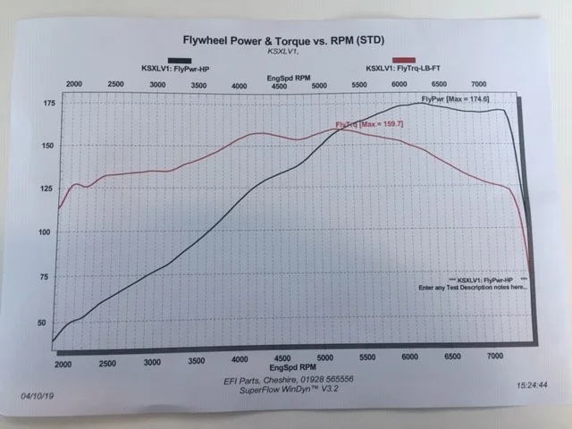

After a few tweaks following its last outing, the Clio has been in for a map with EFI thanks to @bloke
Appreciate the figures are held back on the 172 manifold and cat, however little benefit upgrading to the 182 system based on it having a Turbo planned soon.
Not bad figures based on the setup, and feels a lot better mid-range.
1414344
1414345
1414346

Been to EFI for a remap post all works and just awaiting the print off, however believe its made 178bhp, and another 15lb or torque.
(Will post the map results shortly)
