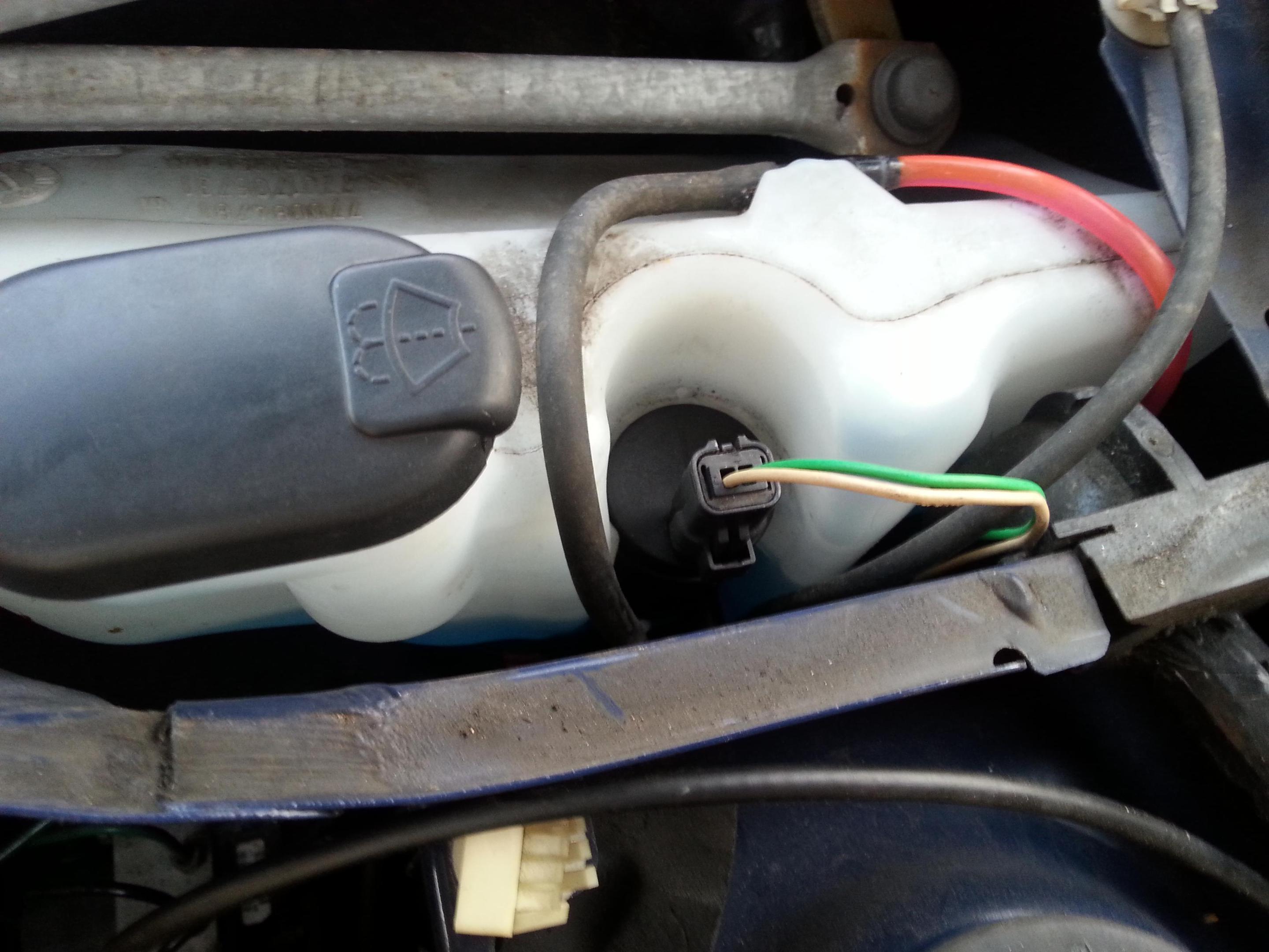

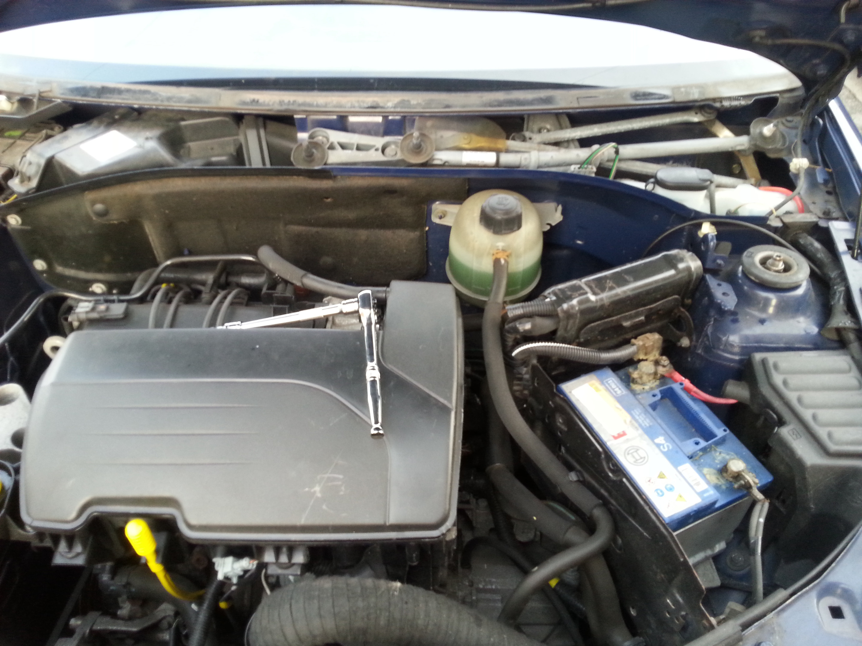

The pumps under the passenger scuttle panel. Wipers off, scuttle off, unbolt the bottle and you can get to the pump.
You can see it on the right here:
And here's the pump:
I couldn't get the bottle out completely because of the wiper linkages, but it was out enough to change the pump. Just watch as the bottle emptys itself when you take the pump out so make sure your quick! ;)
Hope that helps dude
