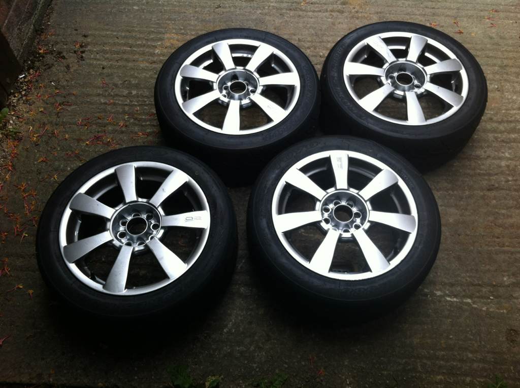

I've got some toyo r888 in 195/45/16 mounted on some oz wheels ready to go. In Clio fitment they have only done 2 track days £400 collected. Pm for details
Is that wheels included or just tyres? what OZ wheels are they?
colesy
  172 182 197 E61 530D
Both wheels and tyres, I don't no what model wheels they are just no they are made by oz.
