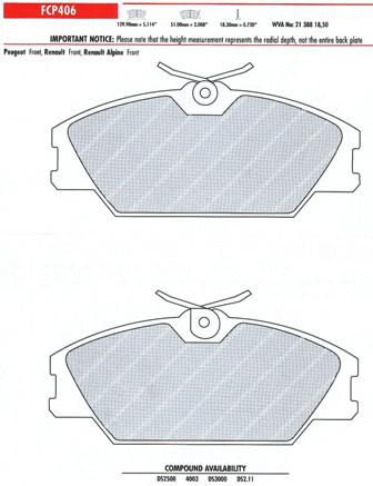

Yep thats correct, the Ferrodo pads are no where near identical to the ones that came out of my calipers (the brembo's are).
See for yourself.
  MX5 NC 2.0 Sport
The pads i just matched to the dimensions. Will confirm on Monday when im in work.
Ok :) That must have been allot of work to figure that out :eek:
Its already hard to figure out wich fits when you use the brand/model of a car due to the different engines etc.
But searching through the thousands of pads by comparing the dimensions .... devotion :clap:
