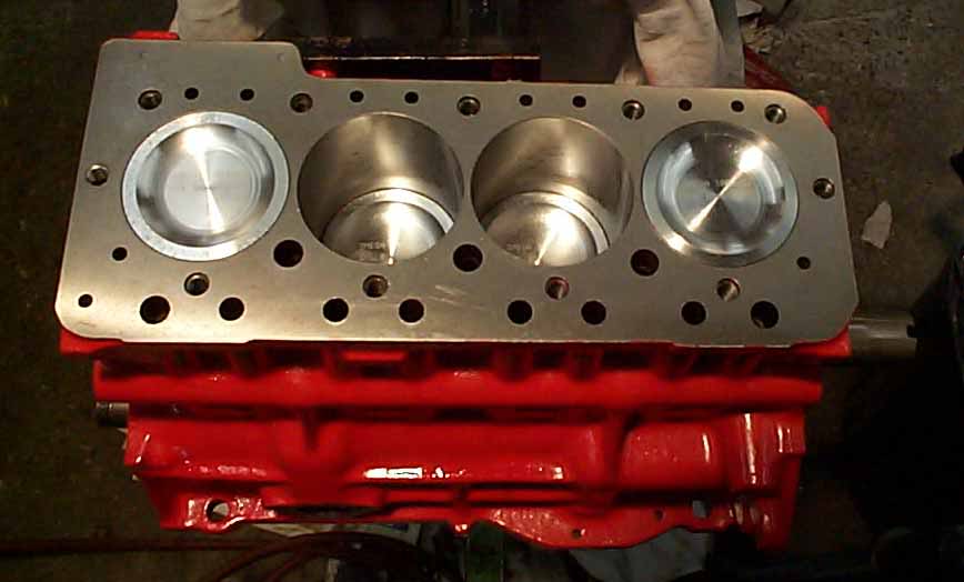

1340cc is a common misconception, all the ones labelled as such are always 1330cc, you would need 67thou overbore pistons for 1340 and no such thing is available.
  182/RS2/ Turbo/Mk1

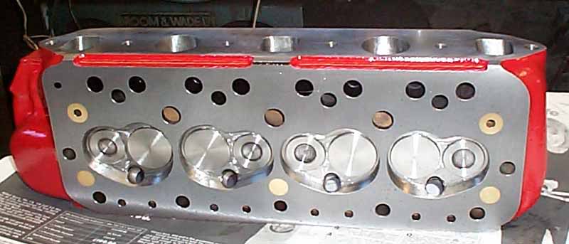

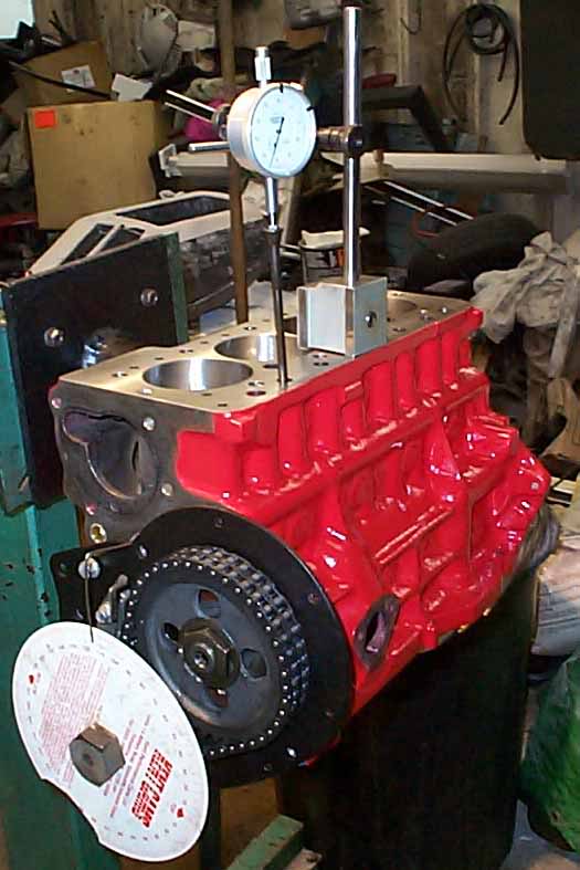

If you do keep the mini, its a great engine to work on, I used to love building A Series engines.
Here's one I built about 15 years ago

Indeed, some venders list it as 1340 as in certain motorsport classes 1340cc is the limit so they are selling the biggest engine they can for that class, but its not actully 1340cc
1380cc is the best option if its a road car IMHO, but as per the pictures Ive just posted, you need to offset bore the block (move the centre points of the bores) to get it to that size without making the wall thickness between the bores too narrow.

TBH for 100bhp or so the mini head works very well if ported correctly, and going much more than that on a long distance road going mini is likely to lead to reliability issues with the gearbox or drop gears, and straight cut ones sound horrific.
For a sprint or hillclimb car etc though, getting a 16v head onto it and a set of throttle bodies is a great idea.
