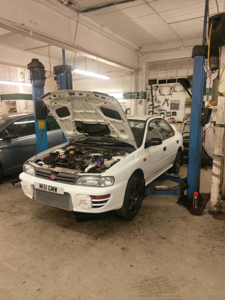

RMDavis
She's finally in the workshop!
Engine is coming out tomorrow! [emoji1]

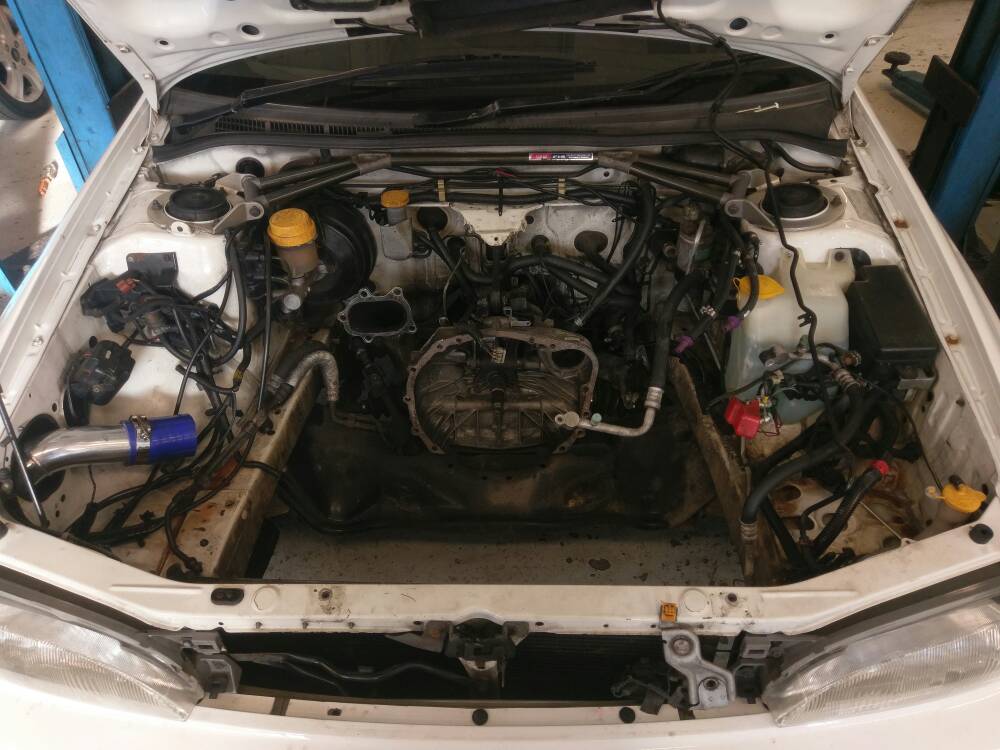

RMDavis
She's alive!
Ahh crap...
As I've already mentioned I'm awful at taking photos, as I'm the sort of person that just gets on with it.
However as things currently stand the engine is out (obviously) and stripped down to the block. With no huge issues found both the cylinder heads were sent off for testing/skimming yesterday.
They both were in very good order with minimal wear to the camshafts. The block also appears to be in good shape, with hardly any scoring to the bores which was a relief!
One of the engine mounts had completely fallen apart, so I've decided to replace them with a pair of 'STI Group N' uprated mounts.
There's also a few extra gaskets and seals that are needed, and have also been ordered as required.
I also found out that the 'STI' radiator cap the previous owner had fitted was in poor condition, and more importantly fake! [emoji23] turns out there's quite a few fake ones for sale on eBay... Genuine cap now in my possession!
Whilst the engine is out I have made a start on cleaning the impossible to reach places, and removed all the air-con pipework including the condenser.
Both the chassis legs are immaculate, but there's some surface corrosion on the battery tray so I'm going to rectify that before everything goes back in!
I'll keep you posted chaps.
I can't wait to hear the flat four again! [emoji2]

That engine bay is remarkably free of tin-worm for a 22-year-old Jap car! :up:
Thank you bud!
I was really pleased when there was no hidden horrors!
The legs are little grubby, but should clean up. Like I said the worst bit is the battery tray, but it's only surface corrosion.
Just need to stop it going any further!
The underneath of the entire car is very clean also with just surface corrosion to the suspension components.
