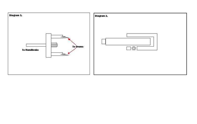

right an update,
Last weekend i adjusted the drums up and the handbrake was still a bit high.. so i got back from base last night and had a look at it.. ive whipped the drums back off and they are adjusted up fine... although i notice the handbrake lever thats attached to the shoes doesnt return to its original place...
so i tried to slacken off the handbrake and the the nut at the top just seems to keep on spinning.. any help...
ohh yeah if you look at diagram 1, you can see the single cable from the handbrake lever to the splitter under the heatshield.. ive check that this isnt spinning when i tighten the nut attached to the lever ... i havent a clue why.. but i really need to undo this to adjust up the rears correctly...
any help or advice please...

adjuster nut could have stripped its threads - have you tried winding it off and putting a few washers on the end of the cable then a new nut
