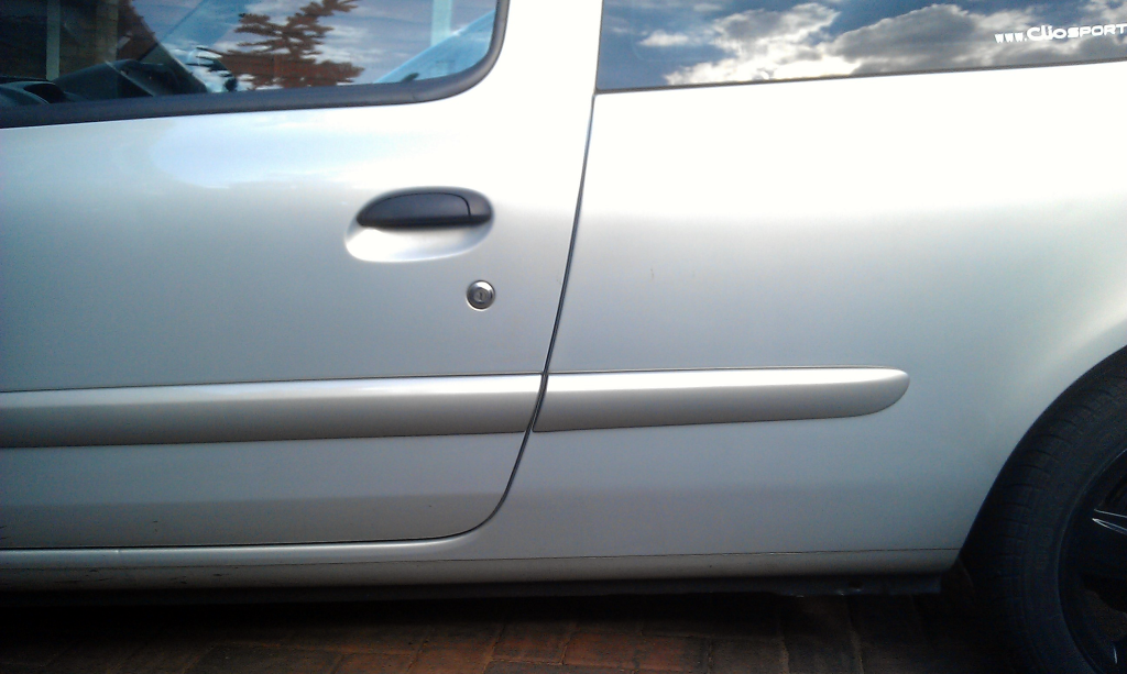

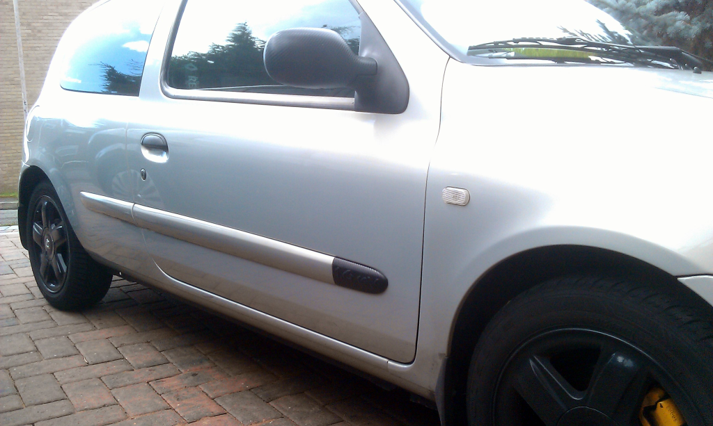

    I colour coded my sidestrips the other week and have the same colour. Like what's already been said, it looks perfect in some lights but others it just looks plain silver instead of the bluey-silver it should be. I guess its just a hard colour to match :worried:
    [​IMG]
    [​IMG]
    Notice on this last picture how it matches perfect on the left hand side but on the right it seems to shine a true silver. I just don't understand :confused: :banghead:
