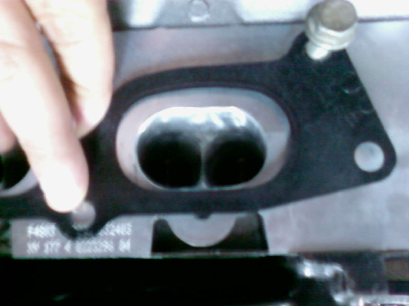

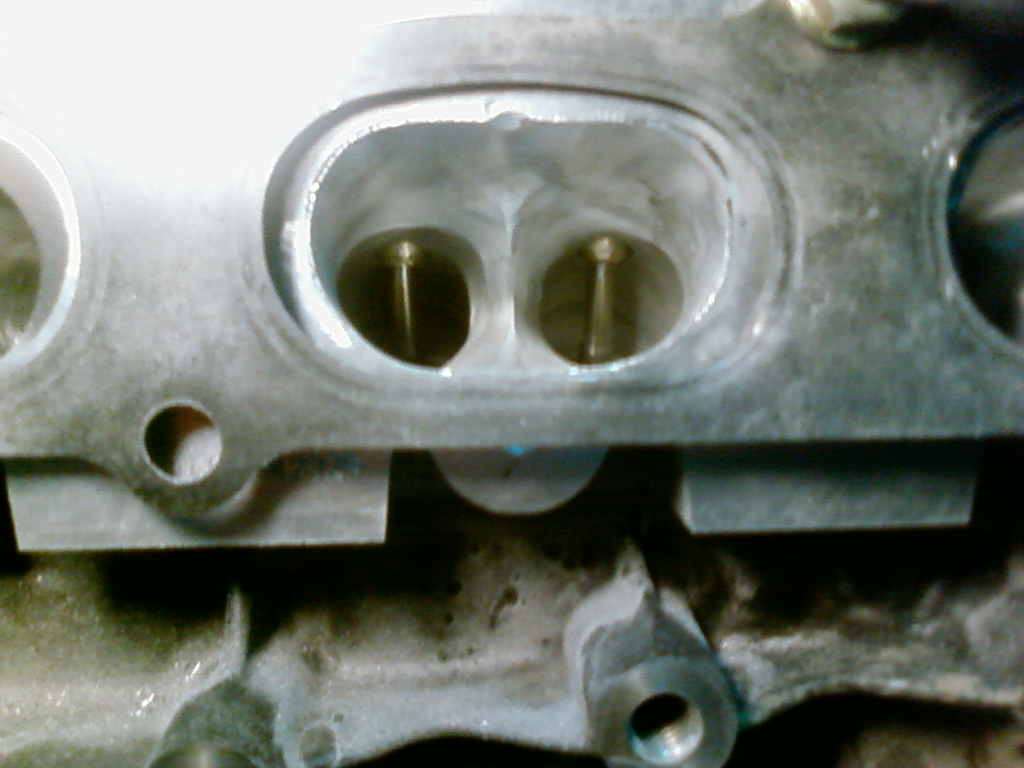

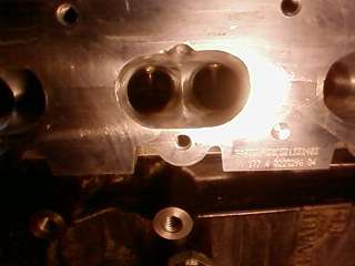

    197 inlet don't need of matching between upper and low section.
    But 'cause you say about 197 inlet, i've managed to install 197 inlet to 182 engine.
    Huge diffrence between lower inlet to cylinder head.
    Here are some images
    182 head and 197 gasket
    [​IMG]
    new holes must be drilled left and right of the inlet on 197 gasket
    [​IMG]
    working to...
    [​IMG]
    allmost ready. Little notch at the upper middle of inlet is made to clear the way of injector spray. (new position of injectors)
    [​IMG]

    is that a 182 cylinder head mate? those portings are shocking if so :confused:

    You filling them out with the valves still in? is the head still assembled while you are filing s**t away?

    surely getting the head CNC'd would be better mate. Full rebuild etc. You don't really want to get swarf in the seals etc.

    Ha... I was affraid of that but nothing happen at the end...:tongueclosed:
    Now runing 7k and pull's F*** great.
    Anyway now you know the big diff between 197 and 182 head after camshafts :cool:

    I know that Fred. If you find any pic of 197's gasket you 'll find that it's same as mine...
    Andy and Danny,
    How i made it? I took a cork gasket(may not the correct word but i think you know what i mean) and matched with inlet ports of 197 low end inlet as a guide. Then put it on 182 head marked and on, and on you know...
    I took pictures with the 197 gassket, same as fred posted, just to show the diffrence between 182 and 197 ports.
    Yes they are lot larger but it not me....It the F*** inlet

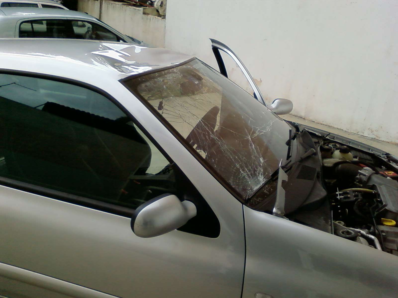

    Anyway i was at road today just to youtube my car to show you how it pulls (cause if i tell you that this combo as you said) makes 203 hp on a MAHA dynometer, you would 't belive me...
    As a conclusion of today ride was this
    [​IMG]
    [​IMG]
    Bonnet was off, doing 180Km/h....:weary:
    s**t happens...
    Oh God....i'am unhappy today.

    bonnet catch gave way? Nasty :worried:
