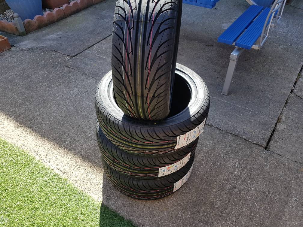

    So far I've got a PMS Shifter, turinis with Nankang ns1s(cheap and potentially cheerful) Mintex M1144 pads with Brembo hc disks, stud conversion.
    I've also just ordered some cooksport springs for now and have a brand new Whiteline rear arb that is currently on the marketplace (not really sure it's much use to me)

    By all accounts those tyre are w**k

    I thought it might have been the case, worst case I use them for autosolos. Wanted some AD08R but the guy who gets them is busy.

    the tyres aren't that bad to be fair.
    my lad just got a set of ad08r from ben patey on facebook.

    The ado8 although dear are polar opposites of those tyres.

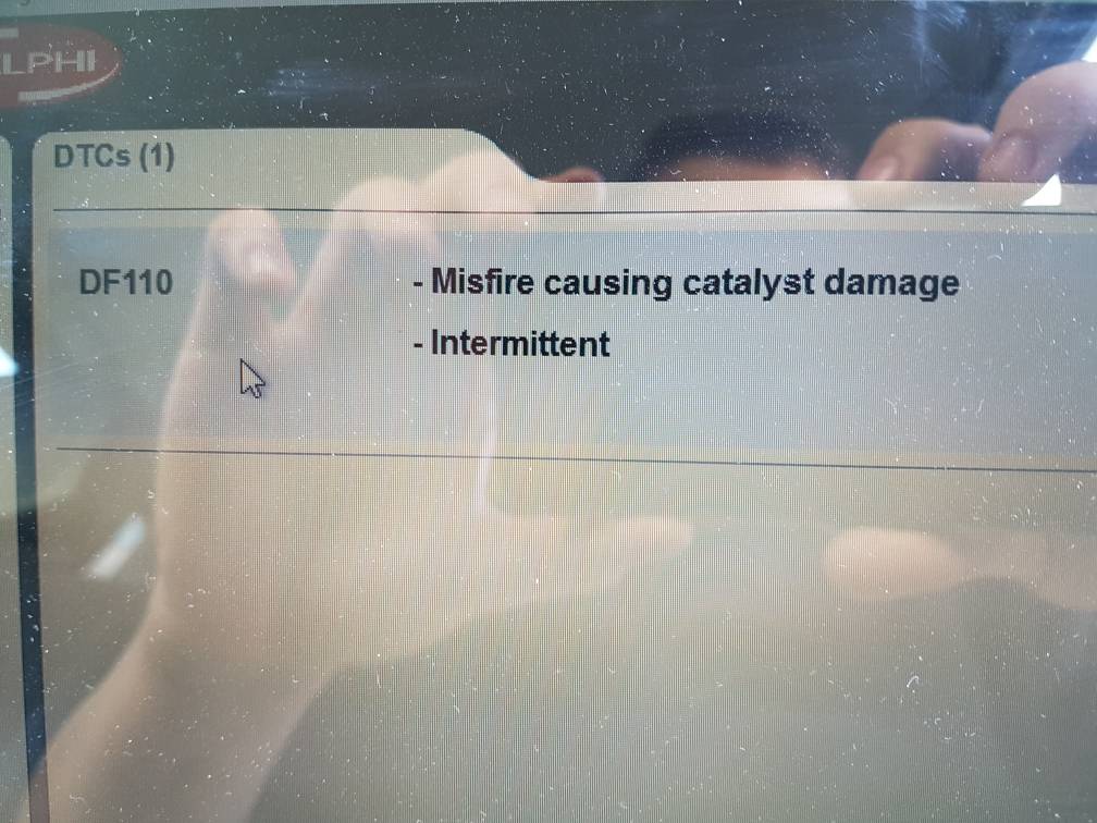

    Also! Yet another also I've developed a misfire... [​IMG][​IMG][​IMG]

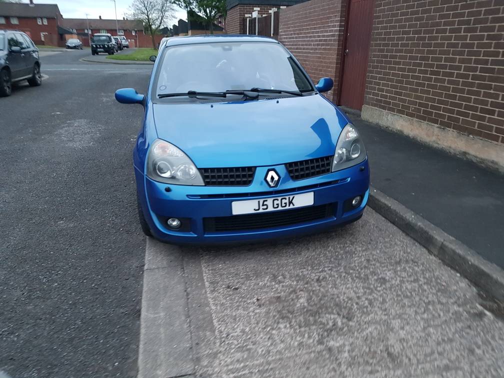

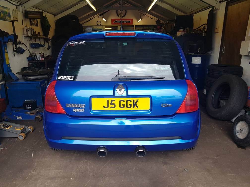

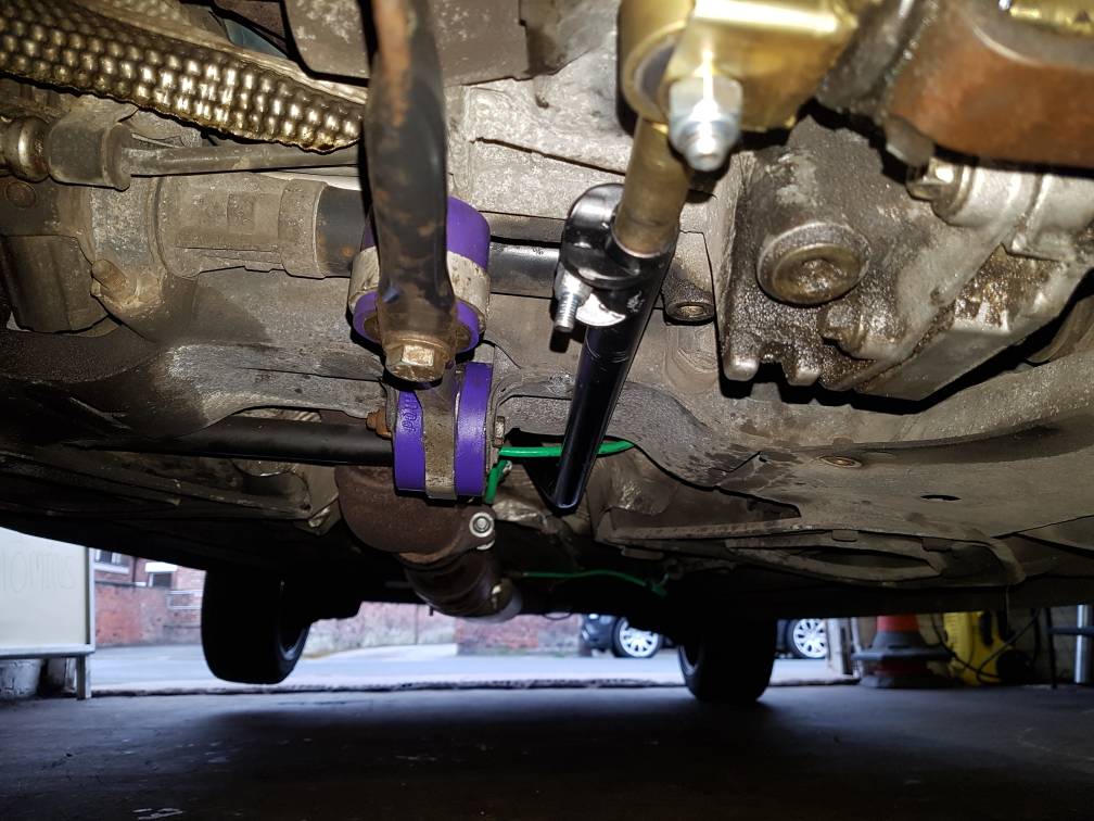

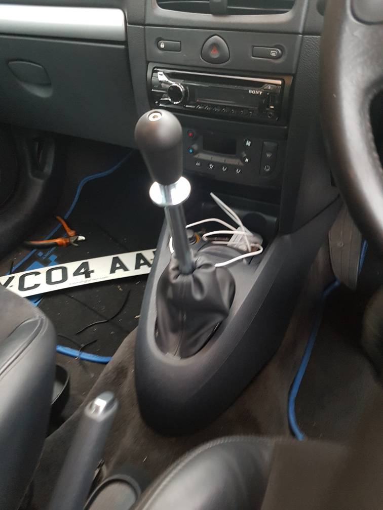

    Today saw a few upgrades before it goes to get the oil leak and belts changed.
    New Private plate on. PMS Shifter kit on with a polybush dogbone mount. 4 hours of much swearing it was ready to go.
    Tomorrow it's a good clean and refurbishing the headlights. [​IMG][​IMG][​IMG]

    my mates got some ns1's on his Ibiza cupra. Says there ok, good in the dry. Average in the wet. Done a few track days too.

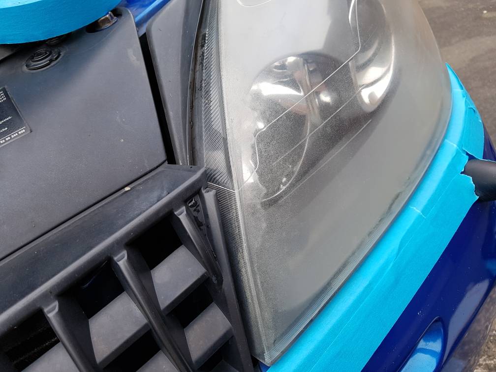

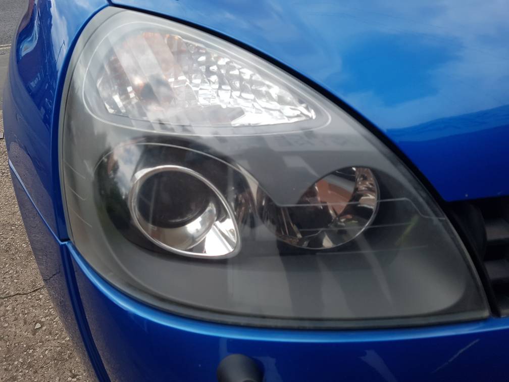

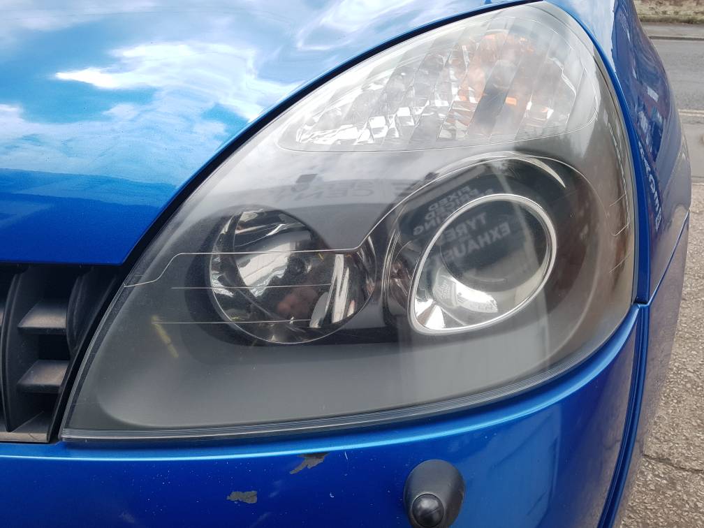

    So the headlight restoration is done, Not too happy with the offside one so might have to go over it again. When I took the tape off the nearside it pulled some paint . Knew it was badly painted so it's my own fault.
    Gave it a clean and decided I should put my cooksport springs on.
    All ready for the oil leak to be sorted on Tuesday [​IMG][​IMG][​IMG][​IMG][​IMG]

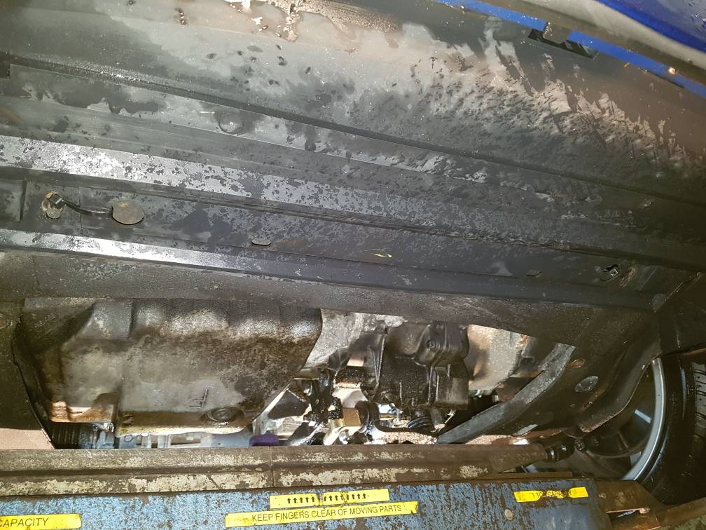

    So the oil leak has been fixed, it was the Camshaft seals. I had a new set of belts and pulleys (not dephaser as it was new last year)
    I've just removed the scorpion exhaust and fitted a ktec resonated system.

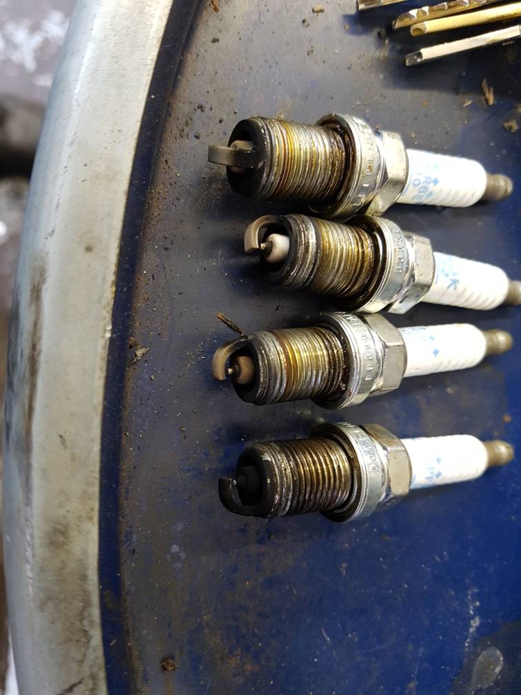

    I'm not chasing this illusive misfire. I've ordered an injector to swap around to see if I can make it better.

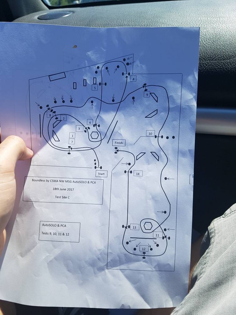

    It took part of its first event this weekend with Preston Motorsport clubs autosolo. It went well until the last lap when I nailed 2 cones and lost 4 places on the leaderboard.

    Good project. Misfire will most likely be a squiffy injector, they caused havoc on my 182.

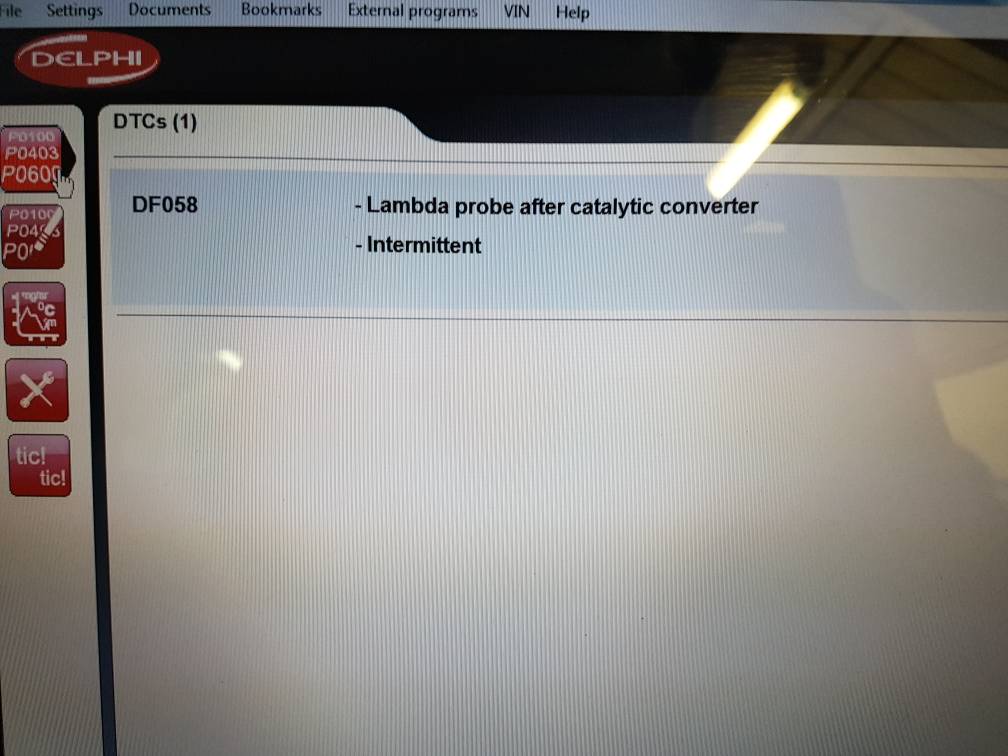

    So 5 days after sorting my misfire with the Injector I appear to have another misfire...
    It appears to have an intermittent 2nd lambda fault. I'm not convinced it's that causing it. Its very occasional and no where near as bad as the Injector issue.
    I tried to fit the dampener kit for my PMS Shifter but it was catching no matter what. At closer inspection it's also knocking the turret when going into reverse. I'm going to re adjust it one day to sort it out.
    I seem to have developed quite a bad knock on the nearside front in very few miles... will inspect tomorrow.
    Problem free motoring [​IMG][​IMG]
    Sent from my SM-G935F using Tapatalk
  20. Louis'
    Louis' ClioSport Club Member
    Joined:
    Apr 4, 2015
    Messages:
    2,058
    Location:
    York/Huddersfield
    Car:
    BG 182
    Unless i'm mistaken a post cat lambda would have no effect at all on your car and would only bring on your EML. The issue is elsewhere if still misfiring.

    Aye, that was my thought. It's only a very minor misfire. I'll see if it gets ant worse.

    These tyres are really good on track, not as good as federal 595rs though.
    They are very noisey sounded like a wheel bearing gone on my EVO X.
    They may take longer to get heat into as the Clio is so much lighter.
    As a trackday tyre they are good as an everyday tyre they are very compromised.

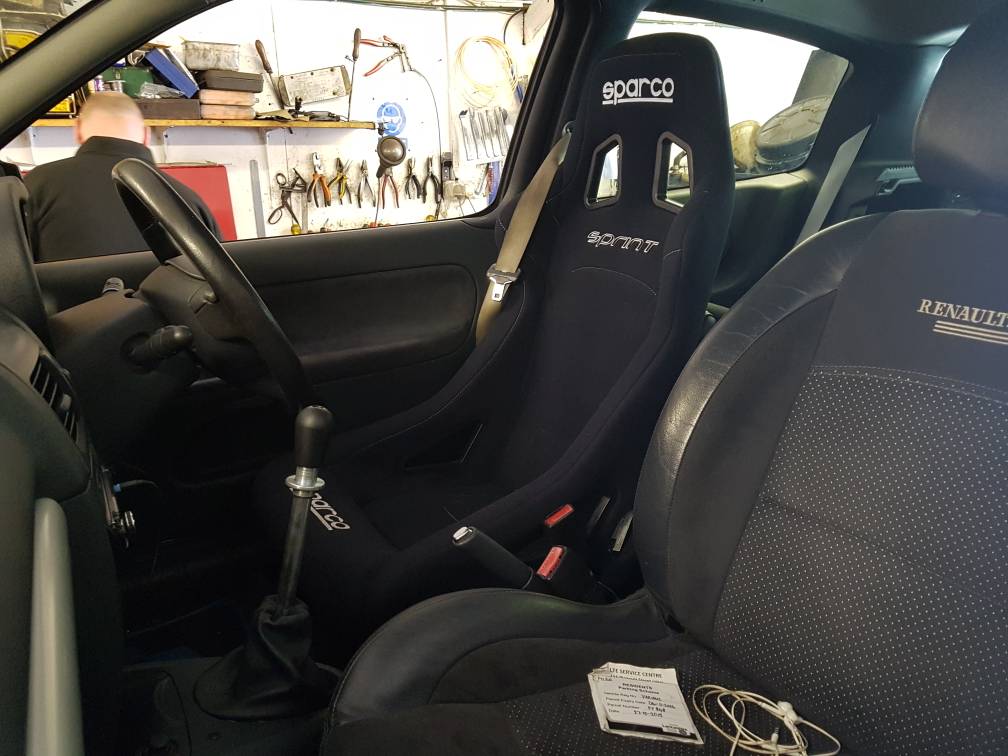

    Picking up a Sparco Sprint bucket seat up tomorrow while in Leeds.

    Picked this up from Leeds earlier [​IMG]

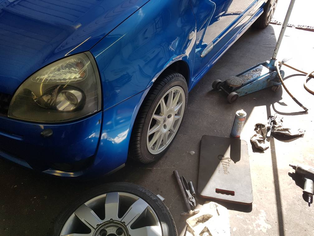

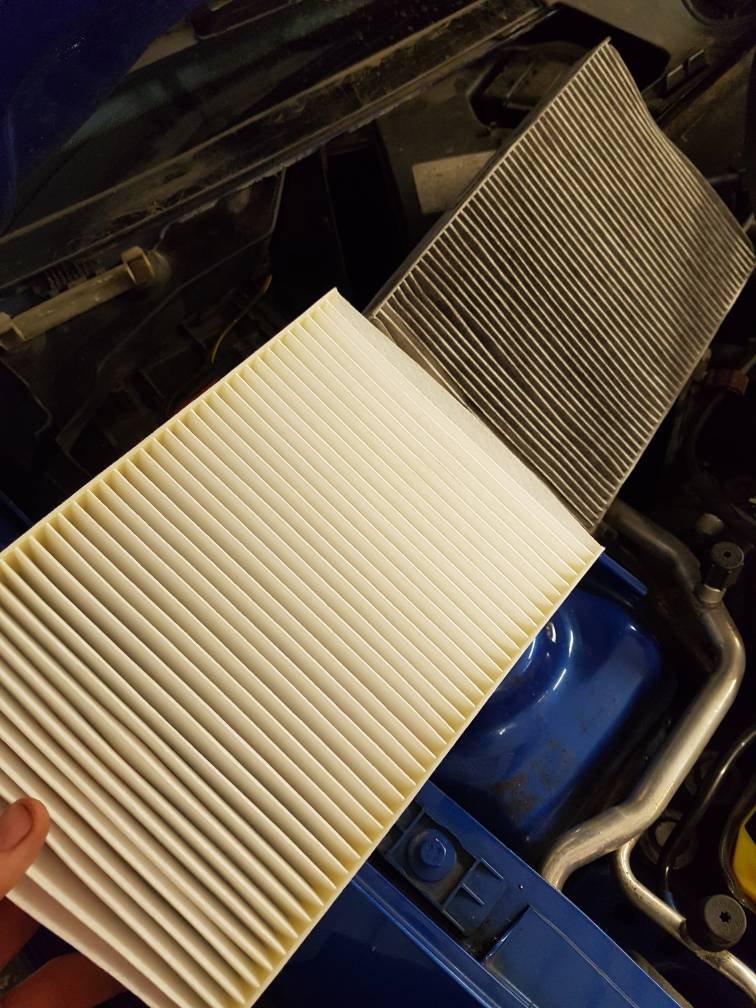

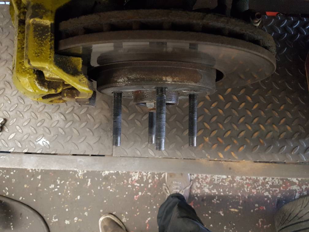

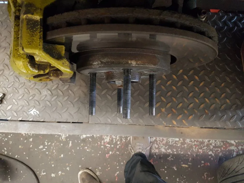

    Dead day at work so I decided to do a couple of boring bits and bobs on the Clio.
    New pollen filter fitted.
    I decided the studs are far far too long but I don't have another option at the moment.

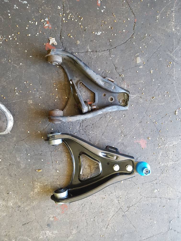

    Replaced the nearside front wishbone because the ball joint was buggered.

    Love those PMS shifters. They need to make a Mk3 one!

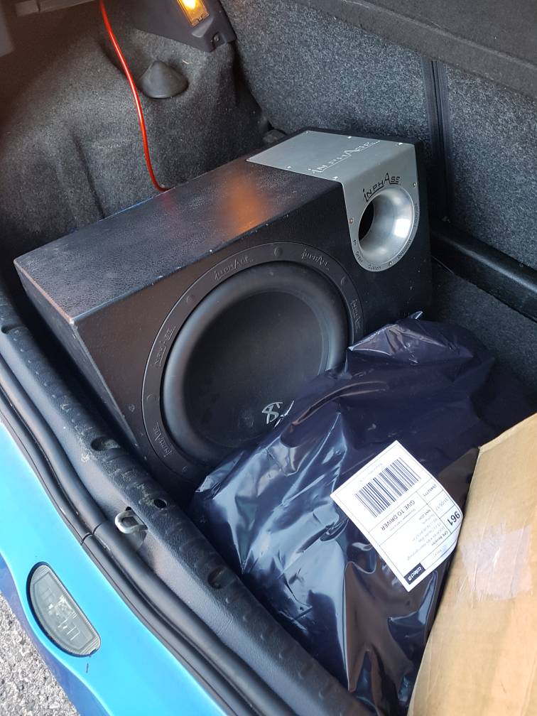

    Decided to become a bit of a yobbo, fitted this sub and built in amp I picked up off of a mate for £20. Sick of the crap sound system, the 3mps has a full bose set up so I'm a bit spoilt. Took about 2 hours 30 to set it up roughly. Need a tiny bit of cable management and to mount it tomorrow.
    I'm going to use some inch brackets to bolt it to the floor and seal over the bolts.

  40. Joe Smart
    Joe Smart ClioSport Club Member
    Joined:
    Jun 22, 2016
    Messages:
    228
    Location:
    Preston, Lancashire
    Car:
    Clio RS 172
    It's exactly that, really good fun for 30 odd quid.
    You get a map like this and you walk it to learn it and go and have fun [​IMG]
