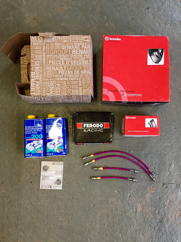

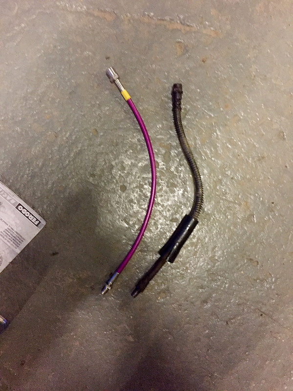

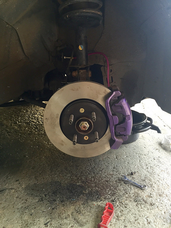

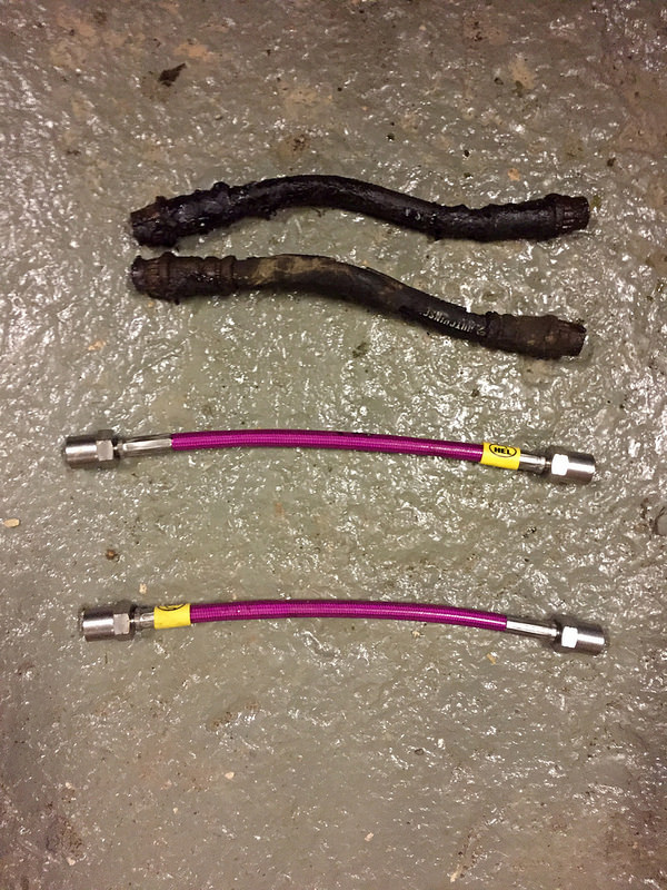

So quite a bit to update! First was my brake refresh/upgrade :
Untitled
by Jimbob_2705, on Flickr
Fedoro DS2500 Front Pads
Brembo Rear Pads
Brembo HC Front Discs
Genuine Renault Rear Discs (Didn't fit as old discs still have plenty of life left)
HEL Braided Brake Lines
ATE Type 200 Brake Fluid (Superblue)
Few pictures along the way :
Untitled
Untitled
Untitled

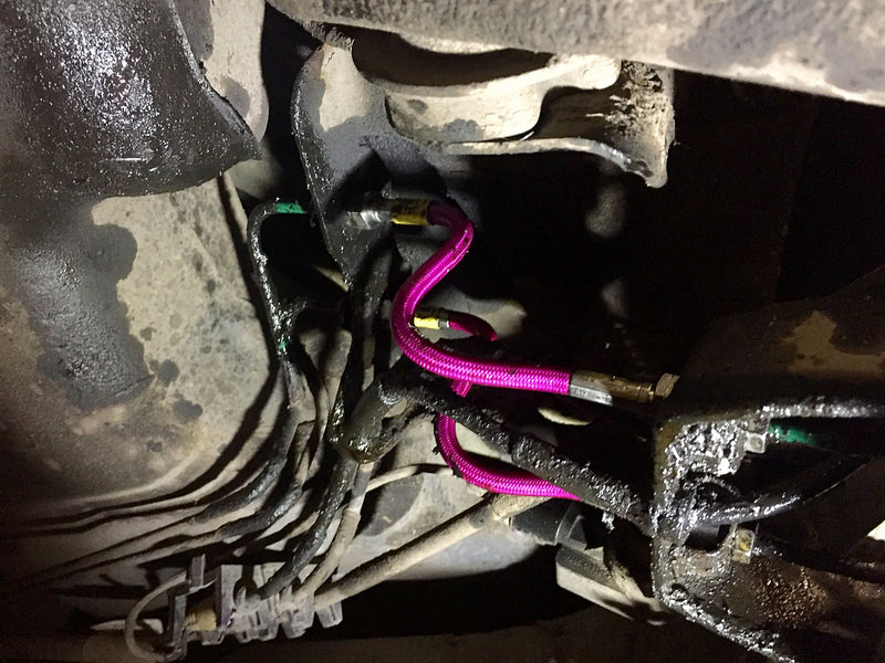

Old Brake Lines off and replaced with new HEL Braided Replacements

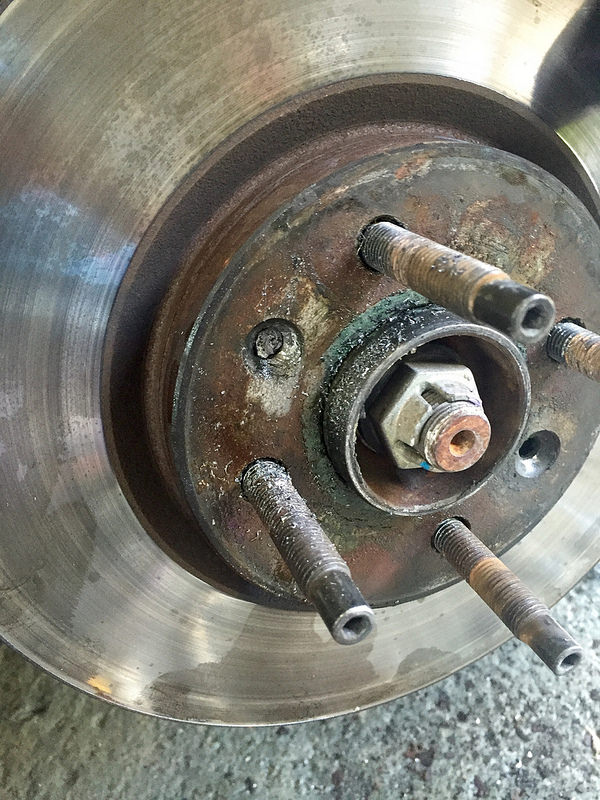

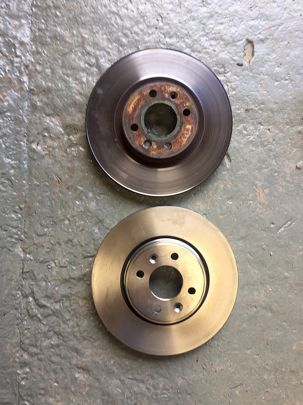

So onto the discs, all was going well until one of the disc bolts rounded off on me so that was drilled out
Untitled
New Vs. Old

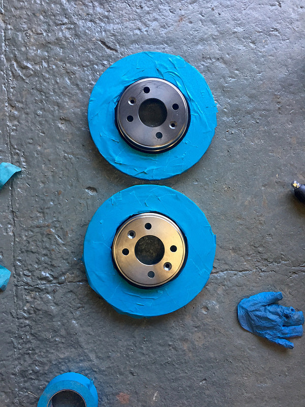

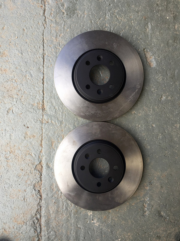

Thought I'd give this a try as I always hated the look of rusty brake discs
Untitled
Untitled
Worked an absolute treat! Used VHT Matt Black Paint, and it looks so much better - well worth spending the time doing!

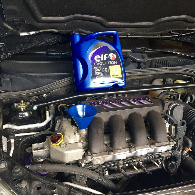

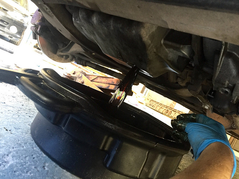

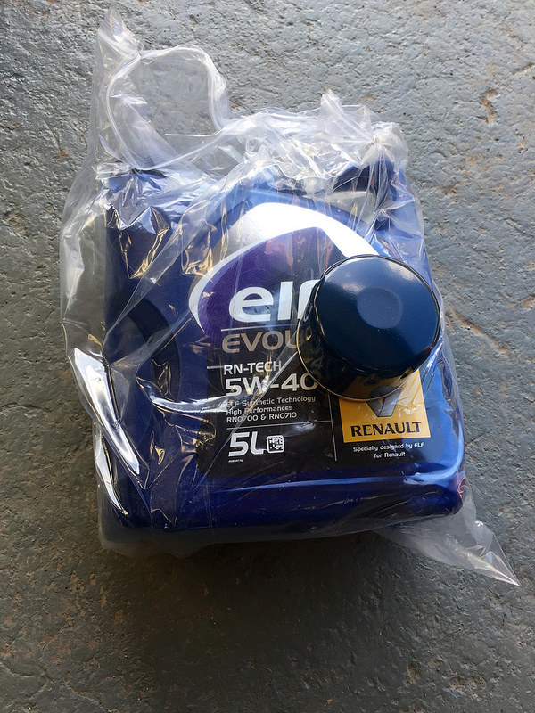

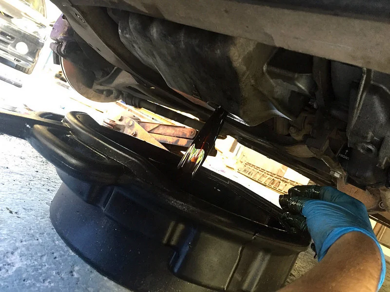

Also gave it a service with New Oil and Oil Filter, the third time in just over a year - I'm a strong believer in frequent services to help prolong the life of the engine and make sure it's running right
Untitled
Untitled
Admittedly the problem with doing it yourself is you'll never get a service stamp, but I keep all the invoices and hopefully this will provide proof of it being done!

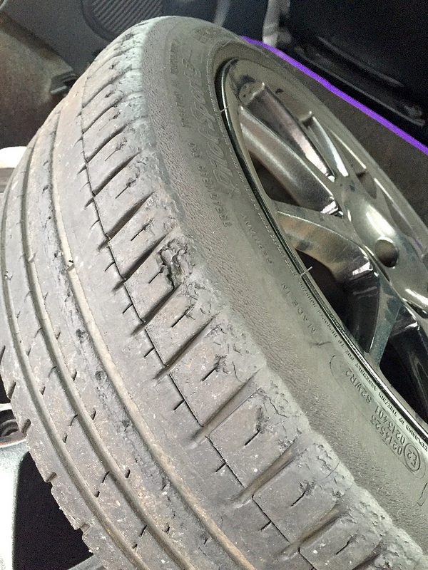

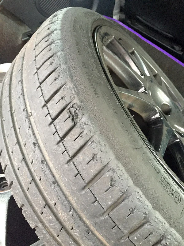

Only thing which let me down was the Tyres! I stuck to my normal road going PS3's and they soon started to deteriorate, but I did expect this as Llandow is renowned as a left tyre ruiner
Untitled
Not sure if it was a case of wrong tyre pressure, pushing it too much or just normal for the track but compared to Joe's and Josh's AD08R's the difference was huge, whereas I was struggling for traction around some of the corners and going half throttle, they were foot planted and flying around!
Didn't want to risk driving back on that so luckily I took my spare old 182 alloys to chuck on the front, giving a very odd look with mismatching wheels haha

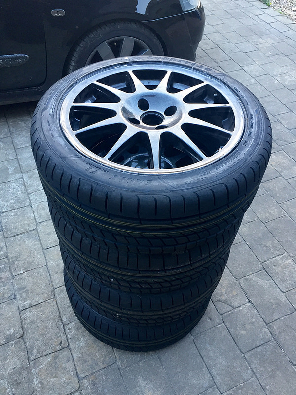

Really don't like the standard 182 alloys, just don't do it for me and you can see why Turinis are so popular!
So whilst all that was happening I got my Turinis fitted with brand new tyres all around, went for a change this time from PS3's - Goodyear Eagle F1 Asymmetric 2's in 205/45/16

Really interested to see what these are like, as I was a little disappointed how my PS3's lasted on the fronts last time (rears lasted very well though on the other hand), so will be a good comparison as people rate them highly, infact looking online they actually get better reviews than the Michelins...

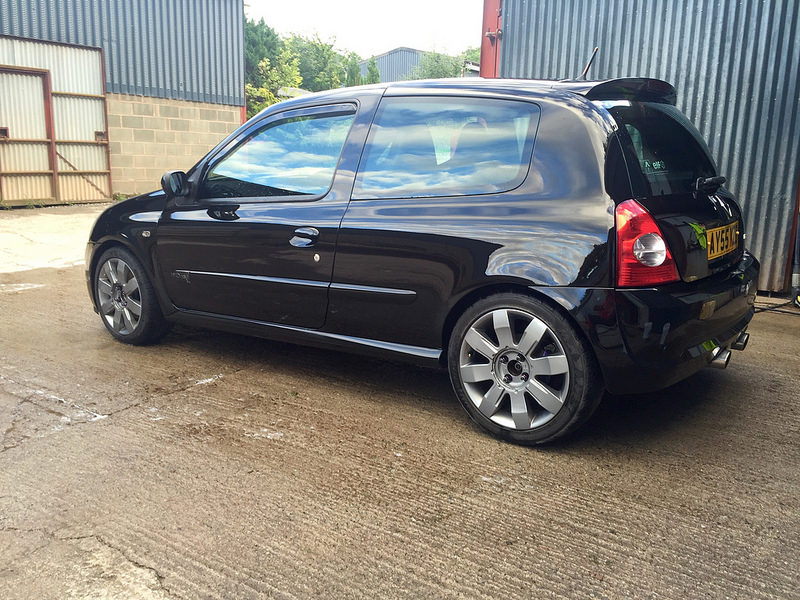

Finally a cool beading shot, looks like that Collinite wax is still doing its job!
Untitled by Jimbob_2705, on Flickr

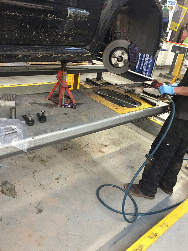

So anyway, more work done on the car - slowly getting around to fitting all my bits!
Mate helped out this time, which made life so much easier, especially as he's a bit of a whiz working on Clio's!
Untitled

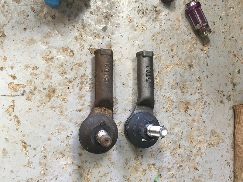

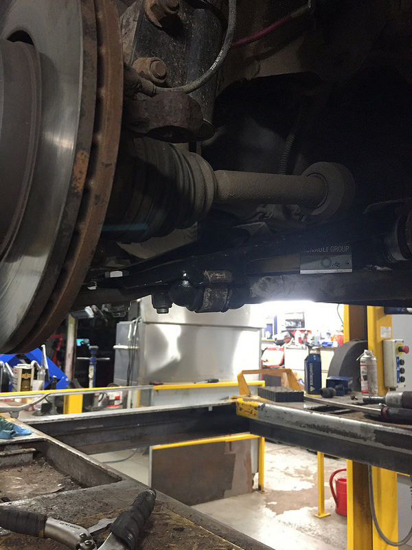

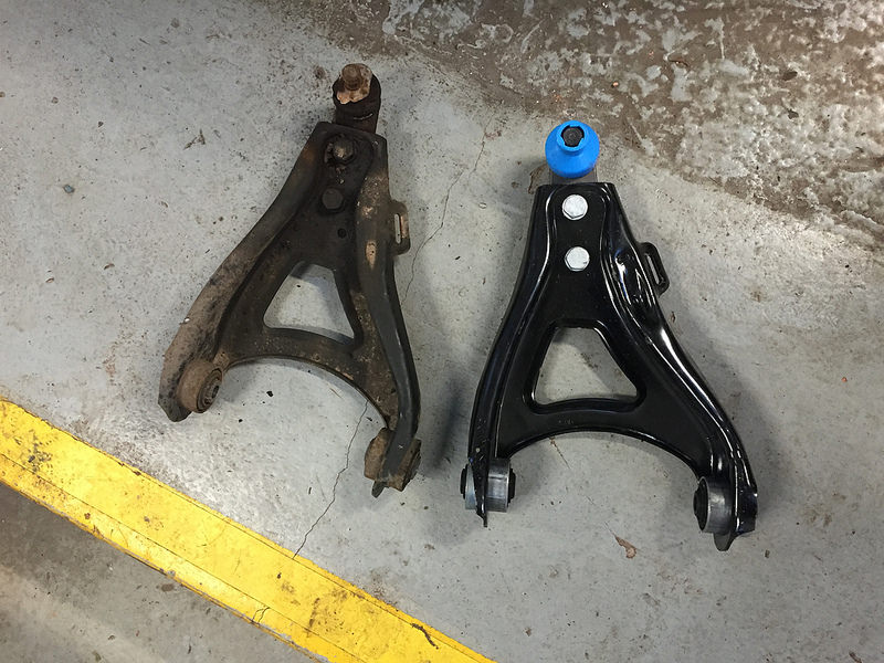

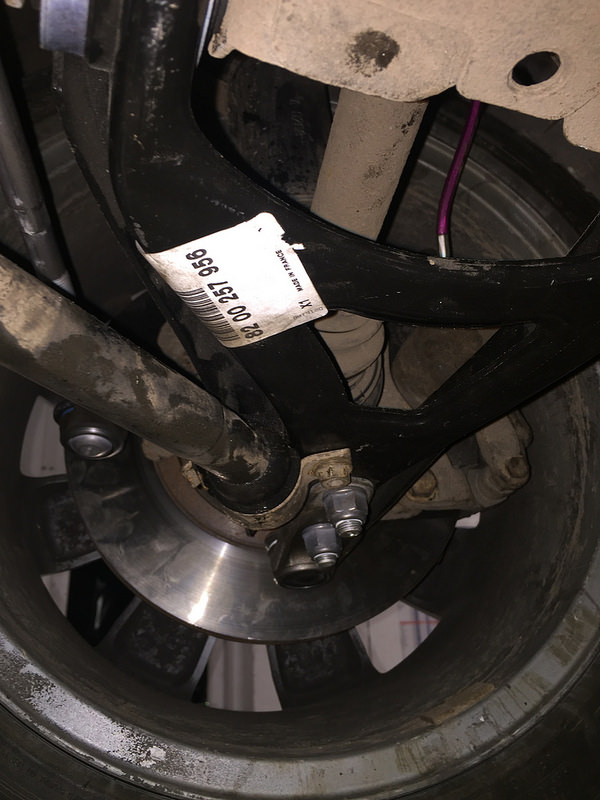

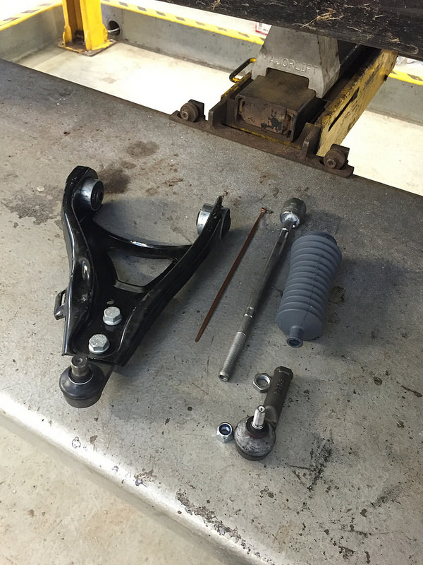

So here we have Genuine Renault Lower Arms, Genuine Renault Inner Tie Rods and Lemforder Track Rod Ends
Untitled

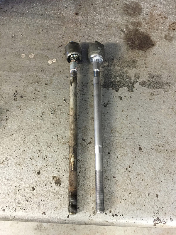

New Vs. Old Lower Arm
Untitled
New Vs. Old Inner Tie Rod
Untitled
Went for the Genuine one as I've heard of issues as I needed the Cup version, which I understand is longer than a standard non-cup

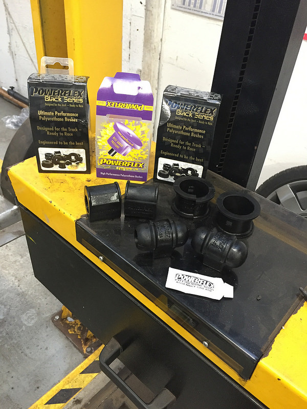

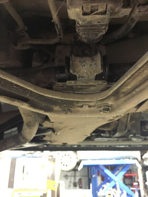

Onto the bushes - Powerflex Black Inner ARB Bushes, Powerflex Black Outer ARB Bushes and Powerflex Black Steering Rack Bushes
Untitled
Outer ARB Bushes fitted and new Lower Arm
Untitled
Untitled
Inner ARB Bushes fitted
Untitled

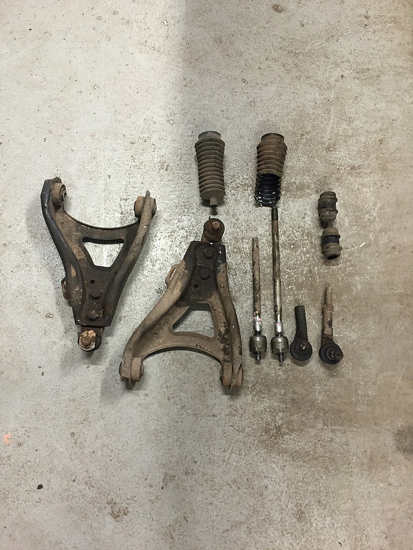

And finally the old bits (minus the inner ARB bushes as I couldn't find the bloody things to put in the photo lol)
Untitled
Didn't get around to fitting the steering rack bushes unfortunately, but hopefully going to do it Monday - so plan is fit Turinis back on with new wheels, fitted camber bolts, fit steering rack bushes, and get it all aligned on a hunter system...then it should be good to go!

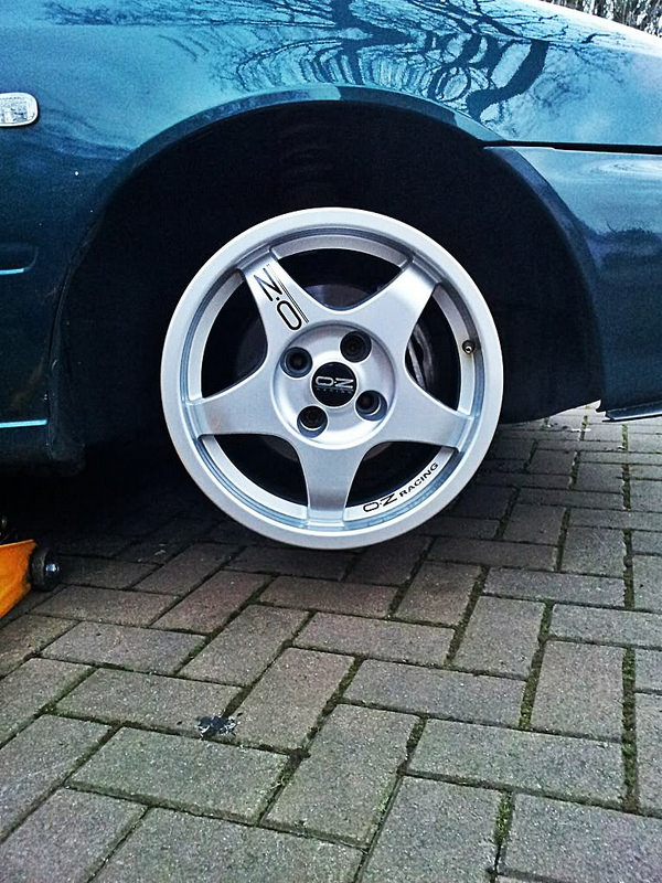

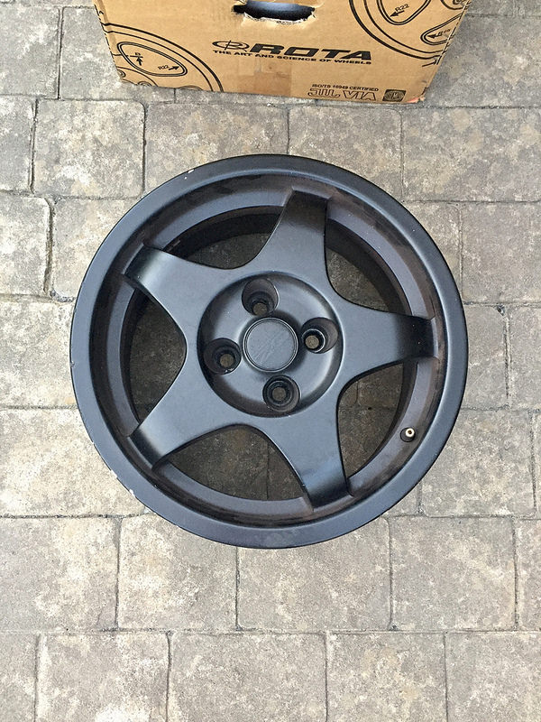

I wasn't lying when I said I'd caught the track bug...already bought myself some track wheels!
Untitled
Now I was keeping an eye out for most things - TD 1.2, OZ F1's, OZ Ultras/Supers, etc, but I fancied something a bit different from the norm, as most of them are seriously overdone (albeit for a good reason)
So this is what I ended up buying - OZ Crono Evo 15", ET36, 7J
Untitled
And this is what a tidy set looks like :
20130326_182750_Hagrid_zps3ef443f8
20130326_173435_Hagrid_zpscf9d1910

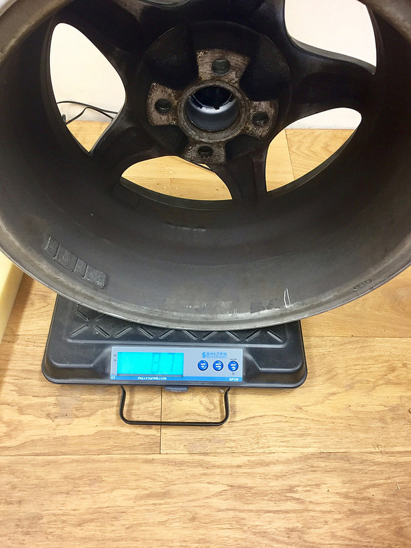

From what I've researched, read and been told these are a very rare wheel, especially in 15" and true 4x100 (rather than multifit), so the chances of seeing another set on a clio is slim! In my research I've found one silver clio on a set of multi-fits and thats it, so hopefully there's not too many more out there!
From what I'd read online and from what limited amount of information I found I was hoping they'd be in the range of 6-7kg, with an Italian Forum saying they were 6.6kg I think it was, so I thought I was onto a winner!
Untitled
Turns out that this isn't the case...absolute b*llocks = 8.7kg! Thought I was onto a winner, but hey ho...turns out I'm not!
At the end of the day I'm not a track warrior which is looking at trying to get my time down every second, I mean I still have half my interior in, so the weight isn't a deal breaker - it's just a bit of shame! I know Speedline 2118's weigh more, and a fair few run them, so it can't be the end of the world haha

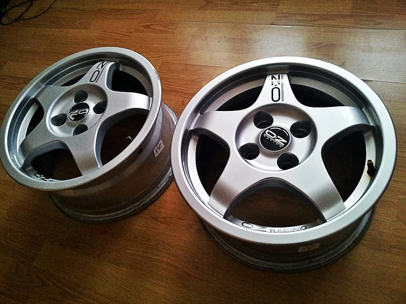

Now it's a case of deciding what colour to refurb them, which at the moment I'm undecided...so will have a good old think and see what people think!
I've done a few photoshops below to see what people think, bit of cheating I'll admit as I've matched them up to my 16" Turinis (which they're smaller than) and lowered my car slightly as I'm going to get Coilovers to get rid of the horrific arch gap on 15's lol
Silver OZ 1
Gold OZ 1
Grey OZ 2
I think I'm leaning towards a nice bright silver and getting the OZ stickers in black, or maybe a grey with white OZ Stickers...at the end of the day it doesn't matter too much as they're only track wheels, so I doubt I'll go to town on them - probably a home refurb or done on mates rates so will look half respectable

Nice to see I wasn't the only one to cut through the tie rods, I couldn't get my TRE's off for love nor money just ended taking an angle grinder to the tie rod.
Wheels have got to be Silver!

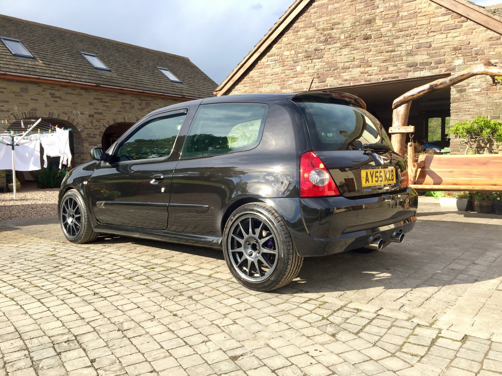

Well looks like I haven't updated this for a good little while again..little bit has happened :
Spax RSX Coilovers happened, as well as finally getting my OZ Chrono's on the car, wrapped in AD08R's, also fitted some new tie rod ends again :
Untitled
Untitled
Untitled
I rate them well, set them up halfway which was still fairly stiff compared to my Cooksports, but the lack of body roll was something else, that along with the AD08's transformed the car massively! Plenty stiff enough for daily use, but I should of adjusted them a couple of clicks softer but quite enjoyed the new found stiffness and handling with it

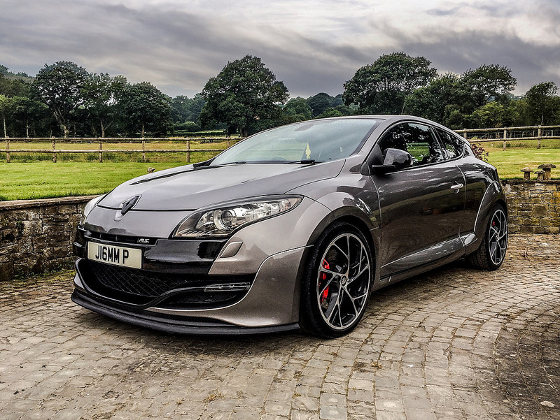

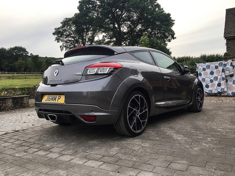

It's an Oyster Grey 250 Cup, with a wicked factory spec and most optional extras - Recaros, RS Monitor, Bi-Xenons, Climate Control, Keyless, Auto Lights/Wipers, DRL's and no doubt some other stuff I've missed!
It's pretty much standard bar a Panel Filter, Midbox Chop and an all important RS Tuning Map!
Why the change?
The Clio has/had gone too far as a daily to put it simply, admittedly it was all my own doing in the quest of improving all out handling. Do I regret it? Not at all, the car ended up being a wicked spec and has shown up a lot of supposedly 'quicker' cars.
But the Megane compared to the Clio it's honestly like luxury. Reading reviews people said the Cup Chassis was stiff, but in comparison to my Clio this is like a Rolls Royce I kid you not! I do miss the 'rawness' of the Clio at times, and the Megane does seem a little less connected I guess you could say, but overall I think it could be the perfect compromise of a daily toy for me!
It's scary how quiet and effortless it seems compared to the Clio, don't get me wrong it puts you back in the seat but it's not until you look at the speedo you see how fast your actually going!
