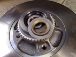

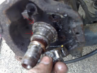

One thing that confused me during the procedure was a ring thing at the back of the bearing. The new disc and bearing did not have this ring thing. The ring thing was separate from the old bearing so I put it back on the shaft and put the new bearing on top. Without this ring thing, the disc slides (in my opinion) a little too far onto the shaft and the abs ring then does not sit right underneath the sensor.
I'm wondering if this ring this is causing the humming.
Here are some pictures of said ring thing...
This is it at the back on the old bearing (top arrow):

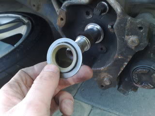

and this is it in my hands after taking back apart to degrease the shaft:
I'm putting it on the shaft with the bevelled inner circle on, facing the car (other way round than in the pic above).

The ring is called a thrush washer and be careful as to how you put it back on, i got it wrong and it subsequently broke into about 50 bits, phoned reno (they didnt stock the part, so factory in france had to send it at a cost of £6.87).
The bearing kits dont come with the thrush washer apparently so keep that in mind for the future...
If you dont put the thrush washer on the wheel wont spin when you tighten it up. Have you changed the bearing on the other side did you say or did bearings come with the discs you replaced?

Danny, ah is that what it's called. One side of it is angular but one other side (the side you see in the pics) is bevelled and it seems to marry up with the end of the shaft. I'm sure that's the way it goes (in fairness I'm not certain). I've changed both rear bearings as they came with the rear discs.

Yeah the bevelled edge should only marry up to one side (and that i could not possibly explain with out showing you how i done it) I tell you though i was well pissed when it snapped, a part so small and simple had the car off the road for 3 days!

Took off the spare and then the disc, greased up the thrust washer, put original wheel back on, test drive - no change :(
Took both wheels off, swapped the discs and bearings over on each side, cleaned the thrust washers, greased them up a bit, test drove - hmmmmm maybe a bit of change. I'm sure it's a little bit quieter. Took the passenger side back off and had a good look at the thrust washer. Seems it's very slightly bent, just the outer ring bit. Think this was caused by trying to prise of the old bearing. Anyway, straightened it up and greased it and I definetly think the noise is less. Not loads less but enough I think to suggest I'm getting closer to locating the problem.
