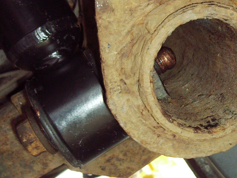

If doing it again and time allowed I'd soak the exposed part of the bottom bolt with WD40 or similar well in advance. I hadn't initially realised that the end of the bolt was exposed and - whilst it was relatively easy to get started - towards the end it started to tighten up again (as the exposed claggy end came through the threaded part). At first I thought it was downward pressure on the bolt but the bottom of the shock could be wiggled on the bolt so I knew it was OK to carry on. Bolt shown below after refitting and before tidying up the copper grease!
The new damper part number is 82 00 681 125
The ones that came off were branded KYB; the new (Renault, boxed) ones have no branding on the damper itself and looked if anything cheaper than the originals.
