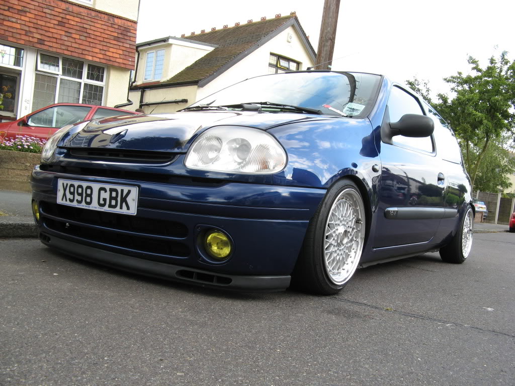

im honoured my ph1 has been used as an example!!!
in answer to your question......LOW!
however i had to mod my inner wings to stop them hitting on the driveshafts,
and my anti-roll bar was hitting on my chassis rails which may have dome some damage.

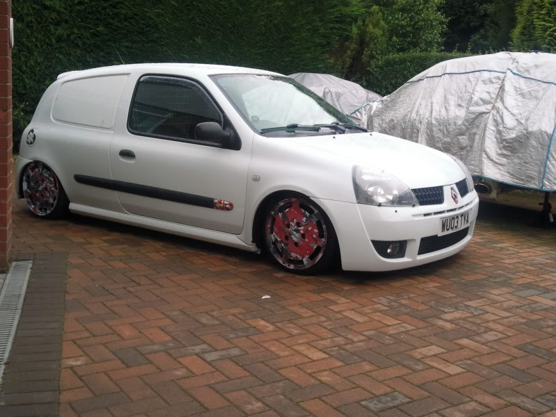

as for mick's (the white ph2 on camo wheels) he had removed the anti-roll bar all together to get such stance. which will not do the handling any favours! and he was on airbags!
They can go very low, but trying to do it withouth damaging anything wont be easy!

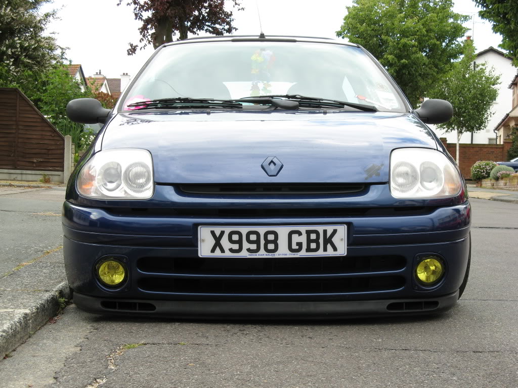

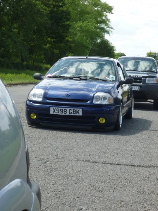

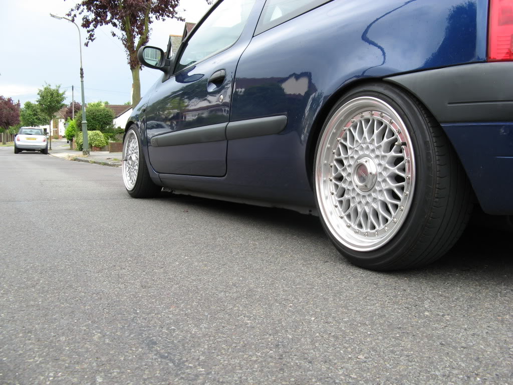

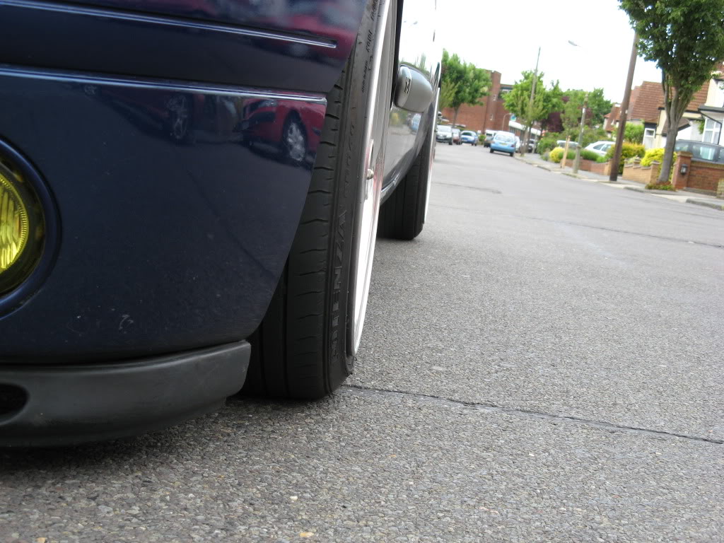

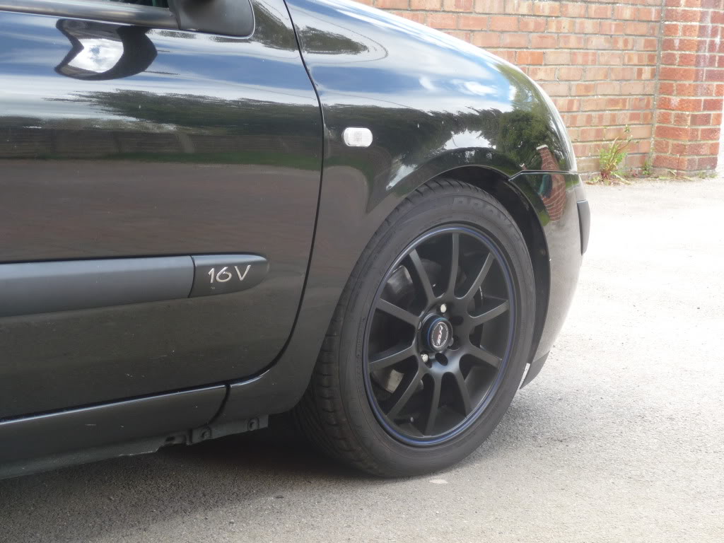

a few more pics of mine
i know i used a splitter on the front, but it was still very very low!!
Rokkor Coilovers
Custom Rear springs
modded bump stops
25mm spacers
15 x 7j wheels (et38) with 165/50/15 tyres
  Dodgy one
The only Problem i had was the inner wings the tyres would catch and make a racket, Annoyed me so it went back up

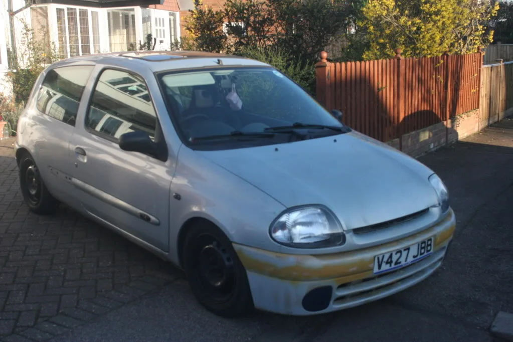

as above you need coilies really. my AP coilovers have dropped my car 65mm and there not even half way on the adjusters, could technically have the car and the floor and the wheels off lol.
this pictures when i first put them on, its lower now....not great pic but still
