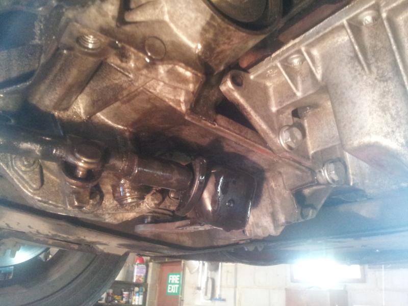

during new year i managed to break the damn clio!!
oil pissing out from inside the bell housing:
so, 1 of these:
Enlist the help of superstar Al:
and its all tickedy boo!!!
considering the amount of oil coming out initial thoughts were a stripped tooth of the diff comng thru the bellhousing, but after a quick poke around nothing major could be seen (i still need to give it a good JIZER session and inspection) so it might well be an input shaft seal???

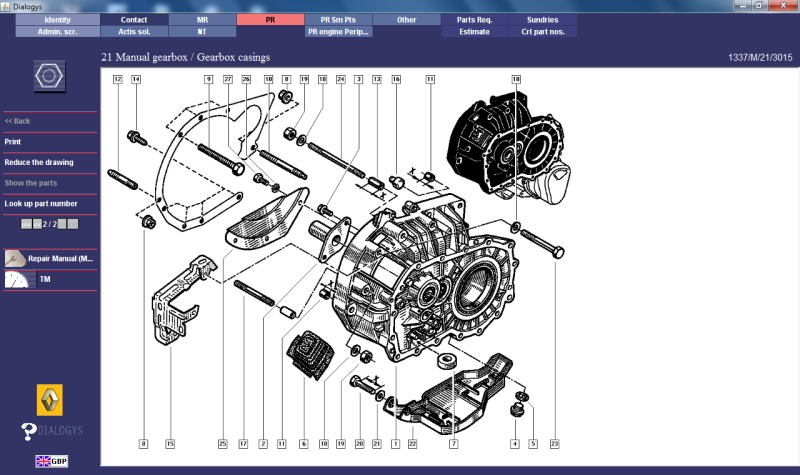

i can see that the sleeve the release bearing runs on can easily be unbolted (item #2), but does the seal simply press in behind this?? or does the box need to be split and the seal fitted from the inside???

this happened on my phase 1. i simply had the sleeve replaced and the seal that sits behind it. im no expert but i think the later boxes are different in that they have to be stripped.

Is there a replacement seal for the input shaft?
NorthloopCup
Yes but it depends on what gearbox you've got. If it's a jc5 089 box, they have a seal within the guide tube for the release bearing. If it's a early jc5 129 it's the same as above, but if it's a later 129 or a jc5 130, then the seal is combined with a bearing and you'll need to strip the box to replace it.
The way you can tell the difference between a early 129 and a later, is to unbolt the guide tube. If you can remove the guide tube with no issue, you've got a later 129.

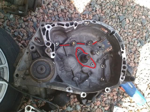

I had some damp areas which colored red in the attached image (not my gearbox in the photo though). Do they indicate a common source for an oil leak? The leak cannot have been huge but the areas were a bit damp.
