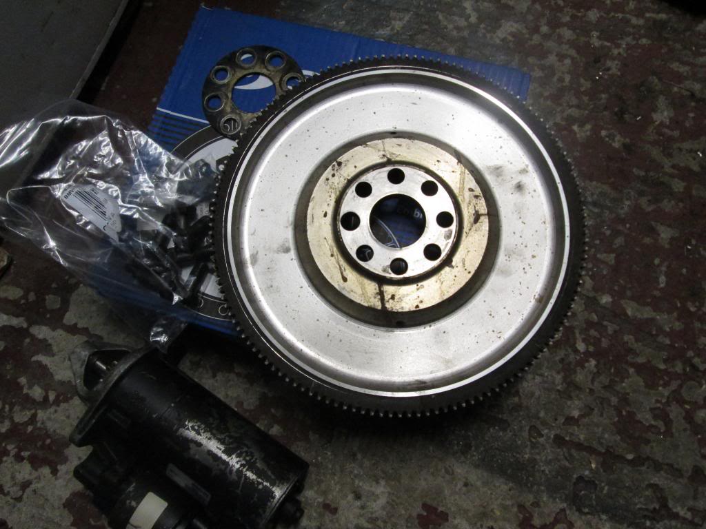

I've just got hold of an M20 flywheel (E30 325i) solid flywheel for the new engine. I'm going to be using that with an E30 325i Clutch and a larger release bearing. Flywheels are £40-50, clutch kit £70-80, release bearing £30. Needs a couple of mm taking off the back so it does not catch on the M52 block (or you can use a spacer that's used on the dual mass to avoid this). Cheap conversation really.

M20 is a good option thats used quite a lot with great success. Aftermarket are 2-3x the cost after you've got a clutch too. DW sell solid 'M3' flywheels which fit, but over £300 for the flywheel alone, then £200 for an M3 clutch. With the M20 you can just use a stock 325i clutch. If you want more clutch performance you can just get an E30 organic/paddle plate instead and still be under the cost of aftermarket..

I thought the only option was to machine the m20 flywheel, didn't realise you could use a spacer. I think you've just saved me a fortune!

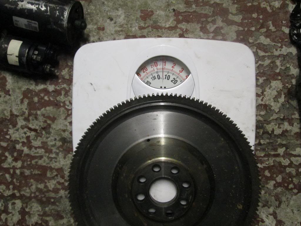

Yeah, I weighed this one the other day and its only a shade over 7kg. There are two versions of the E30 flywheel, the early version does not have the lip on the back, and clears without machining or the spacer - people know this and sell them for more though! Later one and spacer works fine too. Important to get bolts with the flywheel too as they are not cheap from BMW. Locktite with correct torque and they will go again
Re: E36 v2
That's not bad then. They won't be fatigued or anything? I'm guessing you need all the same stuff from the same car too? I.e. starter/flywheel/release bearing from the same age car?

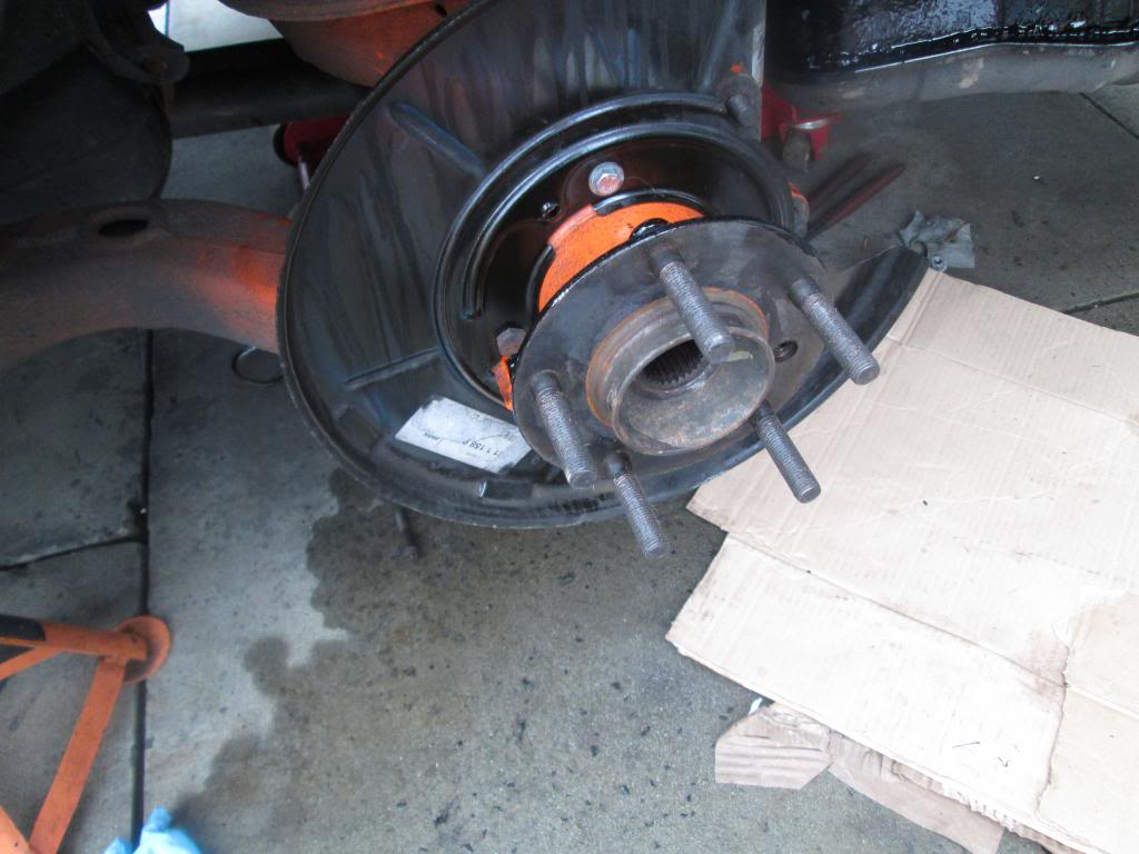

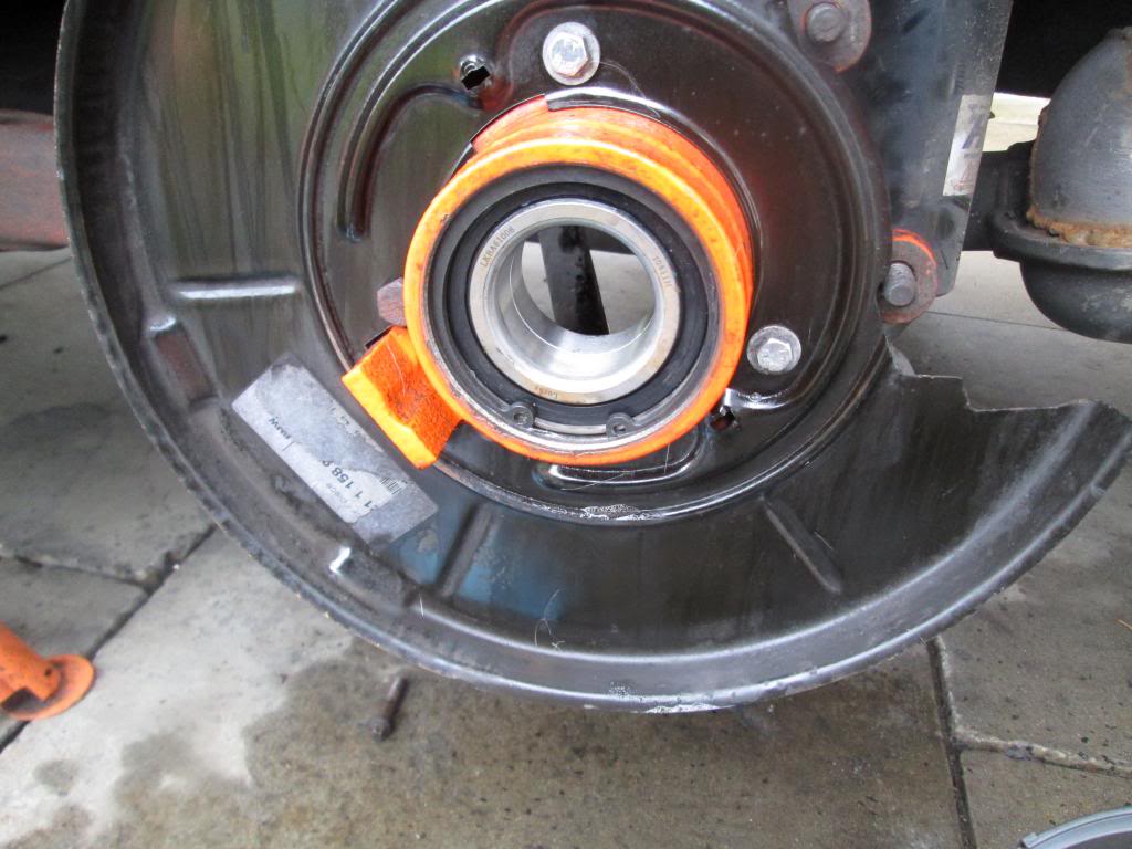

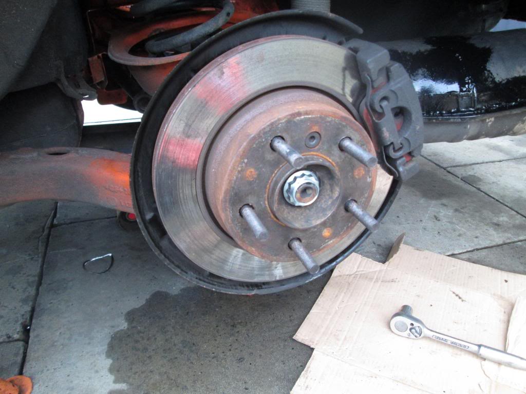

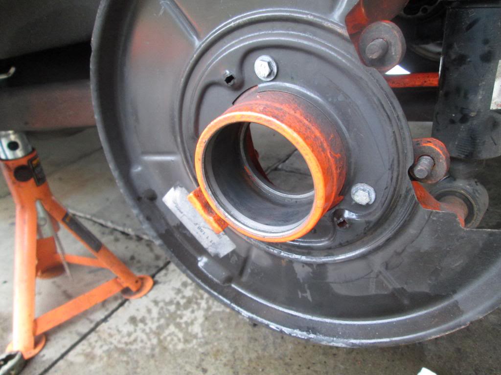

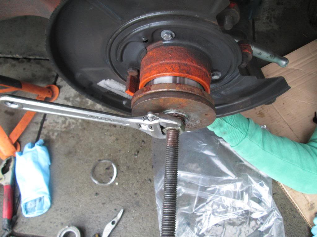

I wanted to fit the new bearing without taking the trailing arm off the car, as the tracking would be out and I didn't really want to be getting it re-done so soon. Decided to try the classic DIY method. I had removed the old bearing race previously, so cleaned it up ready for the new bearing..
Take a couple of metal plates, threaded bar and a few nuts - wind the bearing in..
Fit the circlip and the new bearing is done..
Used the same method to pull the stub into the bearing..
Driveshaft re-fitted along with a new hub nut, job done.

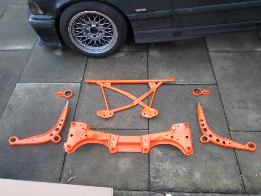

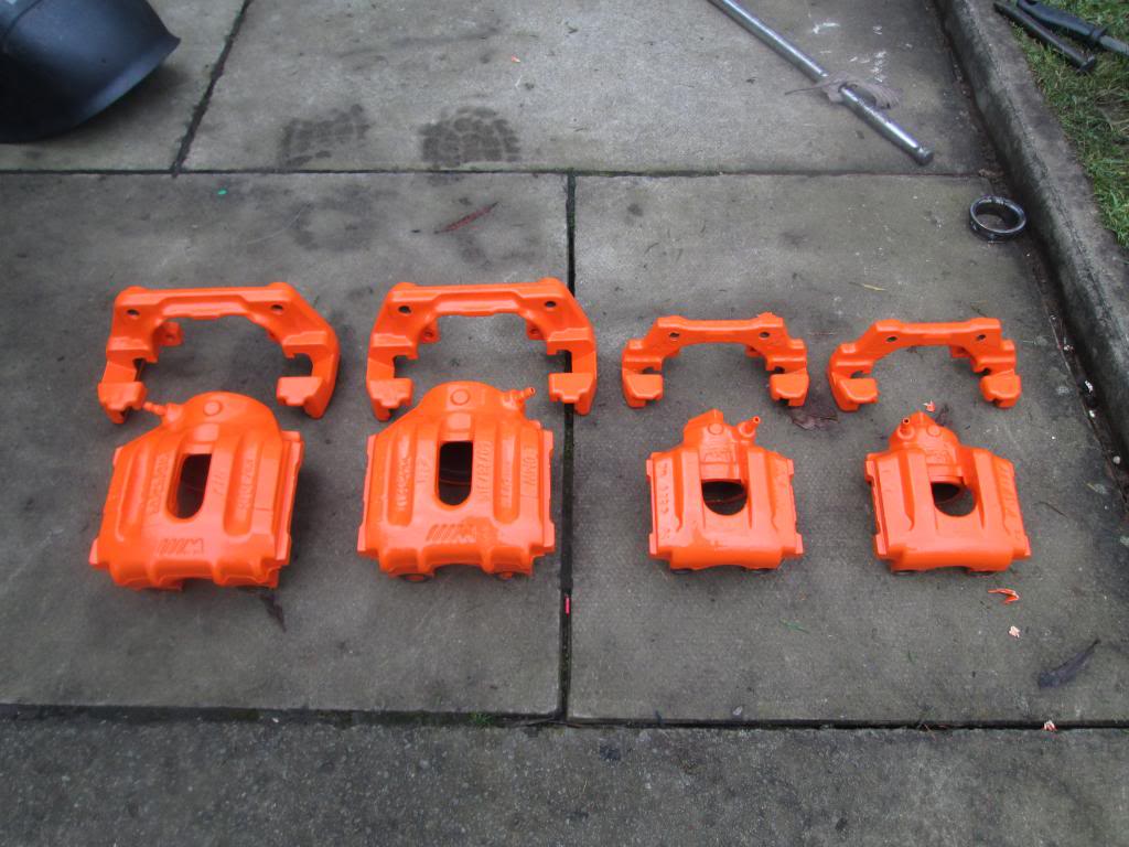

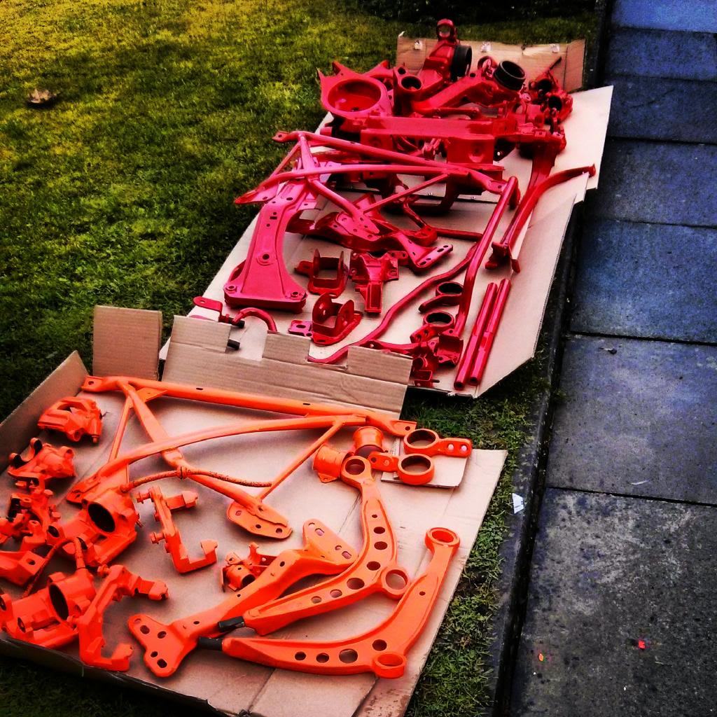

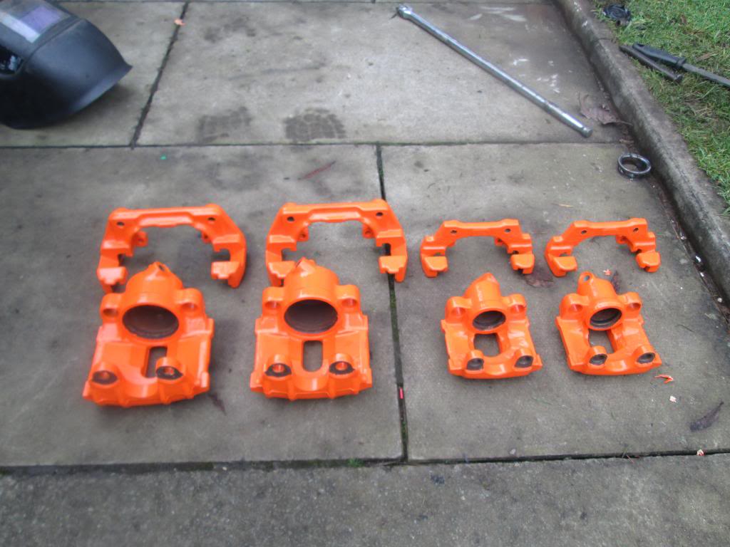

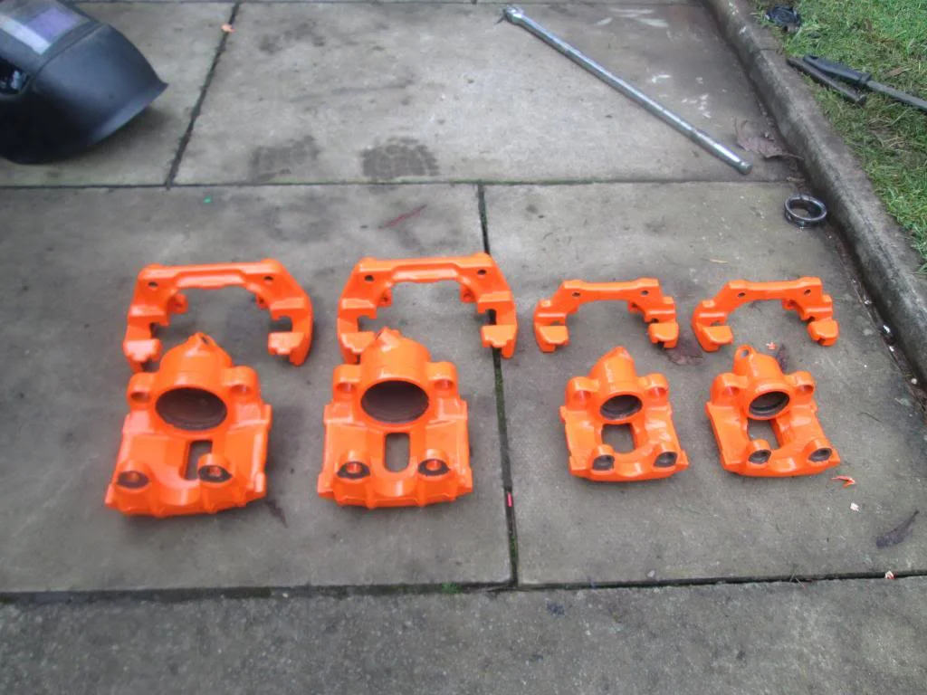

Another collection was made yesterday, lots more powdercoated goodness..
I had a few more bits done (orange) as I never got round to sorting them with the last lot. I've yet to fit the front subframe, but now have the rest to go with it..

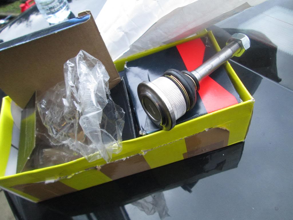

Also picked up a bargin set of balljoints for the wishbones on eBay that were unused from a project..

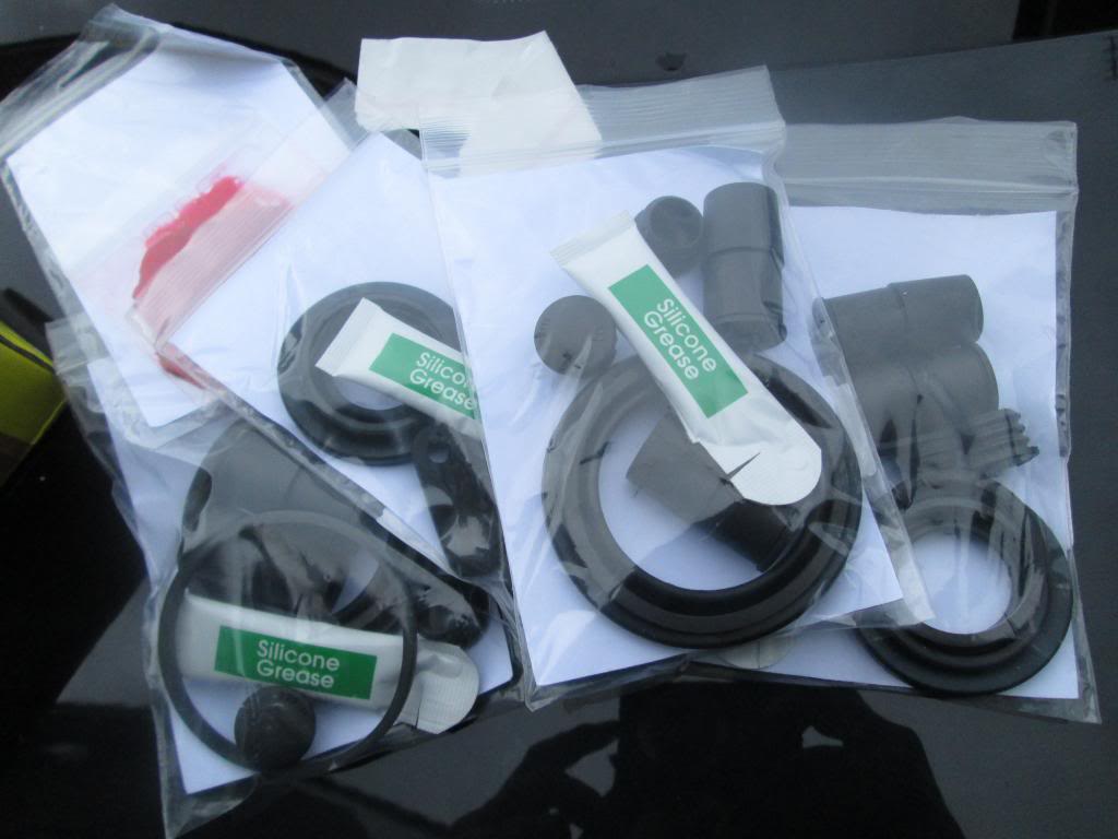

Had a spare set of calipers included, and got a set of new seals to rebuild them..
Various other bits were also included but are mostly just spares. Will get round to getting the above sorted in the coming weeks hopefully :boring:

Greedy with 2 x braces! Sell me one!
Did you flog the original rims by the way? I'm after a pair of the 8.5 rears.
Re: E36 v2
Il get some vids up at some point, its much better now its had some time to bed in.
Unfortunately not both mine, the red stuff is Whiteley's!

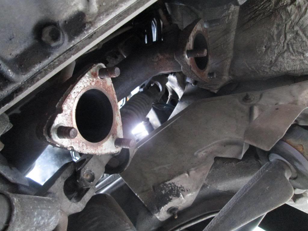

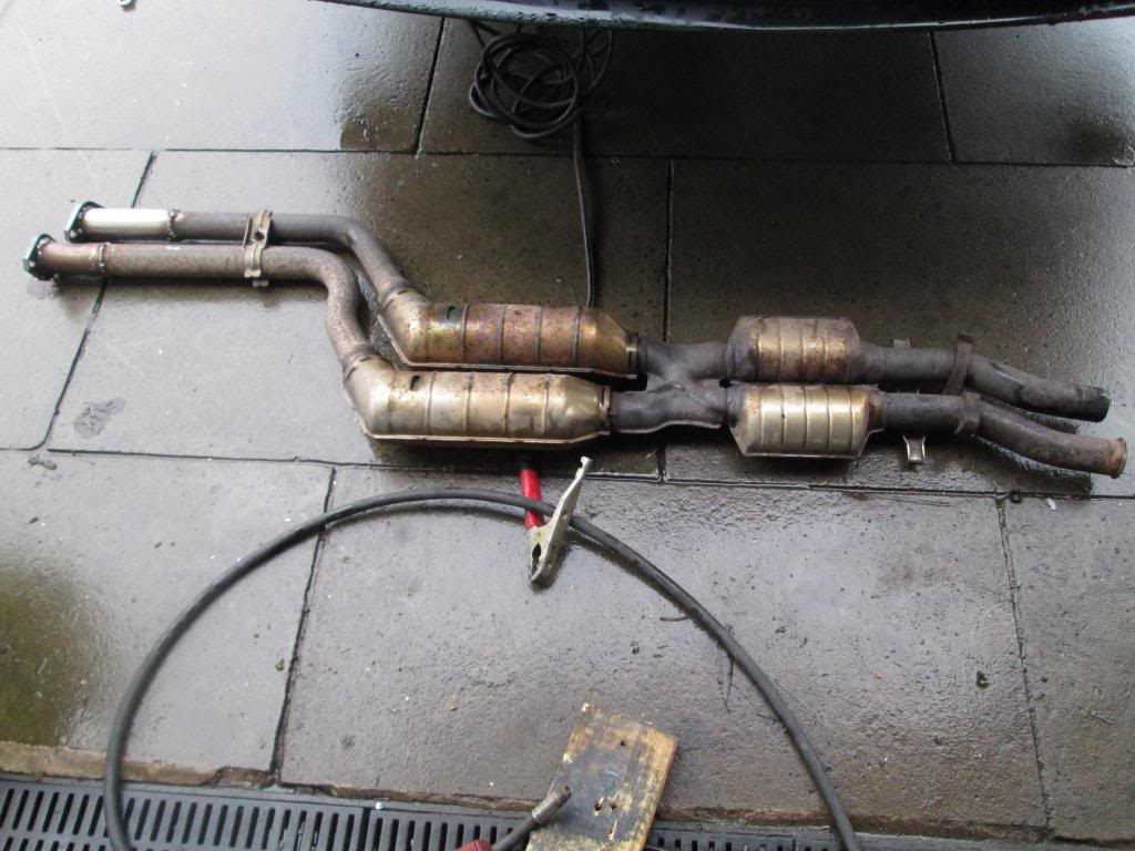

Well before the flywheel/clutch could be attempted I wanted to check if the exhaust would come undone from the manifolds at the flanges. These have probably never been removed on most of these E36s, and my previous one was a f*cking nightmare - with studs spinning/nuts rounding/snapping, had the lot.
I was hoping for better news with this one, as long as this would come off the flywheel/clutch job would be much easier as the exhaust would just come off. The centre section has to be removed to get the gearbox off the engine.

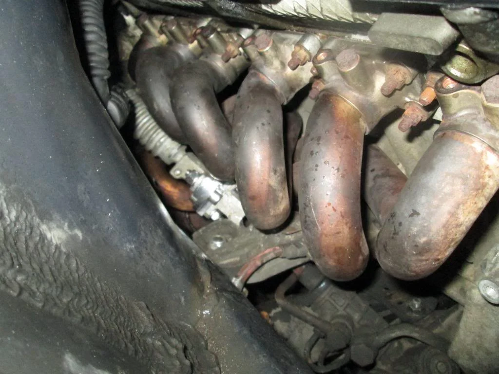

Heated the nuts up and 5 of the 6 came off with ease, just one stud snapped..
Access is easy with minimal fuss when they undo like that. If you have to start cutting/drilling broken studs its an absolute nightmare as there is no room to work at all!

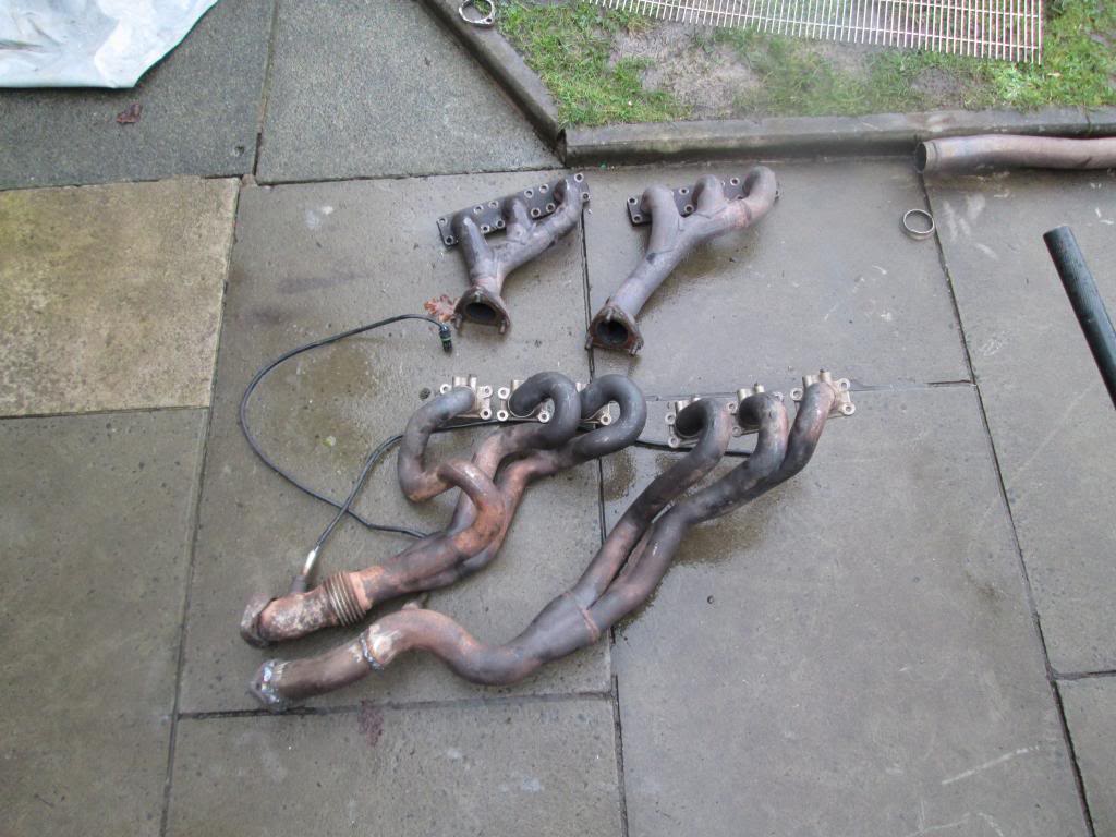

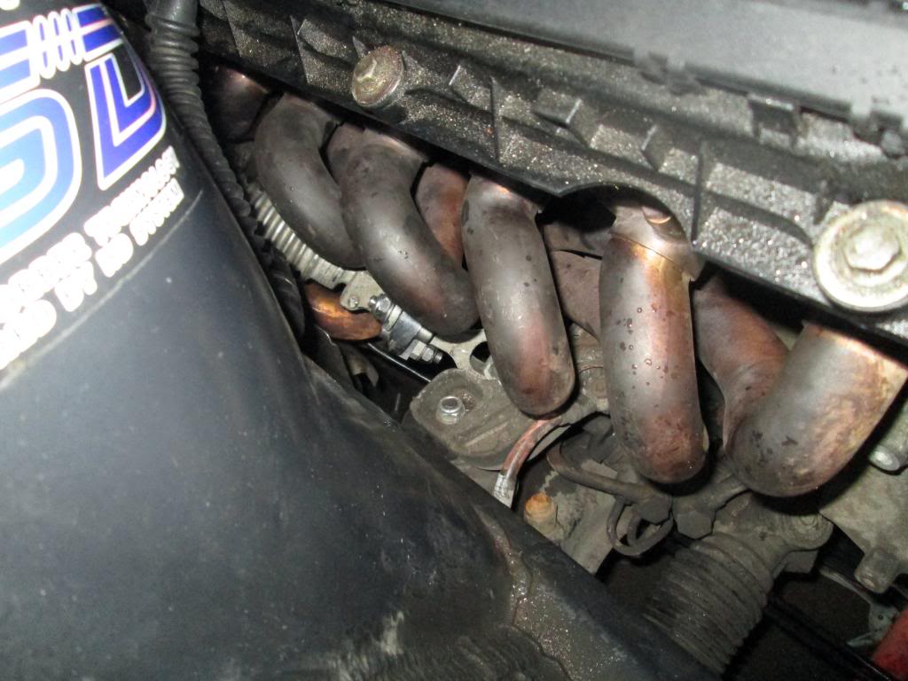

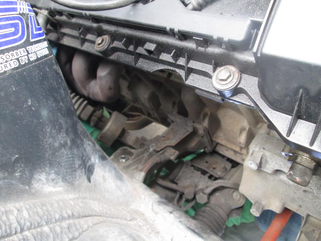

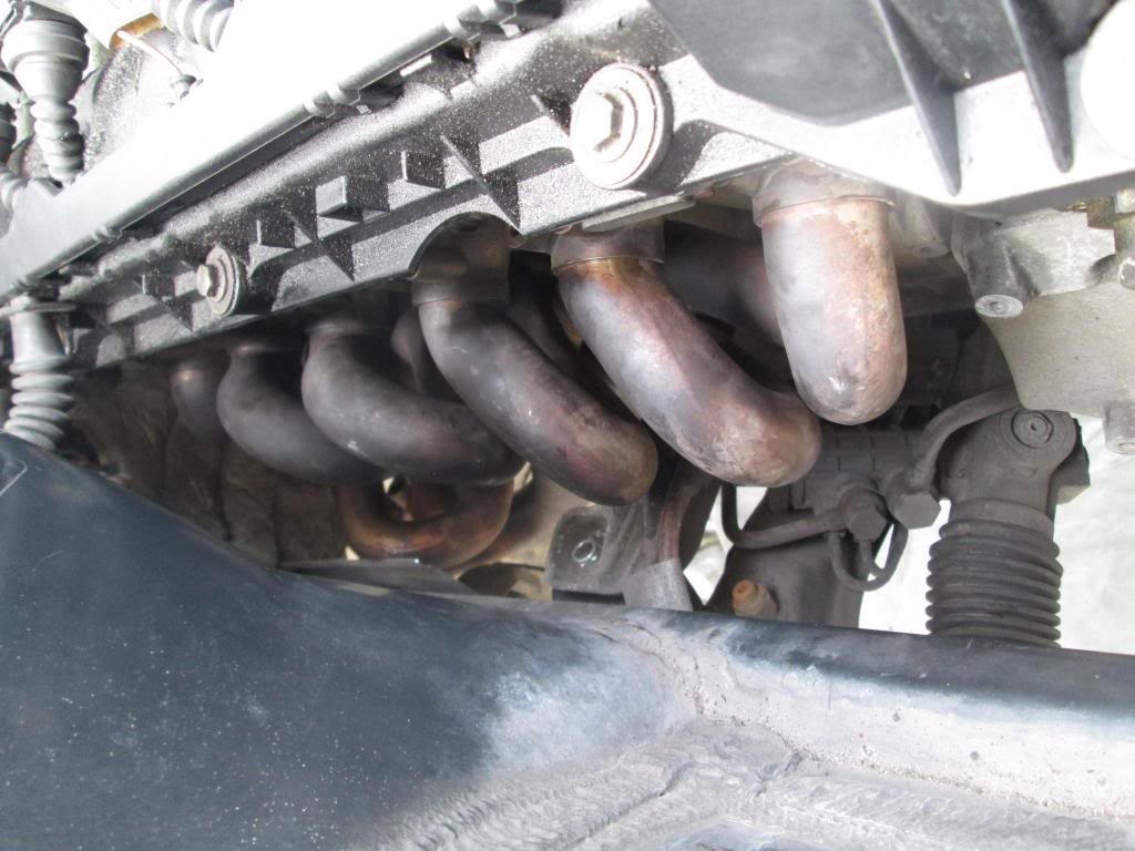

With this taking so little time, I decided to try and fit the M3 Evo exhaust manifolds I got a couple of months back. Picked them up cheap as some muppet had cut one of the flanges off at some point, so they didn't command anywhere near the price tag of what people usually sell them for. Its also important to get the Evo ones as the lambda ports are in the correct place for putting them on a 328, whereas the 3.0 ones have the lambdas in the centre section. Dropped on lucky with the right ones.

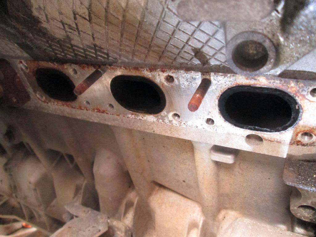

I was a bit reluctant to start removing the manifolds as I had read about people snapping studs, etc. I already have a set of 24 studs and nuts for the new engine (new E90> style), but didn't want to use them on this old engine - so I would be re-using the studs if all went well.
The standard 328 manifolds were removed in about 20 minutes, with most of the studs winding out along with the nuts. Really easy to get to all 24 nuts with everything still in place. Front bank off..
I had also read this job had taken some people 2-3 days to complete, and how much of a nightmare access was with fitting the M3 manifolds on with the engine in. I decided to remove the steering column linkage to make life a little easier, as there is no chance the manifolds would go in with it still there. Simple as sliding the assembly down on the splines, then up off the rack. Makes it easier if you unbolt the rack and move that forward too..

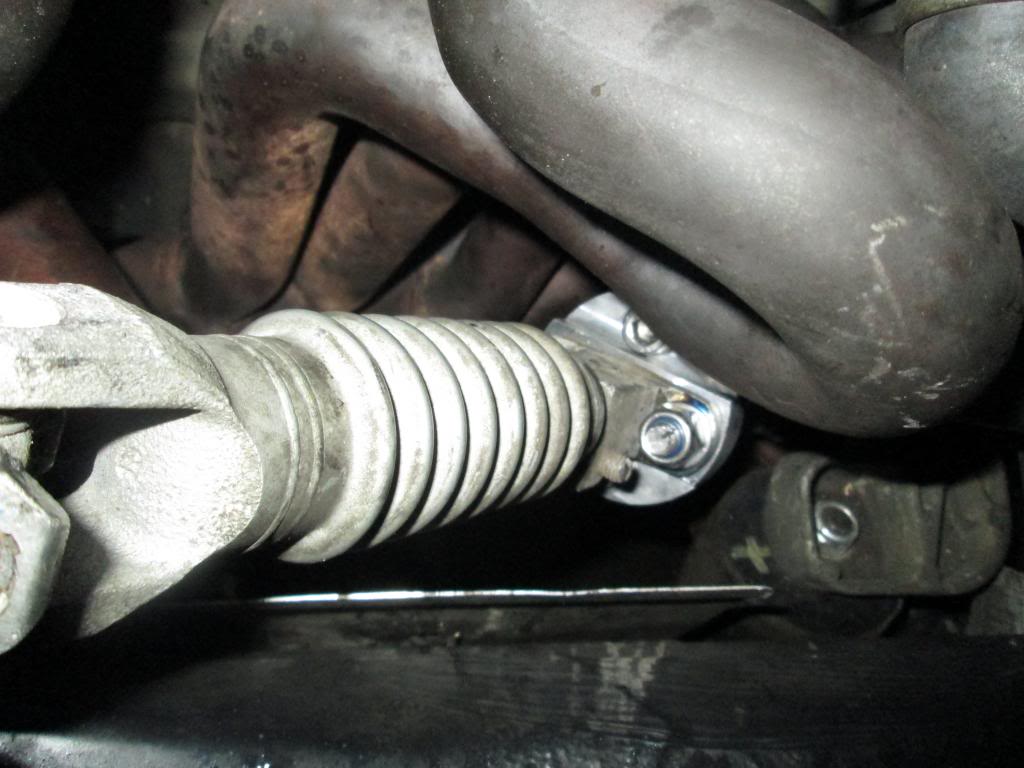

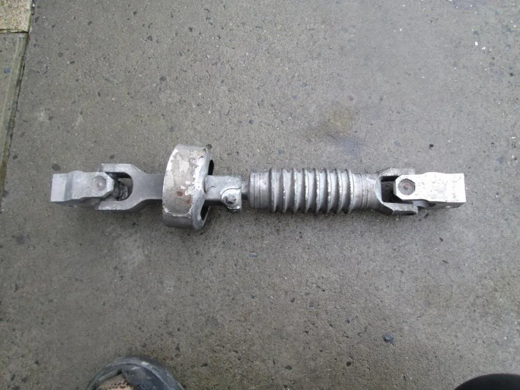

Anyone who has seen one of these on a BMW before will know they have a rubber part in the middle, under the heatshield. They wear and most are likely on the original item, giving a bit of play in the steering (along with a bit of vibration damping I guess). I managed to get a solid replacement 'kit' from a lad on another forum, so this was a good time to fit it. More on that lower down.

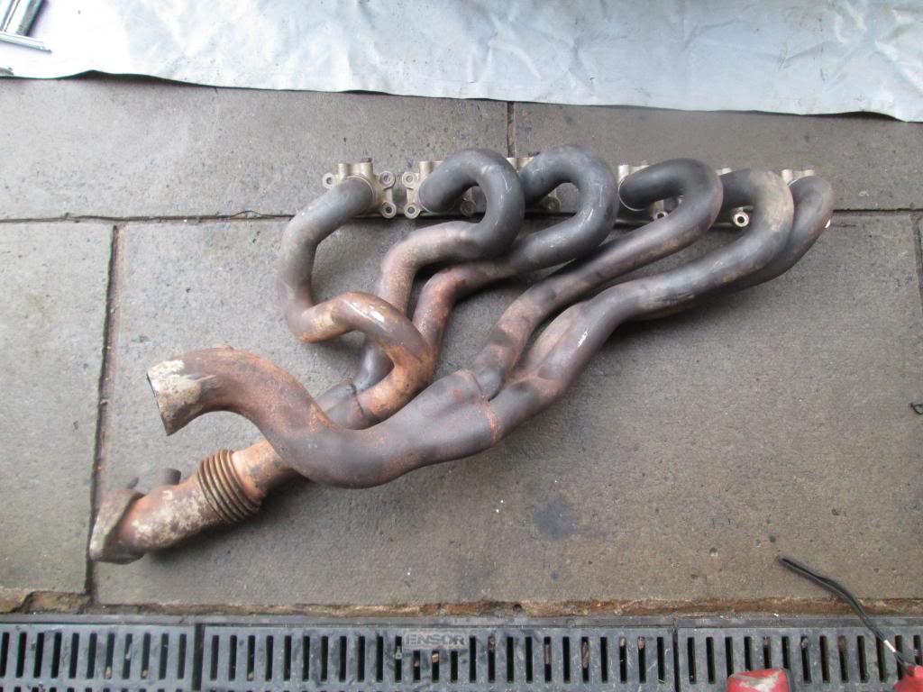

With enough access we offered up the M3 manifolds to measure what sort of piece needed welding on to replace the flange.
Quite a tight fit to get in even with the column linkage off, both manifolds have to be lifted up at the same time. Luckily I had quite a bit of 2" pipe in various shapes spare, so measured up, cut a section and then welded a piece on on with a new flange..
Some difference to the stock 328i items indeed. Obviously now the standard centre section is no use, as it usually goes upwards to join the short manifolds, so it needs shortening also.
Before doing this we fitted the manifold to the car and got on with putting all the nuts on. Typical that at this point there was sideways rain, hailstone, wind, the lot. Having started it I needed it finished so the job went on, even in the grim weather this country seems to always produce.....
...many hours later :sleepy: ...

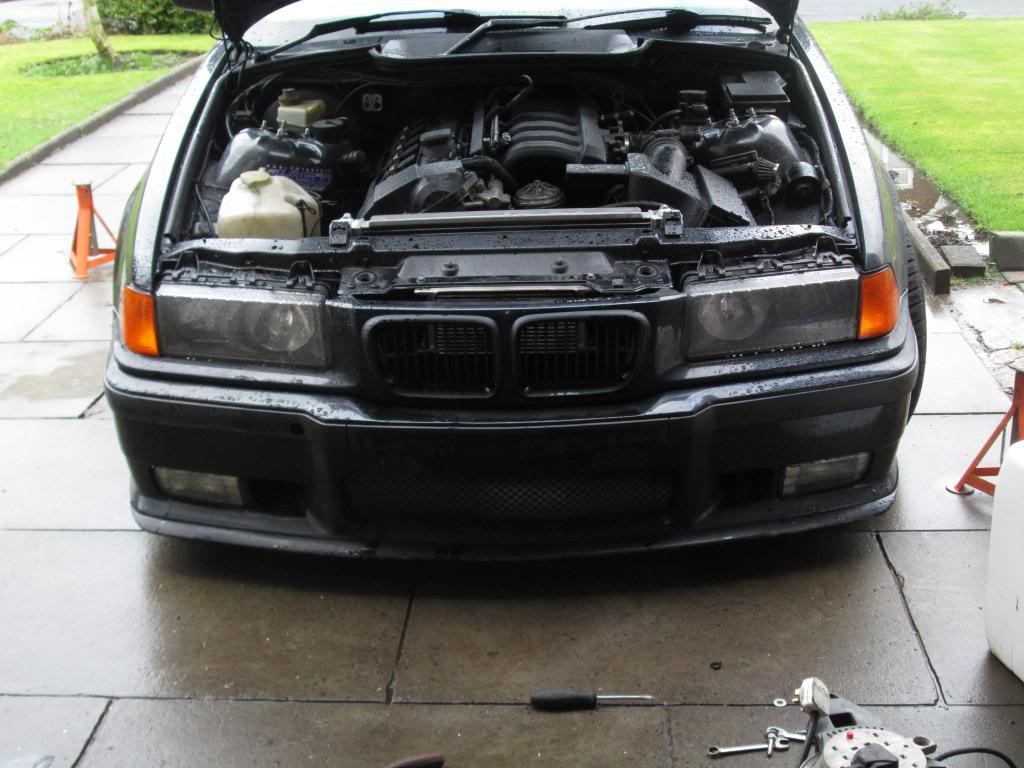

Well the claims of it being a bad job with the engine in are correct - more like what an absolute nightmare of a job, and I rarely think much is difficult! Getting all 6 individual gaskets on is the first trick, then being able to tighten all 24 nuts up with limited access took a vast array of different tools to say the least. Many times during this I did wonder why I had attempted to change it before the new engine goes in. Got there in the end though - sorry to say a complete newcomer would have no chance, and it actually would take days not hours lol.

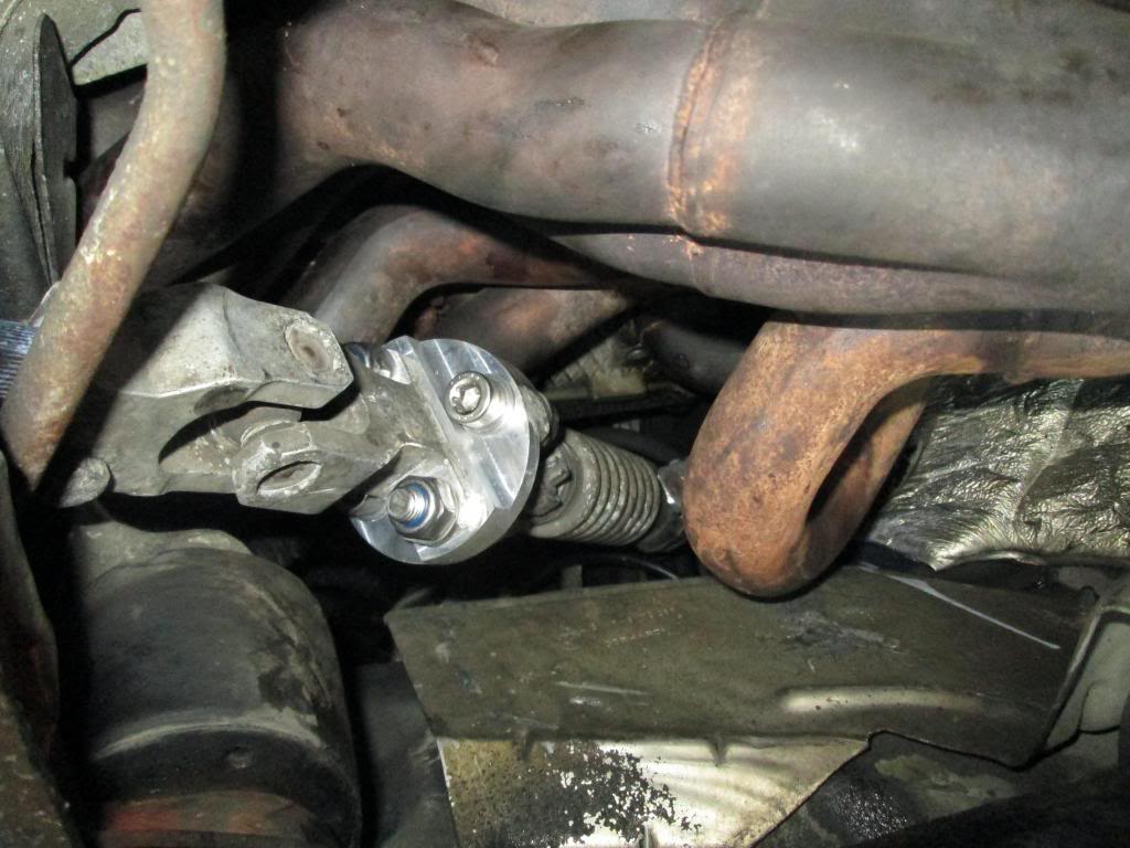

I also drilled out the standard rubber on the steering column linkage, bolted together the solid part and put it back on, works well..
At this point we gave up for the day, cold, wet and tempers tested. I have already modified the centre section to meet with the M3 manifolds, just needs fitting in daylight, so I will update the final bits of the swap tomorrow, hopefully with a video included.

The centre section now looks like this, which is the same as a stock M3 with two flanges rather than going right up by the engine..
Its functional, but I'm not really happy with how it fits on the car even if it is the way a standard M3 is. I've got a few ideas to change it when the engine eventually comes out, but it will work for now. Manifold is a good upgrade, more top end torque for sure (4k+), better throttle response and a completely different sound.

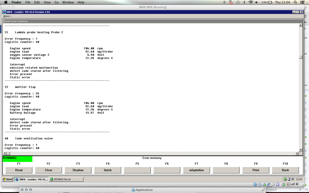

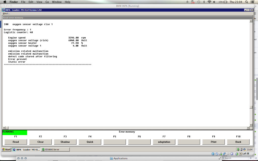

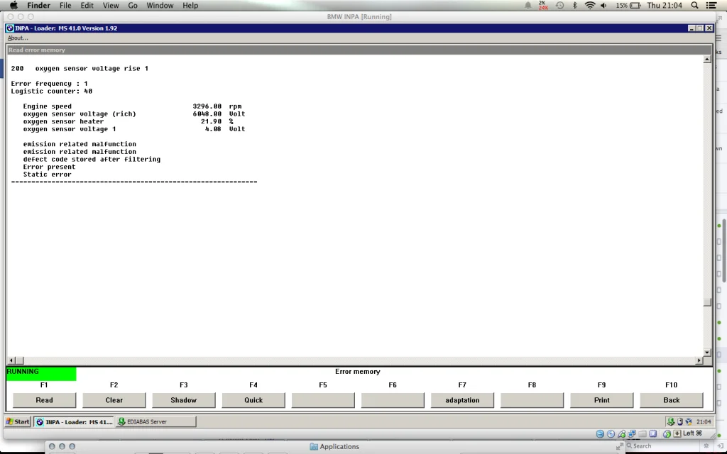

I scanned the car with INPA after fitting to find lambda #1 pre-heater has stopped working. Swapped the two lambda connectors over and then #2 recorded a fault. From that I know which one is faulty, so will have to get them swapped at some point, Bosch 4 wire items are cheap enough. They did look to be the originals when I put them into the M3 manifolds.

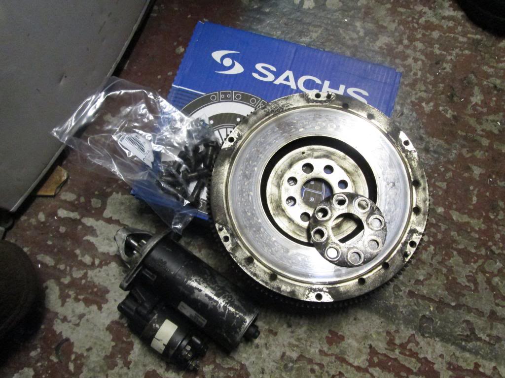

That's all the bits now collected ready to swap. As mentioned previously from reading apparently you can use the spacer from the back of the DMF to keep it away from the sump, but I didn't want to risk taking it all apart to find it would not fit - so the M20 flywheel has been machined and balanced to remove the lip on the back which usually catches the sump. Its down to 5.5kg.
For anyone that finds this looking for what is required parts wise, here are the details:
M20 Flywheel - £50 (From any E30, or M20 engine which uses a single mass flywheel)
M20 Clutch Kit, E30 325i - £97 (Sachs is preferred for quality)
M20 Starter Motor - £20 (From any manual or automatic 6 cylinder E30, or M20 engine)
6 x Clutch Pressure Plate Bolts - £0.68ea (BMW #07119906045)
8 x Flywheel Bolts - £2.68ea (BMW #11227805885)
Shim/Spreader Plate (BMW #11221710038)
Ideally look to get the spreader plate with the flywheel (Most come with it), this goes between the flywheel and bolts to spread the load. Also its recommended to replace the pressure plate and flywheel bolts as listed above. Now until Saturday..

Do I see INPA on a Macbook there mate?
Couldn't sort me out with the software could you? I have a VAG KKL Cable from my Ibiza, I believe these can be modified for the E36 INPA interface. Is that what you did?
