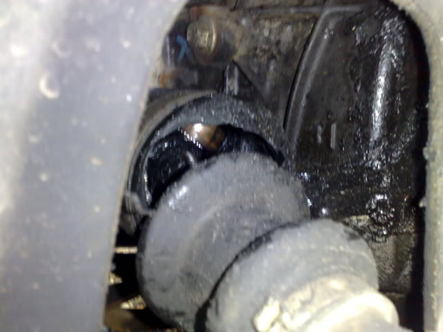

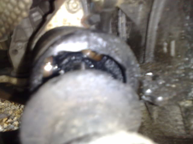

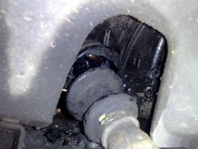

Was changing my front discs/pads over yesterday and noticed that the Driveshaft gaiter is knackered now (bloody car is costing me a fortune at the minute!)! I have attached some piccys so someone can confirm it.
Big job to do? And also parts expensive??
that's definitely had it and with some style!
presume you can get replacement inner boots; the driveshaft will need to come off to fit it and you'll therefore need to replace the gear oil too. has it been split long? as you'll have got all sorts of grit in there too, which will accelerate wear in the joint - need to inspect it thoroughly once it's off

If thats the offside d/s (think it is? can't tell) then you won't loose the gearbox oil.
As said i'd get it off and inspect it as if theres a load of crap in the joint it'd probably be best for new d/s time.

Ive not seen one split like that before. Assuming there is no internal damage to driveshaft it should be a easy job, need a new gaitor kit from Renault iirc they still come with the grease).
On the 172mk1 (im sure mk2 is the same unless they are held in by a pin) the driveshafts just pull off that side by unbolting the hub nut and removing the suspension strut.

mine went like that and they dont do a gaitor for that side its a new driveshaft job. trust me on that i looked everywhere for a cheaper way. its definatly a new driveshaft. i managed to get one from a local motorfactors for 90 quid. dead easy to change though about 1hour job.
  silver 172 ff
and before anyone says thats rubbish if you look closely you can see there is nowhere for the big side of an inner bootto attach to and you couldnt get one on if there was coz there is no way it would get over the bearing. is a silly design.

mate this a dealer only new driveshaft, renault do an exchange offer i believe!! you can't replace the internal c.v boot on the drivers side

Its a new shaft.
£206 from Renault + fitting works out about £340 job lot.

euro car parts drive shafts will fit in a fashion, but they have an external cv boot clip on the inner cv boot which catches the block, so they dont fit safely!! you need an internal c.v boot on the 2.0ltr clio so it doesnt catch the block!!
