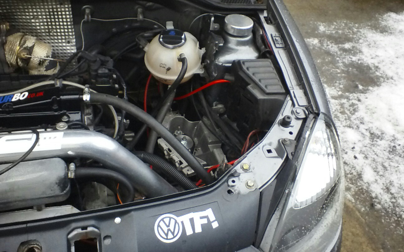

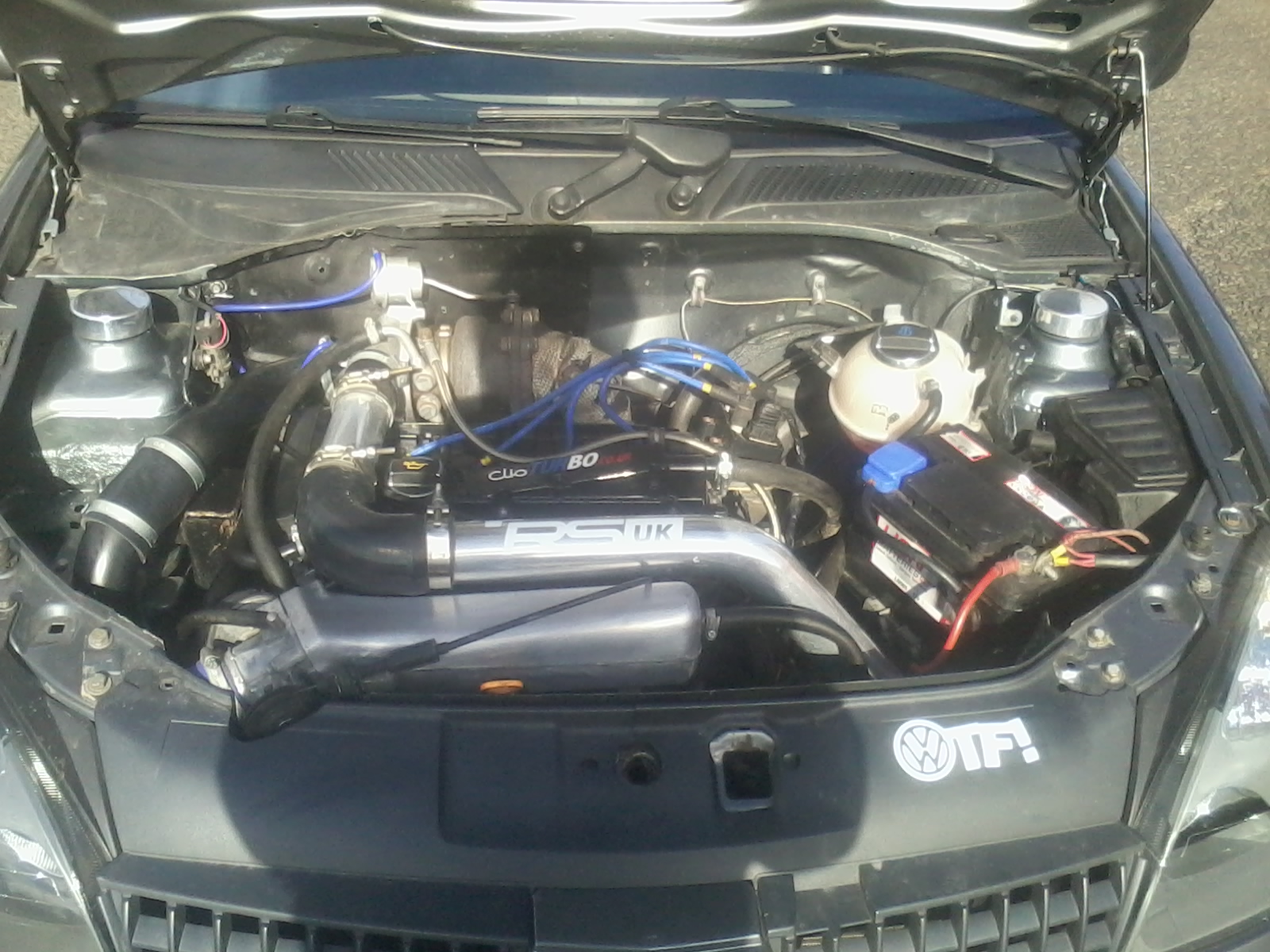

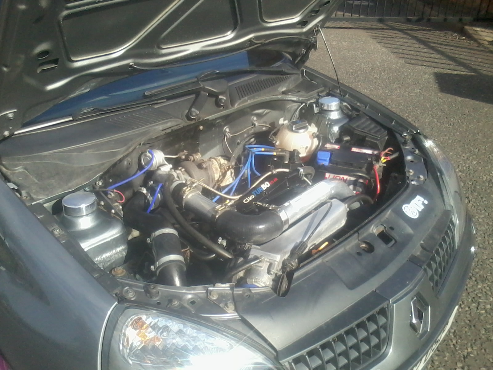

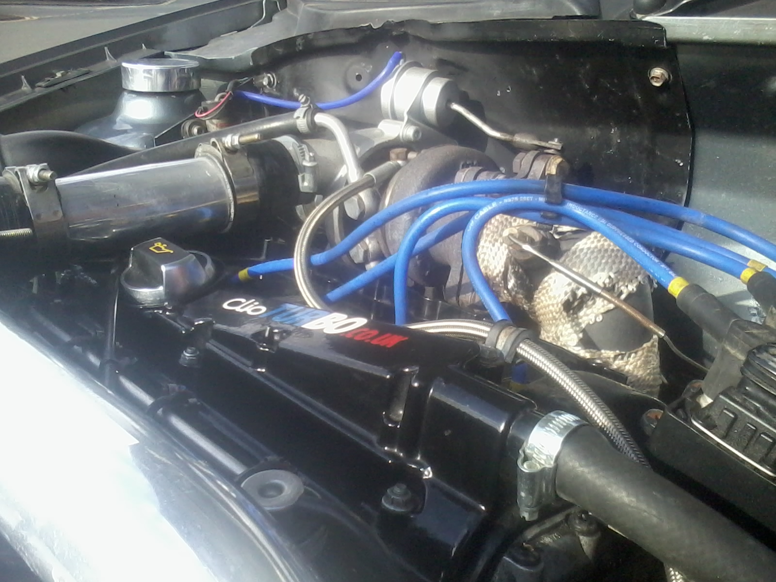

Things have been quite with the turbo as I'm very happy with the way it's driving. So I've decided to make the engine bay look cleaner and frostbite up a little so I moved the battery into the wheel well in the boot. I used 4 guage live and earth with a 150amp fuse by the battery. I now have to tidy up some of the wiring loom and pipe work but it's bit by bit at the min as its COLD

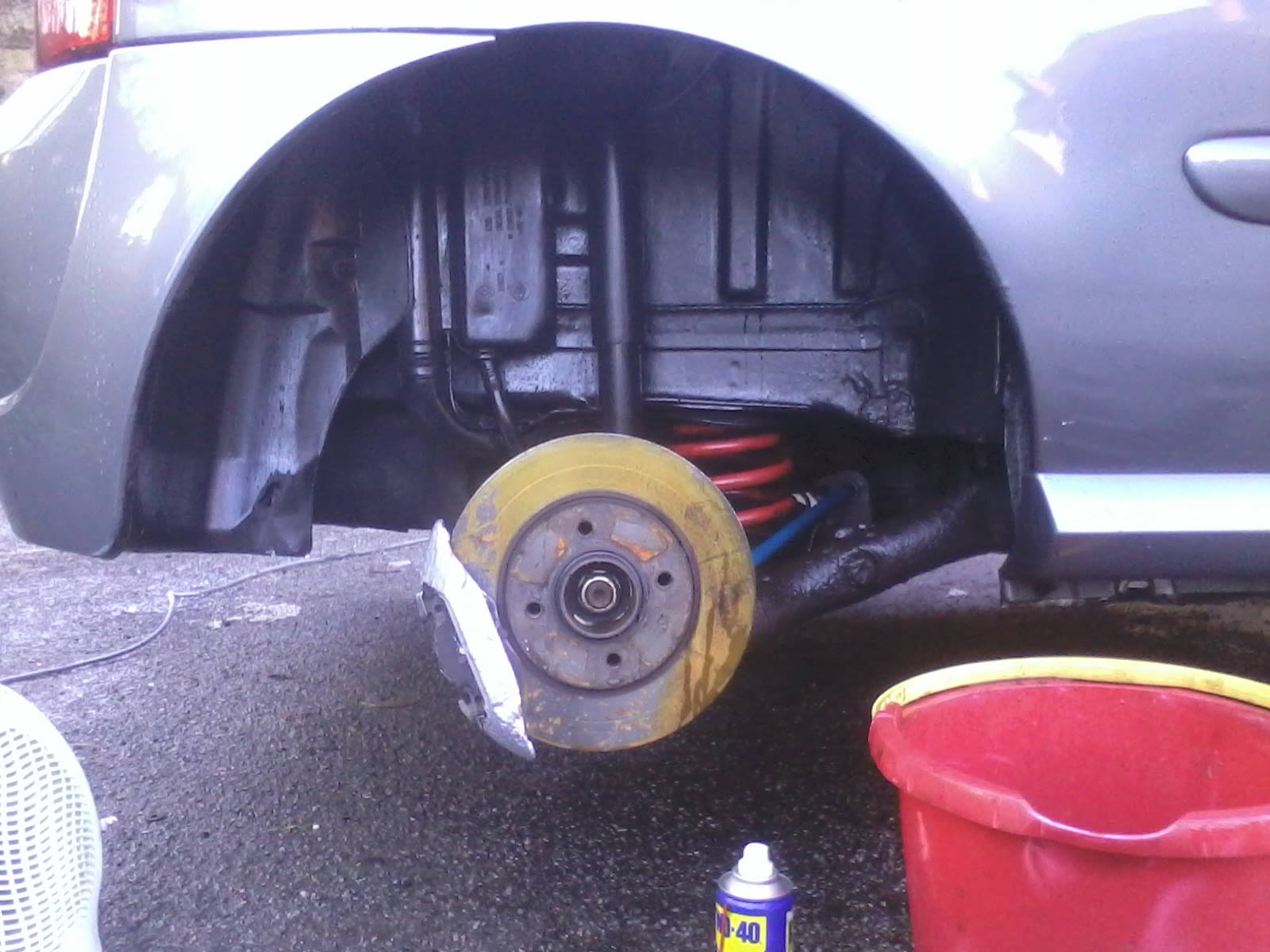

Well chuffed today found a passenger side arch linear that I needed from one of the cars I've stripped well chuffed so clean Archie and get it on weekend should be easy as cleaned after I got it
Before
after a good clean

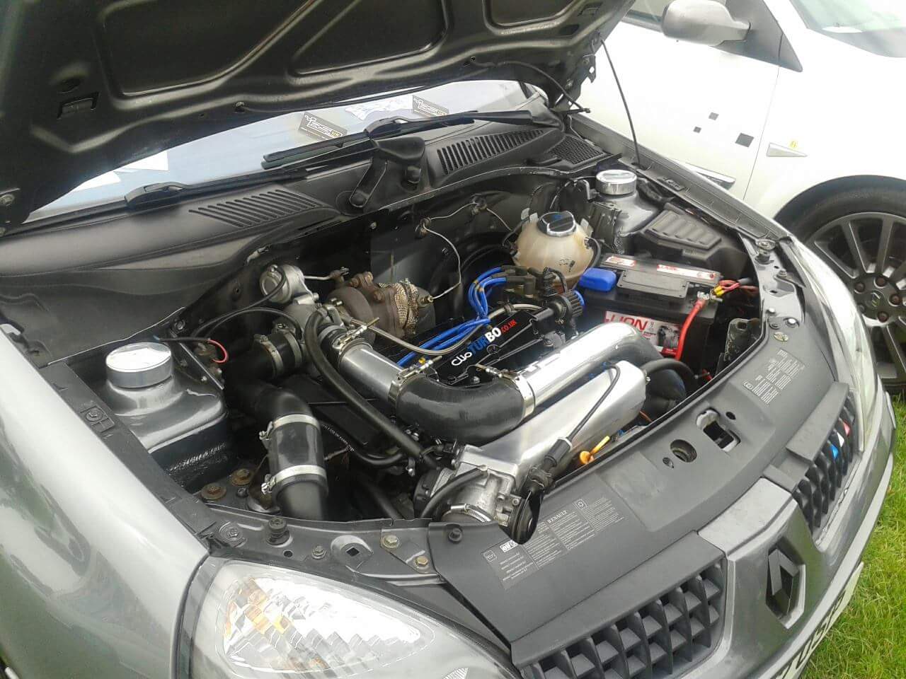

I will just put this here a spec list
Colour is United grey from a mk5 golf gti
Brakes are hc brembo discs with brembo hp2000 pads with braided lines and abs removed with dot 5 fluid
Suspension and steering
Vmax front coilovers eibech rear springs with cup dampers. Trophy wish bones and ball joints nd power steering removed
Transmission
Golf 5 speed gearbox fitted with short shift using
a helix paddle clutch kit
Ecu is a Mega squirt 2 3.2.1. ECU Mapped by Teamcarr.net Andrew Carr
Engine spec.
1.8 20vt Audi engine BAM
SCAT rods with arp bolts
Elring head gasket
Audi s3 semi forged pistons 20mm pins
Light weight vr6 fly wheel
Acl bottom end bearings
Crank shaft lightly polished for 100% trueness but using std size bearings
Metal water pump
Gates timing belt kit
Agu big port head and inlet manifold
Cable agu throttle body
TD05 18G Turbo from a Subaru Impreza
630cc Siemens injectors
Pfr7b plugs
Running a clio 172 coil pack
Solid engine rear mount and vibre tec mounts
Custom inter cooler kit
Custom intake
3 port boost solenoid.
Rolling Road at veuzu came back as she's running 300bhp so can't complain
Battery moved to the boot for better balance and better airflow around engine
Will update list if it changes

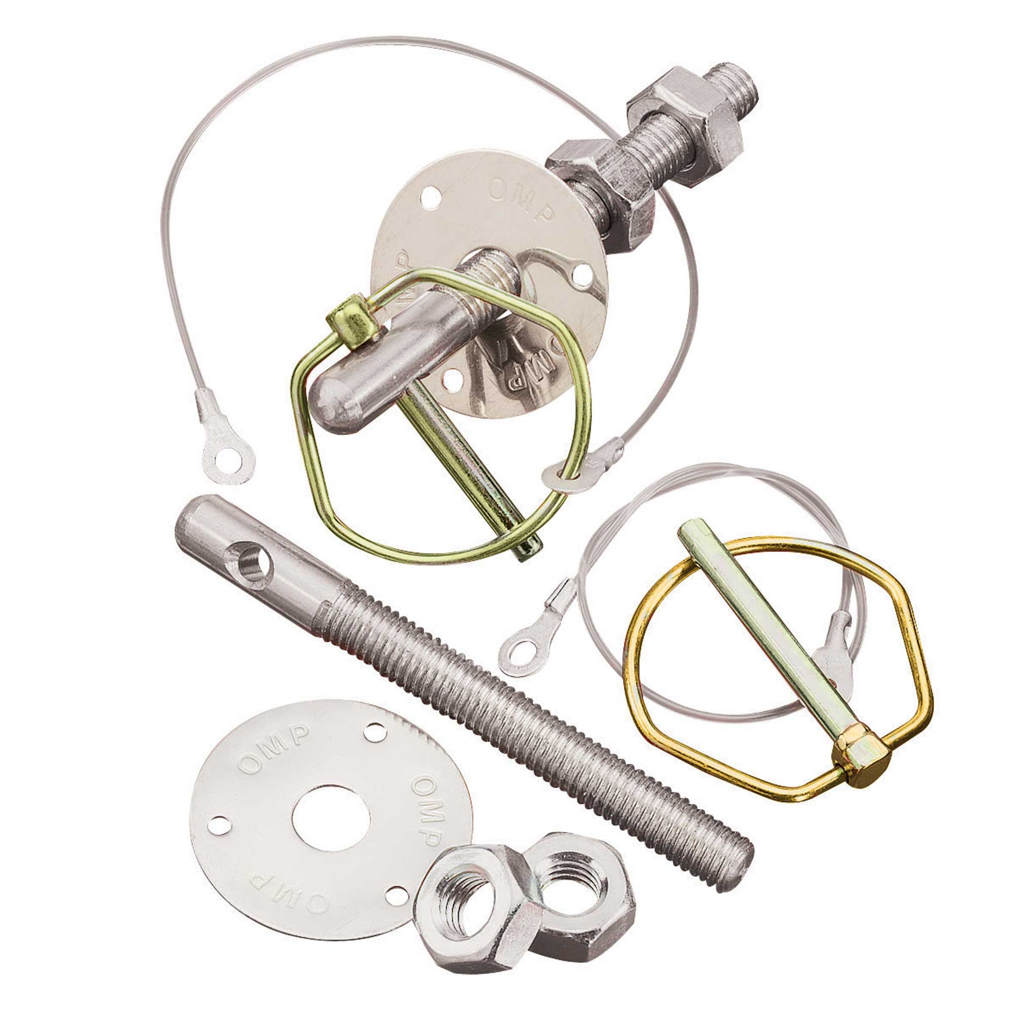

Well I've been thinking about bonnet catches today and how much pressure mine must be under when stretching her legs. I was thinking aero catches but a bit in your face for the turbo maybe? Seen these which I very much think fit the bill
Cub.
Not 100 per cent sure, but some places have issues with those style bonnet catches with the MOT. Same reason the merc / rolls Royce badges now need to be able to flex / bend if you run over a pedestrian.
Depends how friendly your MOT place is though... ;)

Oh right aero catches look a right pain to fit lol
cs_dave
West Midlands
They looked so annoying, I got someone else to fit mine!
I think I may end up going aero catches tbh the more I think of the pins the more I'm already growing off them lol. My concern is with running decent power the bonnets going to say hello at some point with 2 kids in there as its my daily 70mph bonnet comes up hmmmm not good

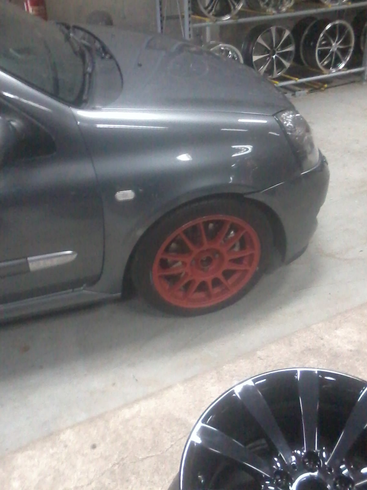

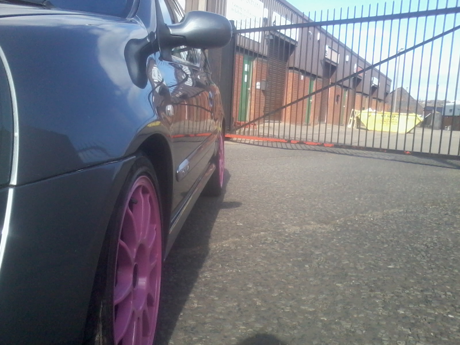

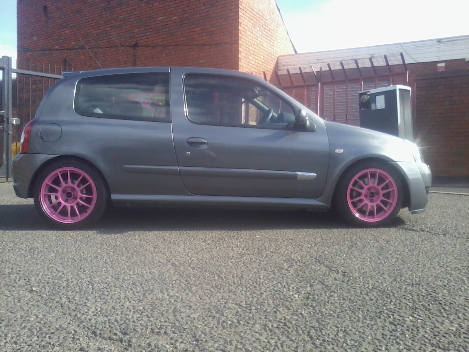

Well I've treated tubs to a set of o.z super leggeras they are in need of a proper refurb but I've rubbed down and primerd. Because I've done a deal with my 172 alloys I'm sticking with a DIY refurb until I can put car off road for a few days and running like that for a bit. So I popped into sunset powder coating to swap my tyres and they gave me a set of spignit rings (win) top place some great work.
Here's how it's sits today

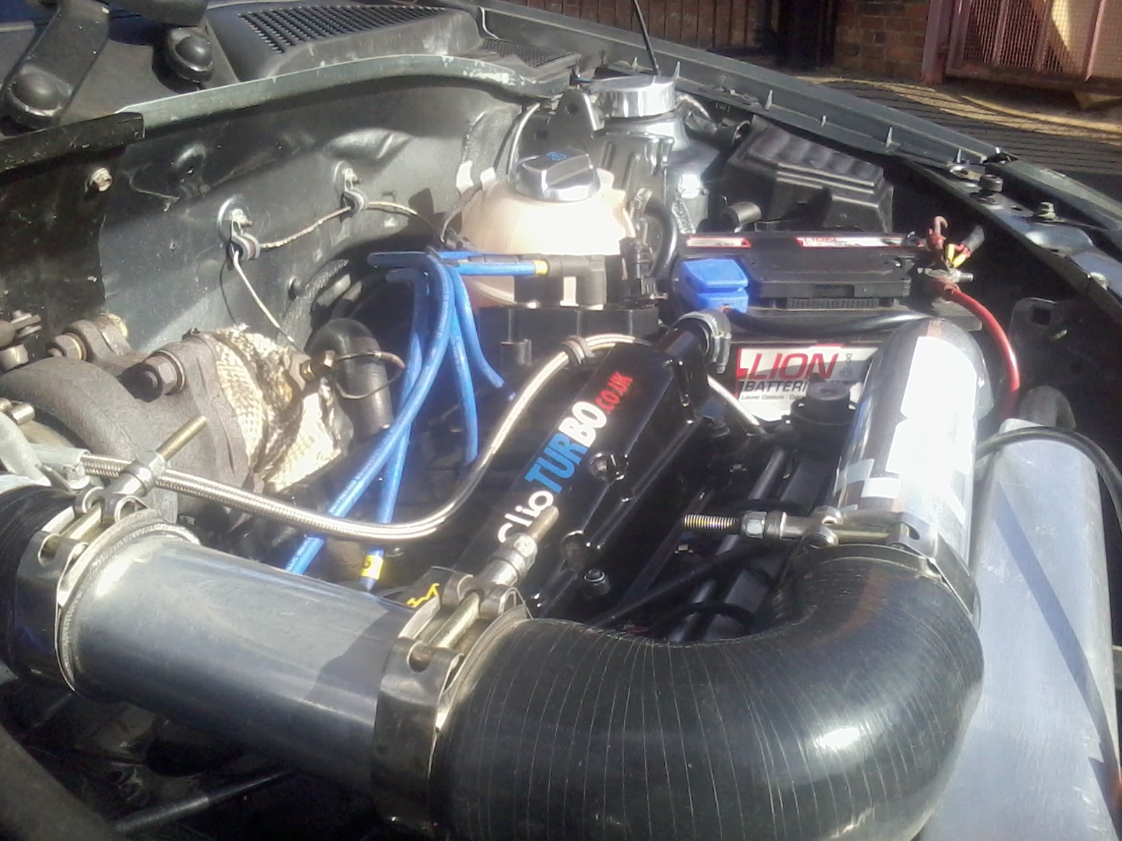

I've finally got some colour on the superleggera I'm sure you will all love it. Very pleased with them tbh. I also got the old girl some megnecor ht leads and moved the battery back under the bonnet.
Looked threw the recipient throws up something strange it's running
Pfr7b spark plugs which come up as scooby plugs so I'll be swapping over to some plugs suitable for the BAM lump.
I also need to paint all the plastics for the shows

It was all goin well till I saw the pink wheels Dave !! Think Tom started a craze :smile: :wink:

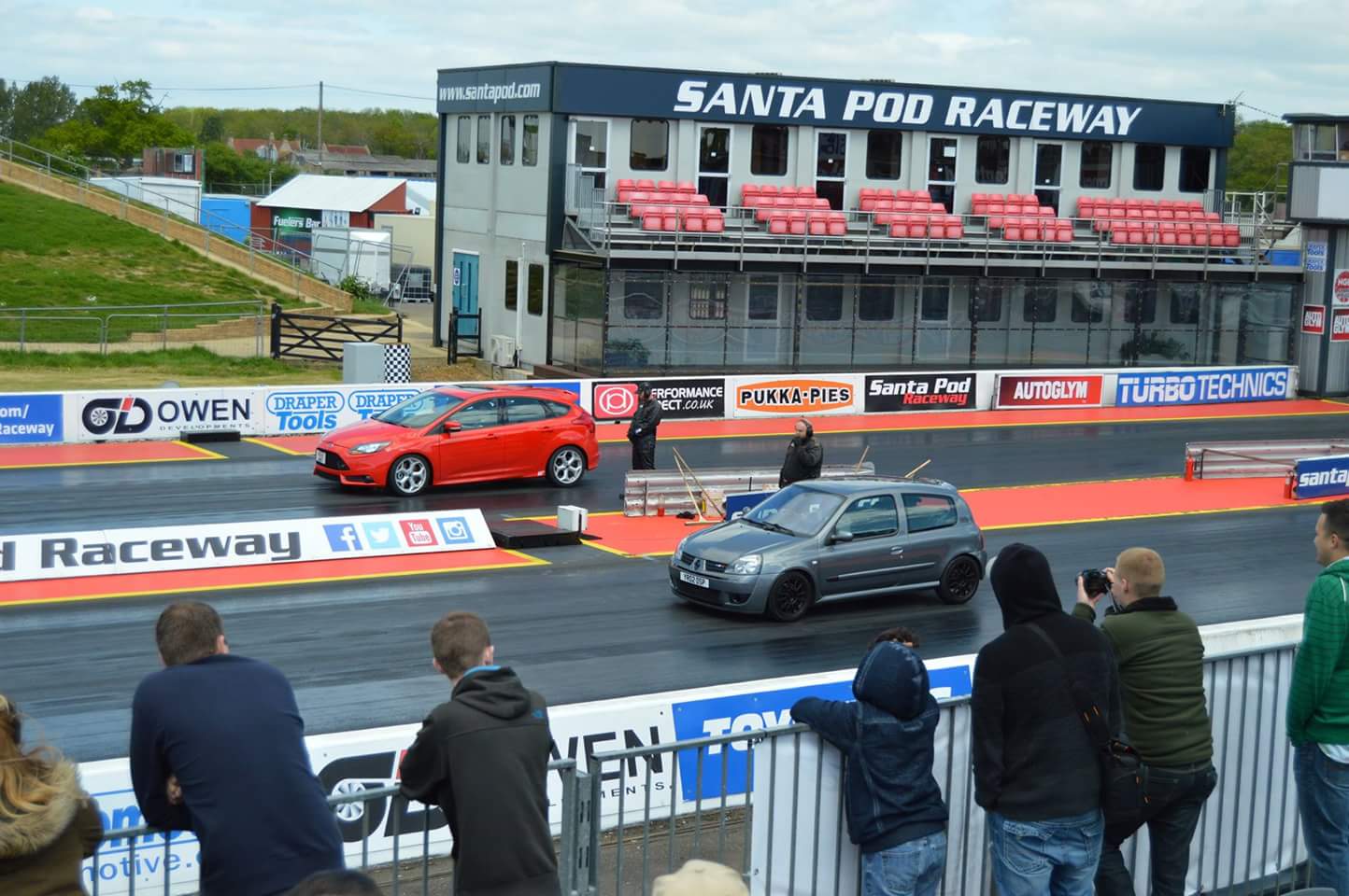

Took it to santa pod rwyb day with another club car decided it wanted to develop a missfire on way there not letting that stop me tho. Had a craking day only managed 15sec 1/4 abit poor but all time lost in first 1/8 heavy foot then miss on boost but hey ho great day out

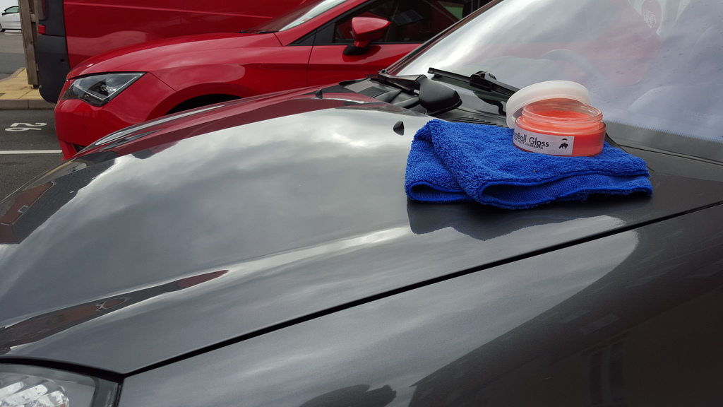

Then i decided to start up selling detailing products mix business with pleasure so to say and RadWax was born.
Then it was time for fcs nothing changed on the car so cracked on with getting it clean
Cleaned polished n waxed with madcow detailing products i sell.

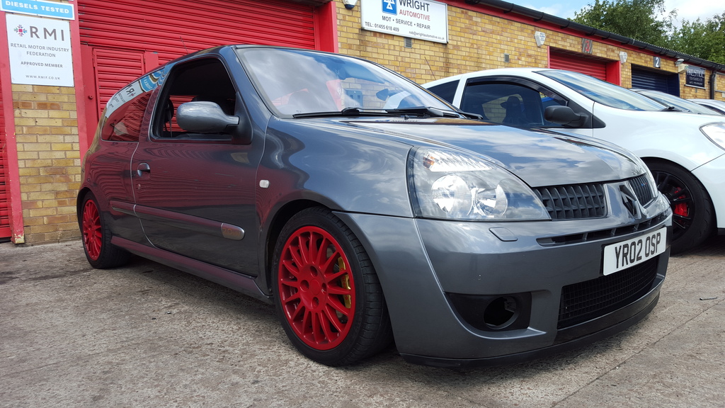

So took it to FCS was a craking weekend show was abit meh but enjoyed the company from rsuk guys. Car was once again faultless no issues and got lots of intrest over the weekend even met @Andyrg@ ClioTurbo for the first time. Photos went with my old phoneView attachment 134098
So good times

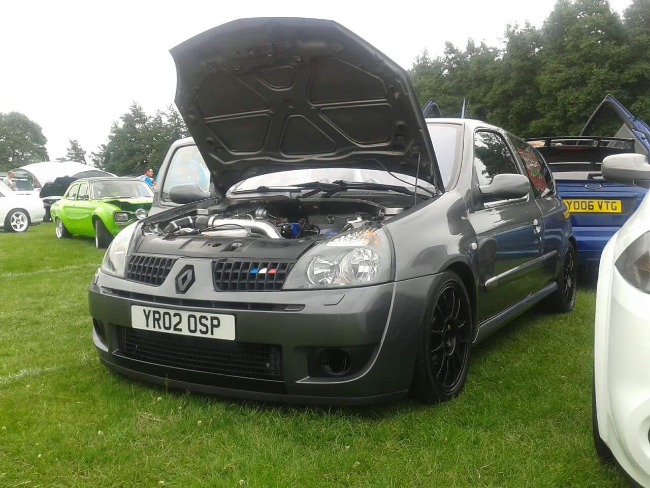

Still car staying the same next show was cars in the park what a show £5 to charity to enter loads of stuff there really good
Then it was time for Trax

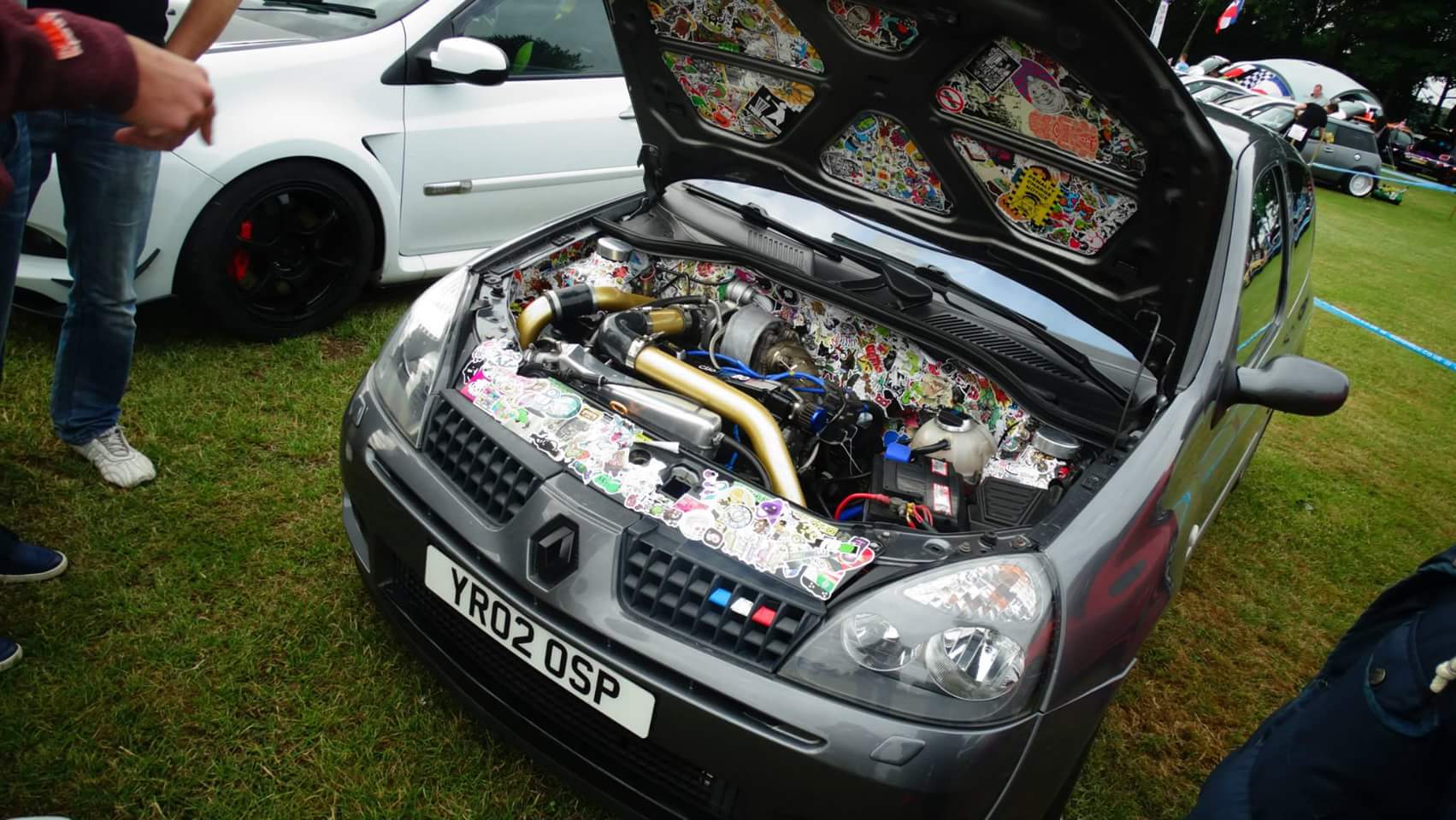

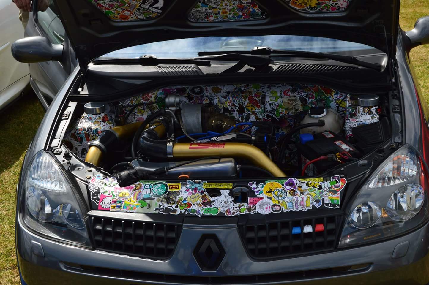

I decided my engine bay needed a bit of vava voom and being a big fan of sticker bomb i went about the bay. Also added a turbo blanket and 15meters of titainium exhaust wrap as the old stuff fell to bits
At trax
Only but im not keen on it the bomb on top grille which will be painted. Trax was a much much better show than fcs fantasic day out.

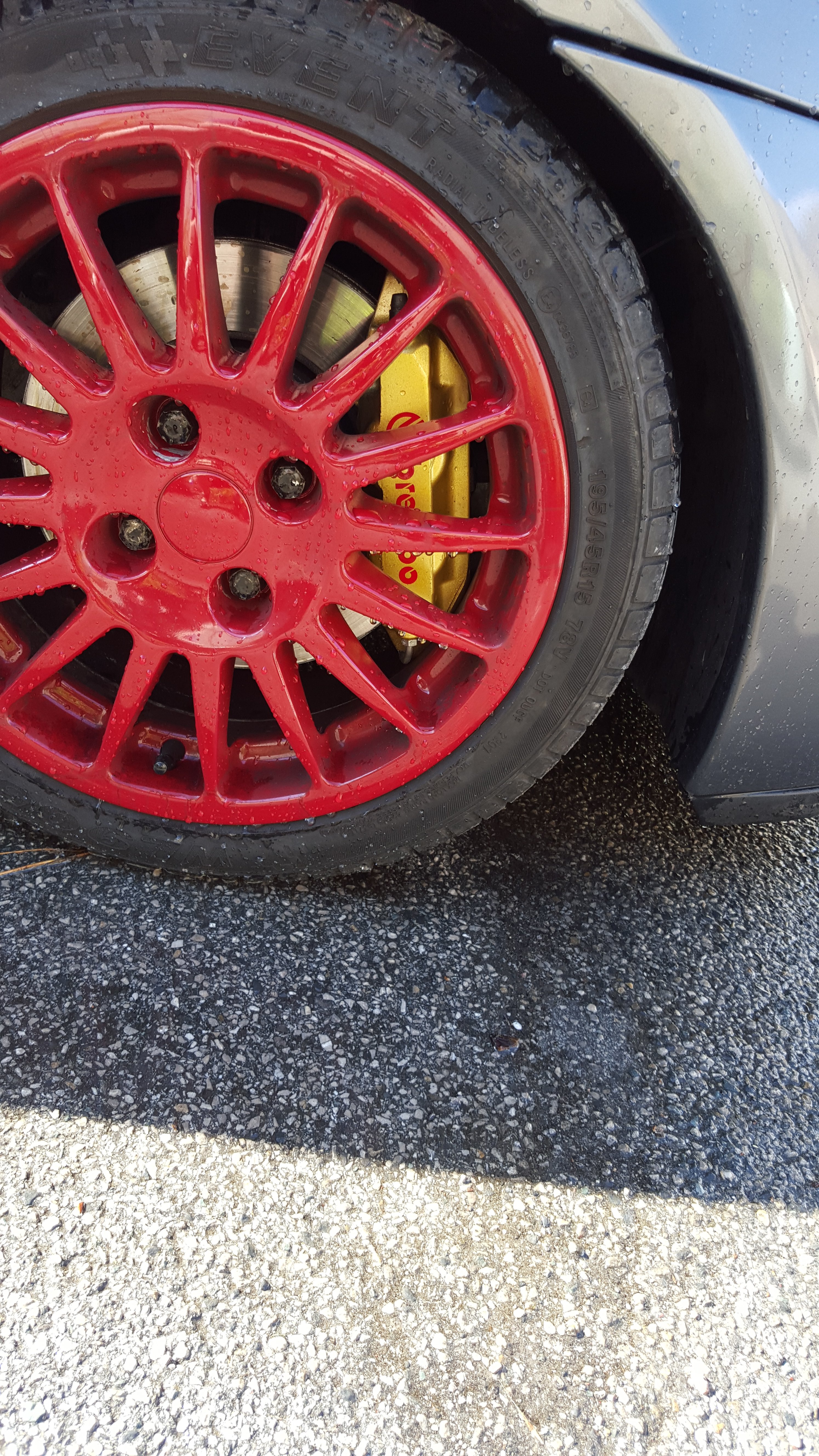

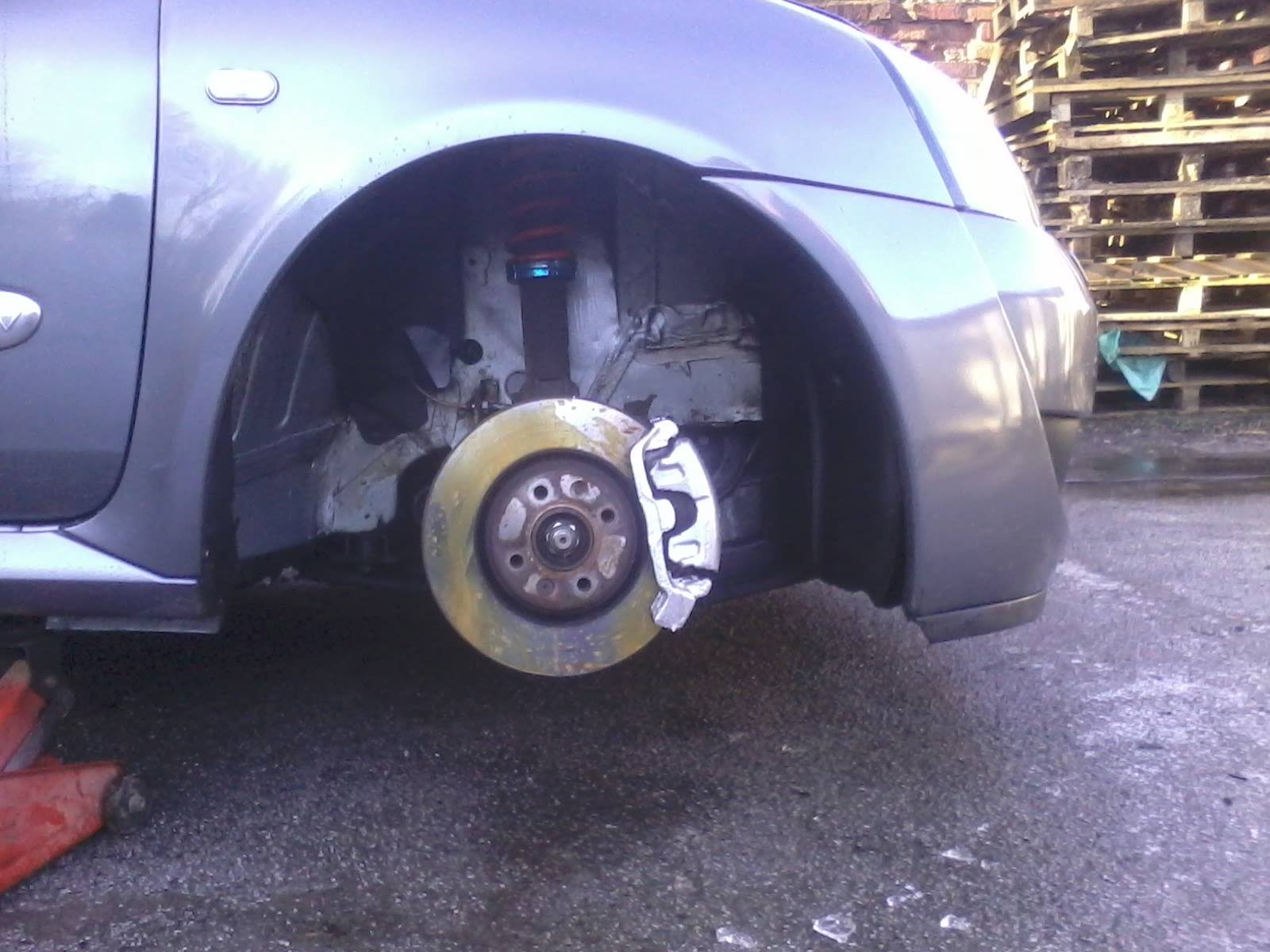

Ive joined the 15" crew and got myself a set of oz superturismo alloys. Ive also bought a set of brembos and set about sourcing the parts to make them fit (what a game). After 25mm spacers and loads of caliper machining they are on and looking fantastic. I aways knew i would need a brake upgrade on it tbh and as the car aint cost me anything its the first proper treat.
