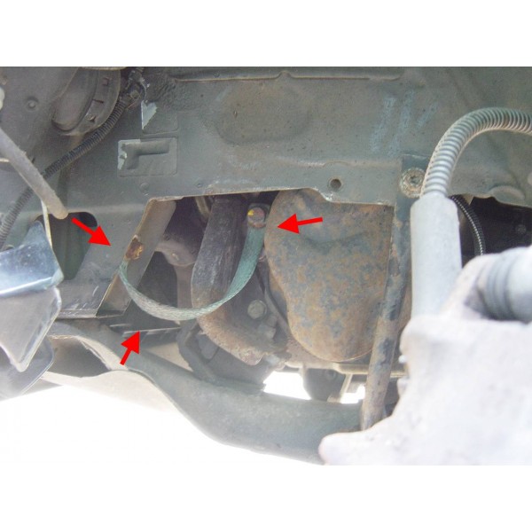

I'm struggling to check that earth strap but I've checked that the engine is earth at various points using my multimeter. So red lead on the positive terminal on the battery and the black lead touching the inlet manifold, gearbox, coil housing etc and each point I've tested comes back with 12v which must mean that it isn't an earth strap problem.
Is there anything else I can try?
  MG ZR x2, Polo, CTR
still need to check that strap.
There are a couple of earth points on the engine, but they need to be there.
I can't think of anything else you haven't already tried other than that.
Some one else may be along with an idea though.
  Clio 172
I've checked that strap now, quite easy to find once I removed the induction pipe and filter. The strap is intact and connected at both ends. I've just tried just a jump lead from the negative terminal to the gearbox just to be sure and still the same problem.

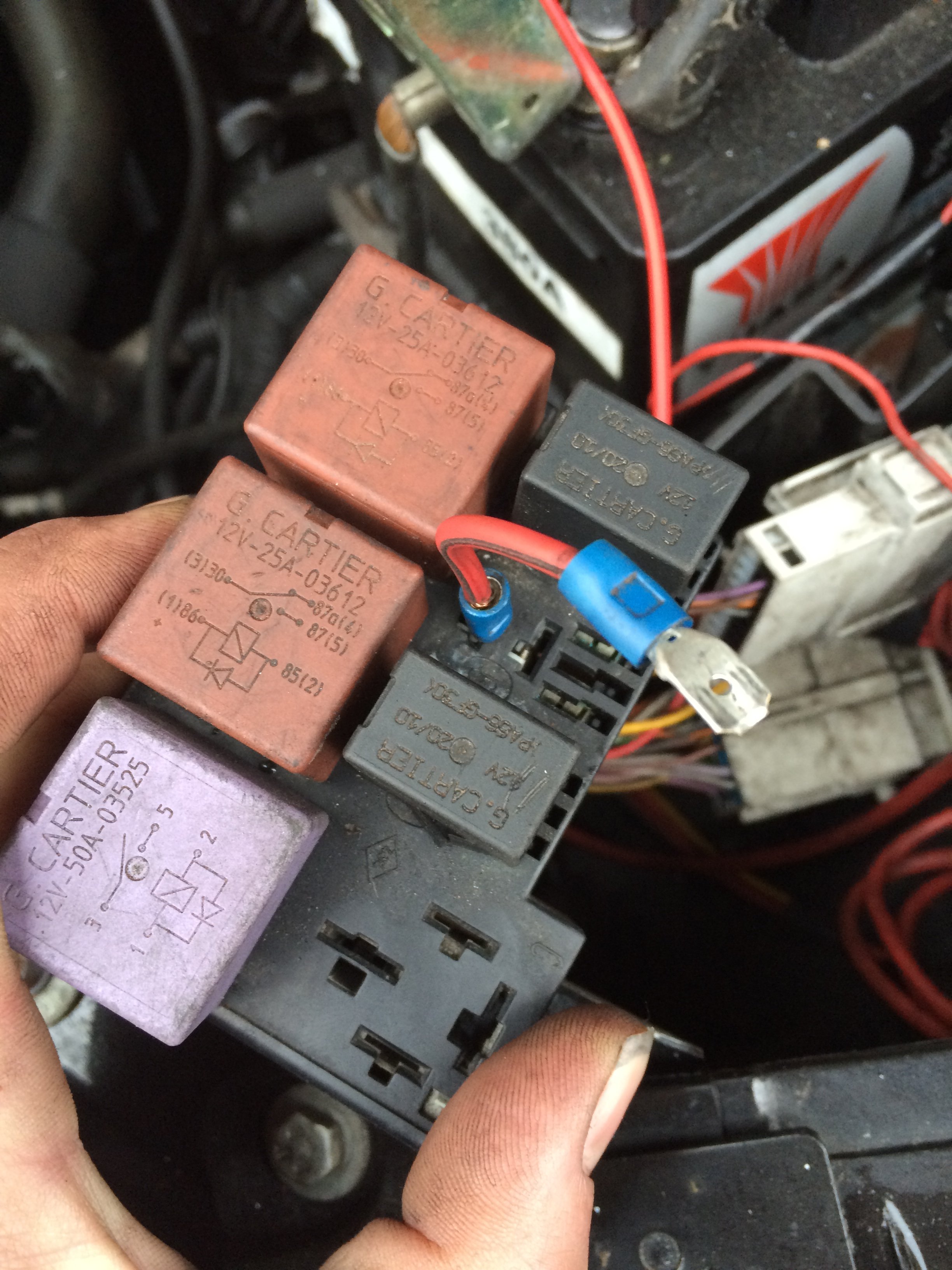

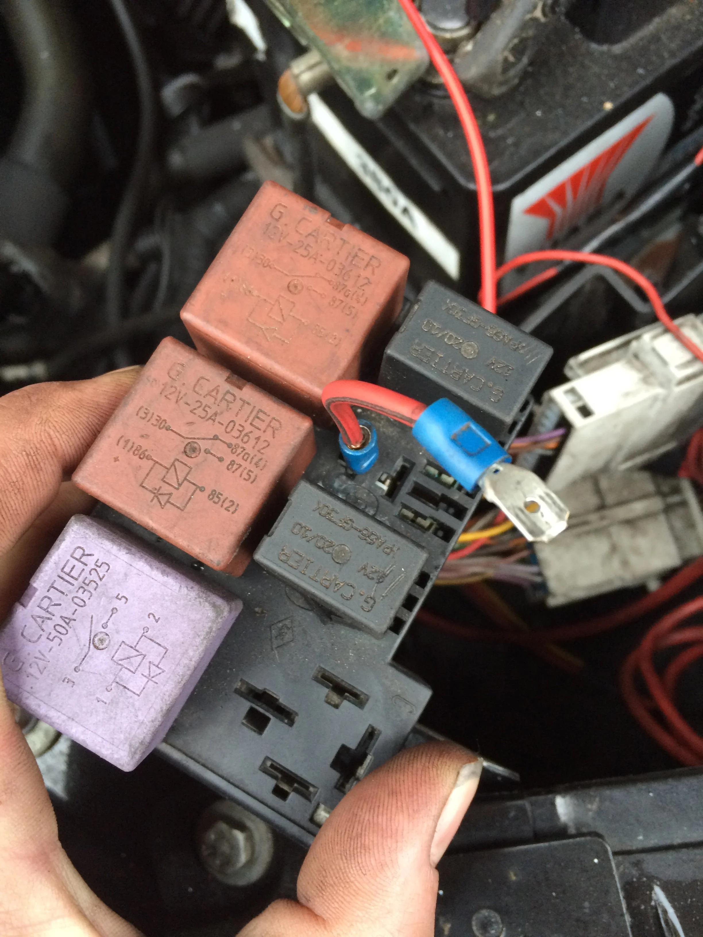

I've just tried bridging the connections between two terminals on one of the black relays in the engine compartment.
With the bridging wire as shown above, I get 12v showing on the multimeter. If I connect the other end to the terminal next to it, I get 0v. I have tested a few times just to be sure. I'm pretty certain it shouldn't be doing this (losing all voltage) once connected but I'm unsure how to proceed.
This is the braided steel strap behind the passengers side front wheel?

Had an auto electrician out today, he put the small black relay (middle one) back in, locked the doors, unlocked and it started.. Unbelievable
Tried to start the car again a few hours after he had gone, also after putting the induction kit back on and plastic fuse/relay cover and it wouldn't start again. I swapped the relays around, checked all the wires were secure but still nothing. Took the relays out and sprayed with electrical cleaner, put the relays back in and to much amazement it started. I've driven the car home, tried again and it starts. I can only assume the problem was to do with the relays and/or a loose connection in the relay box. I wish I knew for future reference invade it happens again.
  renault clio 1.4 16v
as i was reading i was thinking relays... glad its sorted mate, whenever my car starts getting grumpy i go through and clean all the sensor plugs and fuses relays...
