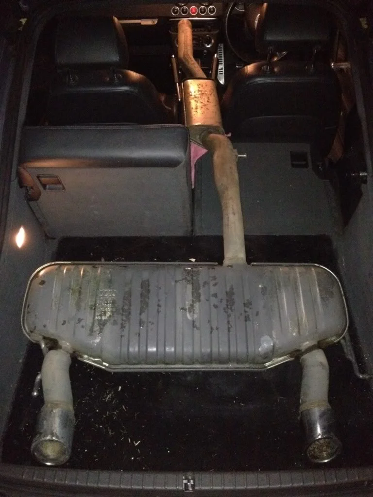

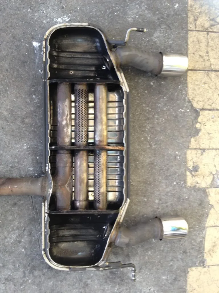

    I posted a while ago about about having a back box chop. I bought a spare exhaust from a guy who worked at pipeworx so i picked it up last week and sneaked it into work to have a little play. Heres where I'm upto;
    Perfect fit.
    [​IMG][​IMG]

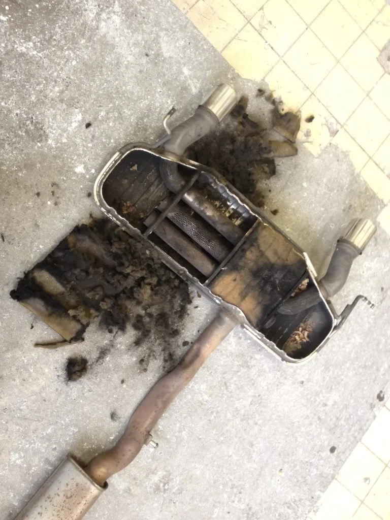

    Grinded the top off to reveal this mess.
    [​IMG][​IMG]

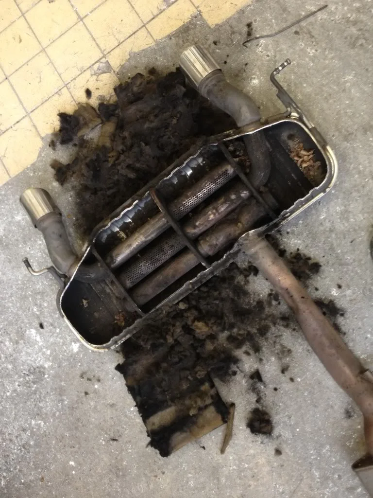

    Began to remove the glass fibre, horrible stuff!
    [​IMG][​IMG]

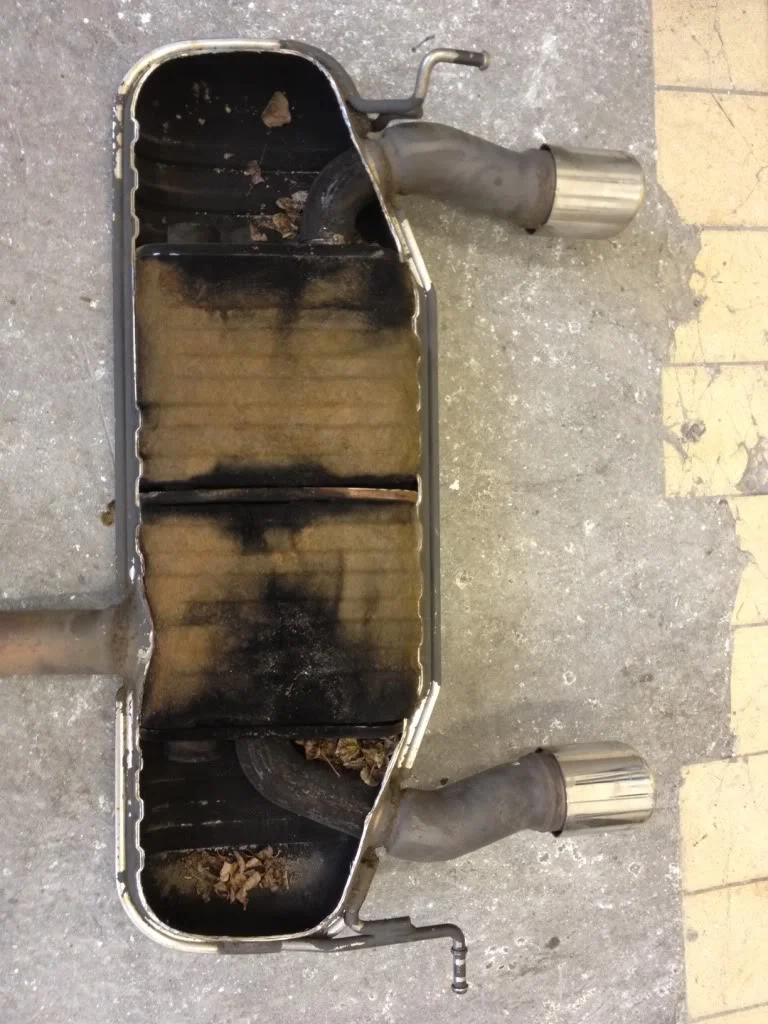

    All glass fibre removed.
    [​IMG][​IMG]
    I plan to remove most of the pipework and narrow the airflow to a single chamber but I'm quite busy at the moment. I would of liked it to be on the car by Monday as I'm booked in at RS-Tuning for a Remap.

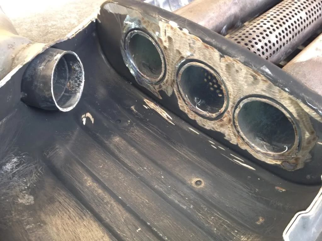

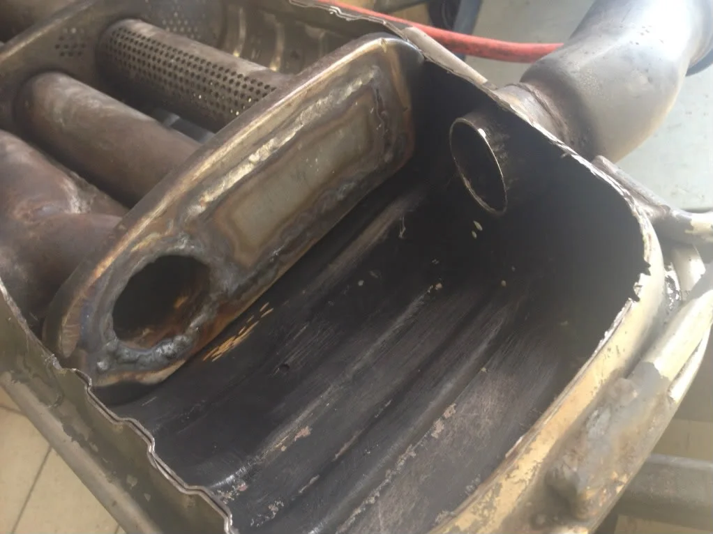

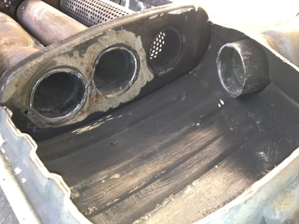

    Update: 14/12/2011
    I've been really busy lately at work and with college so I'll just post a couple of pictures so you can all see where I'm going with this. Enjoy!
    Cleaned! (sort of)
    [​IMG][​IMG]
    Pipes cut out both sides.
    [​IMG][​IMG]
    [​IMG][​IMG]

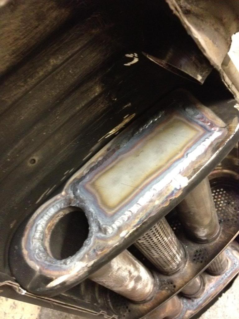

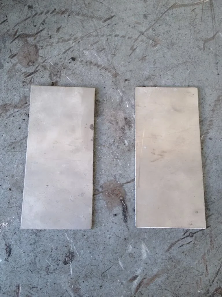

    Blanks cut out of stainless to block the four holes that wont be used.
    [​IMG][​IMG]

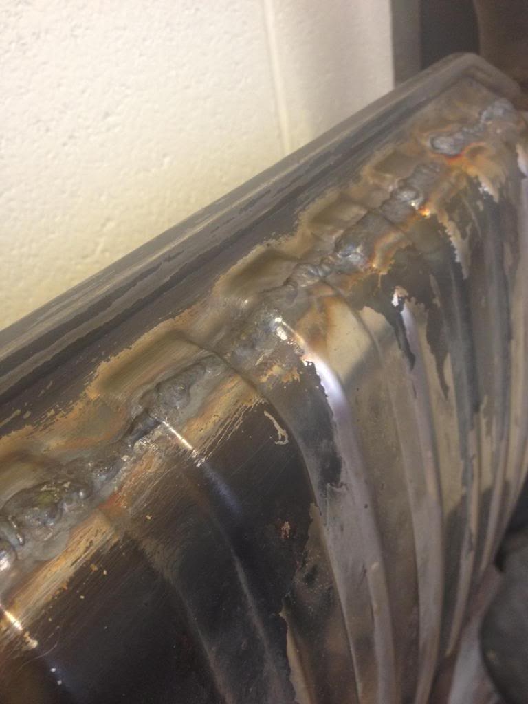

    Holes Tigged up on one side only. It was a real pain to get in at the back of the box, not my best welding ever but it was really quite hard considering the contents are made out of 1mm stainless. I had to weld at about 45Amps so it took me ages.
    [​IMG][​IMG]

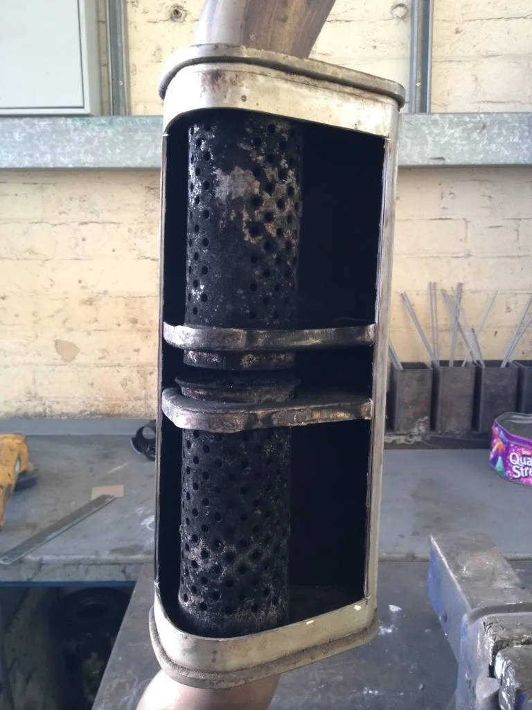

    I then opened up the mid box to see what was inside, I was thinking of doing a straight through pipe but it might be too loud. Whatever I decide, at least everyone has now seen what's inside these things.
    [​IMG][​IMG]

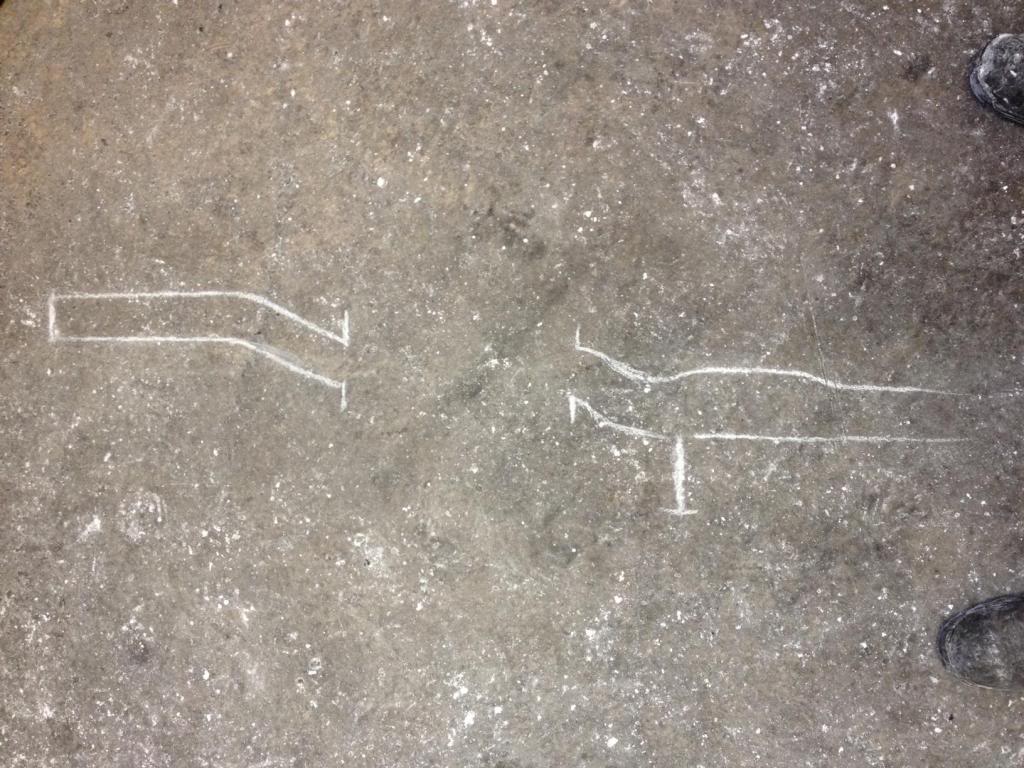

    Update: 19/12/11
    The back box is now welded up (to the best of my ability). I'm sure there will be a pin hole I've not covered somewhere but until it's on it's pretty hard to tell. I've now handed the whole exhaust over to a contractor in work as I can't weld the mid box back up. The stainless is too thin and to weld at 25 amps takes far too long.
    This means the mid silencer is being chopped out and replaced with 2.5" (65mm) hygienic pipe. Hope it isn't too loud :wink:... pictures to follow.

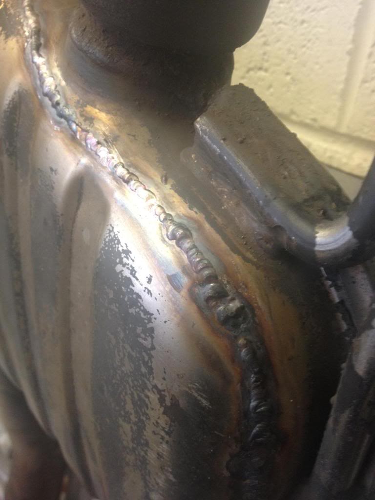

    Update: 20/12/11
    Completed the remaining side.
    [​IMG]
    Back Box welded up.
    [​IMG]
    [​IMG]

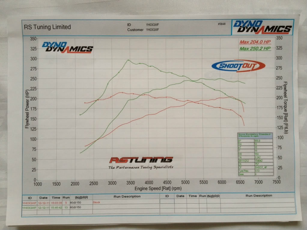

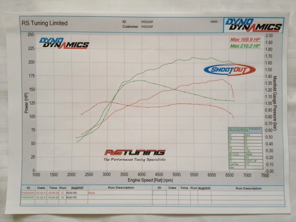

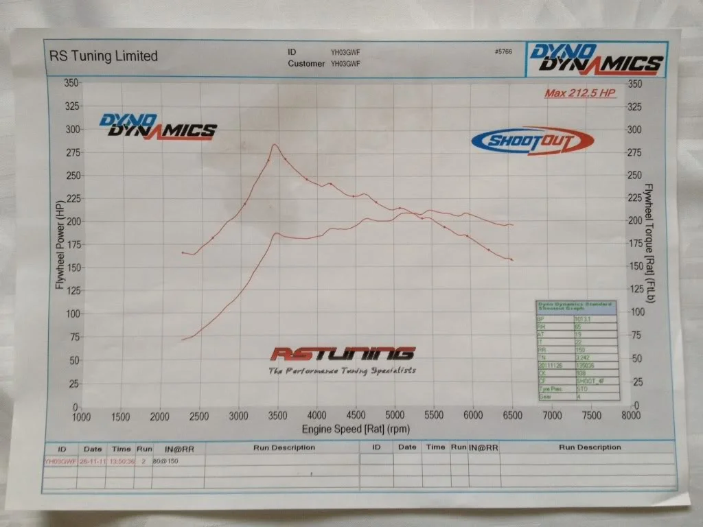

    Update: 28/12/11

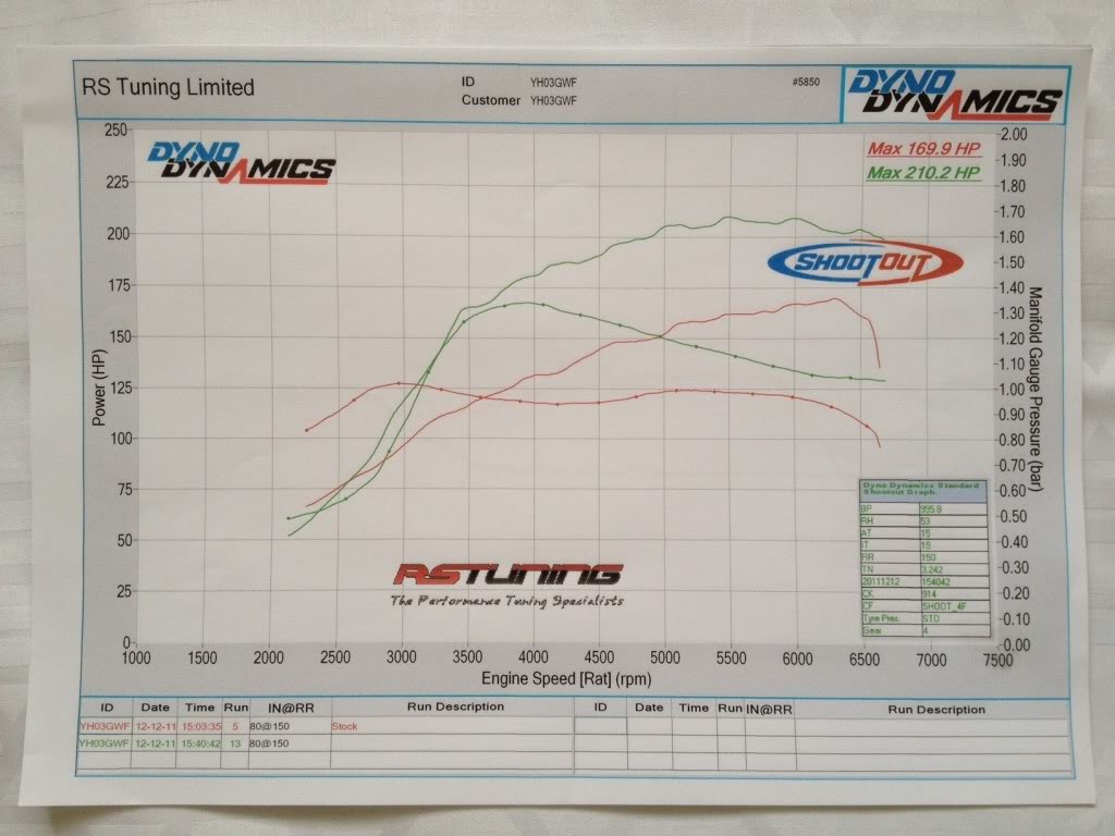

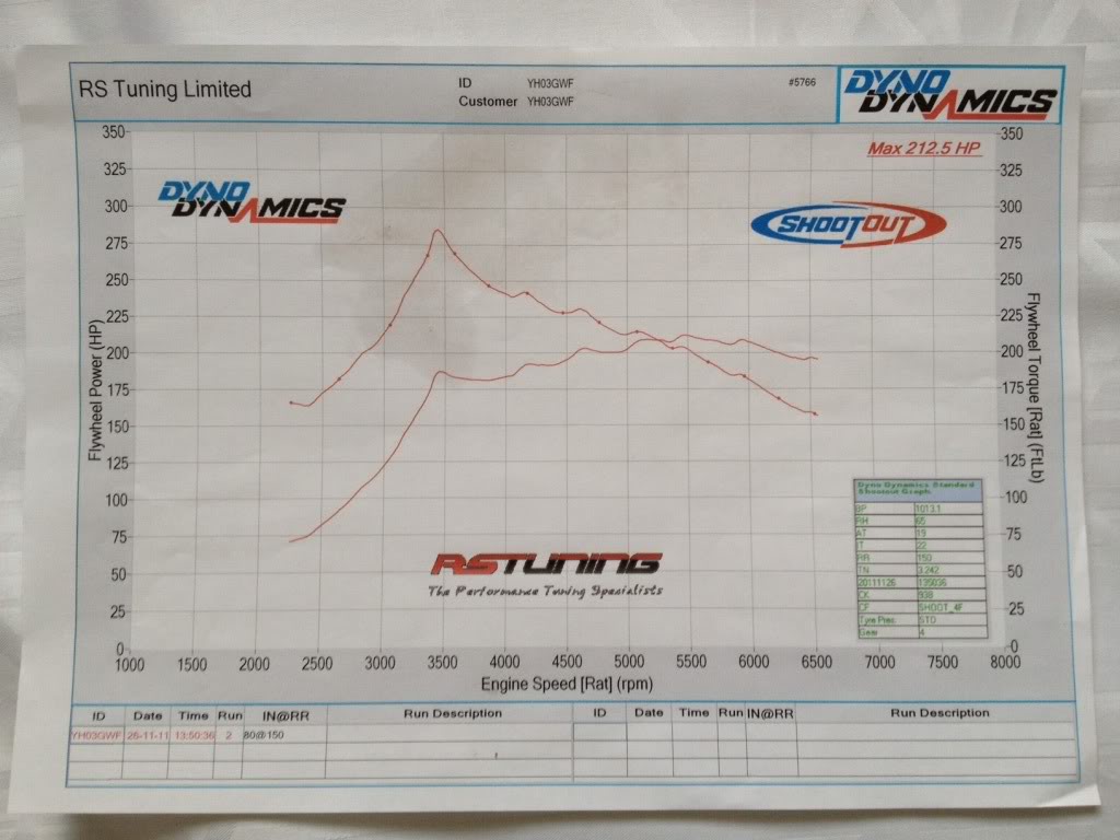

    Still waiting on my exhaust to be picked up from work! I thought I'd upload some powergraphs for you all from our recent trip to RS-Tuning. Very happy with the figures after seeing how bad my original powerfigures were.
    Graph with old map. (I didn't even know it had one)
    [​IMG]
    Graph with bad map again measured a month later than the one above. Measly figures.
    [​IMG]
    Graph after a few different maps had been put on and tested. Standard vs New!
    [​IMG]

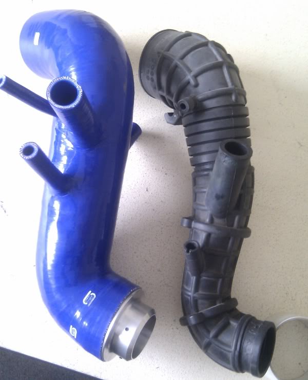

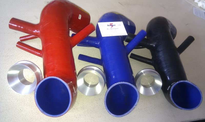

    I have also been looking into this Turbo Inlet Pipe (TIP) from Badger5. It's 3" from the MAF all the way down to the turbo to help with feeding in as much air as possible. People on Audi and Seat forums have seen 20-30gsm of air increase and people have results of 9-12bhp increases despite Awesome-GTI claiming a 20bhp increase. Still, not bad for £150.
    [​IMG]
    This picture is comparing the Badger5 TIP to standard. As you can see its HUGE!

    A tip doesnt feel to make a massive difference but you do feel an improvement higher in the rev range.

    Do you have/had any experience with a Badger5 TIP Tom?

    Yep on my old Bora. Bill mapped my car too. Like i say, they make a difference and you do feel it.

    Have u fitted the badger5 tip ? Also did you go Awsome today ? I wasn't sure weather they were open over Christmas and the TT forum seems to be down for me

    Listening to alot of peoples opinions they seem to rate it as a worthwhile mod.

    You're right! Did you have the V1 or V2 of this product Tom? Apparently the first version changed diameter from 3" at the MAF down to 2.5" where as the second version is 3" from the MAF all the way down.
