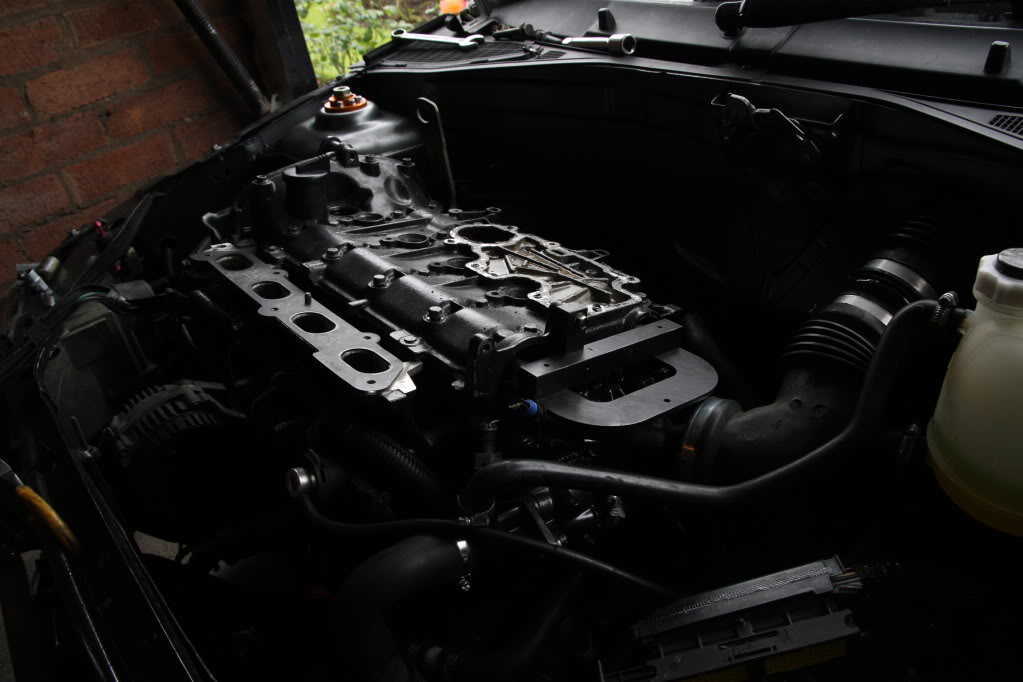

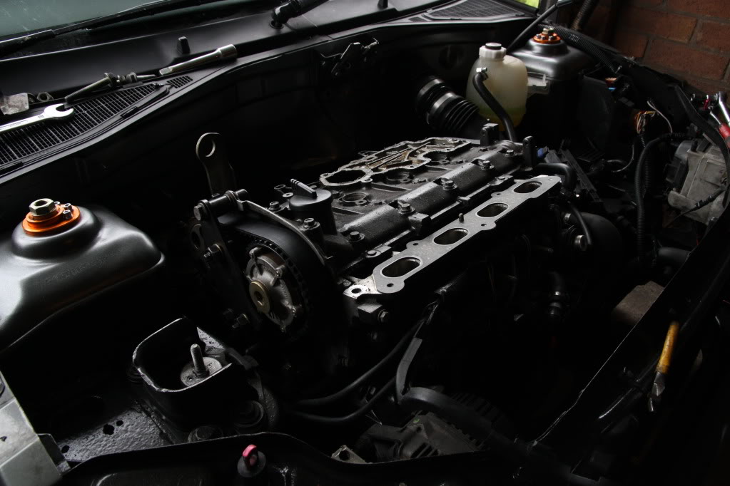

  4. f0xy
    f0xy ClioSport Club Member
    Joined:
    May 22, 2006
    Messages:
    14,961
    [​IMG]
    Camshaft locking tool^
    [​IMG]
    Pulley locking tool^
    Dark pics but you can make it out just about.

  6. mark123
    mark123 ClioSport Club Member
    Joined:
    Oct 20, 2005
    Messages:
    2,627
    Location:
    Newbury
    Car:
    172 race, 250 meg
    I think he just means the cam pinion locking tool (85 quid Renault only), which is shown in the second picture above. Plus the cam timing tool shown in the first picture.

    Yep, the cam locking tool. Both the tools shown in the pics plus the pin to lock the crank.
