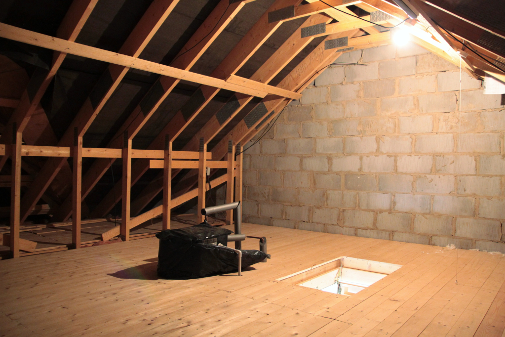

It's the header tank.
Convert it to a sealed system.
Drain down the heating circuit, pipe in an expansion vessel, pressure relief valve/gauge, filling loop and you're away.
It really is simple, and IMO you'd benefit in the long run, not only for the space saving but it's a more modern system, easier to keep an eye on for leaks etc.
