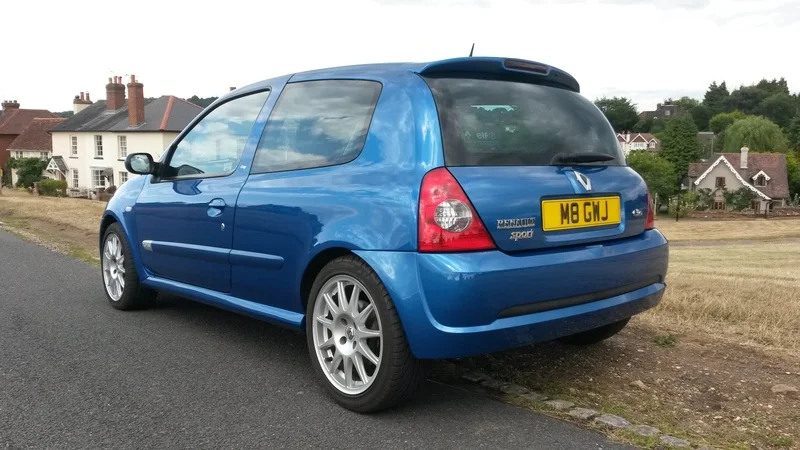

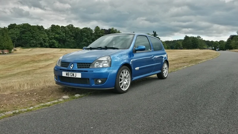

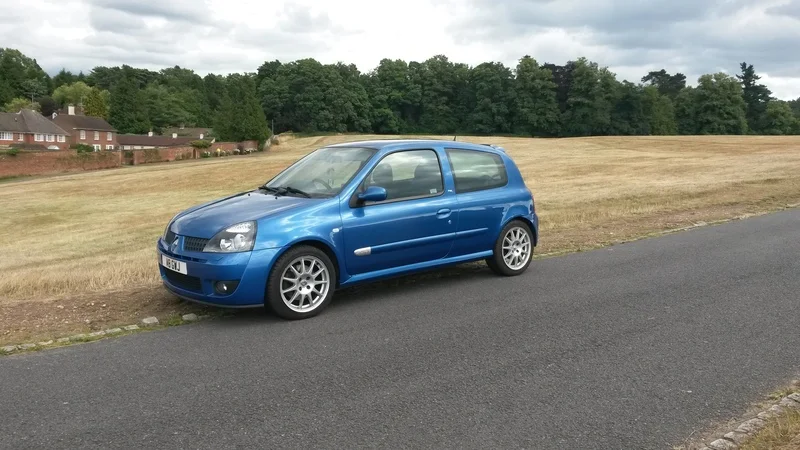

This is where the car stands at the moment:
I brought the car just over a year ago with about 68k on the clock. It was in good condition but needed a few things sorted. I’ve got an ever growing list as long as my arm of things that I’ve done or need to be done, not all because it needs to, but because I want the car to be as good as it can be.

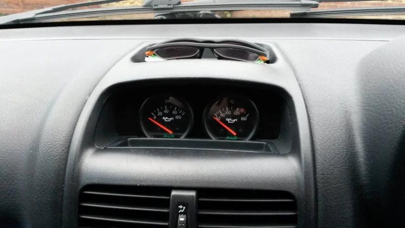

In prep for the day i have installed an oil pressure and oil temperature gauge in place of the clock/radio display. I haven't put the engine through any sort of stress like its going to be on Sunday so it'll be good to keep an eye on what its doing. Ill get some better pics when i can but this is how they came out.

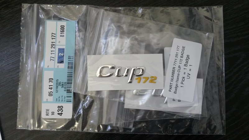

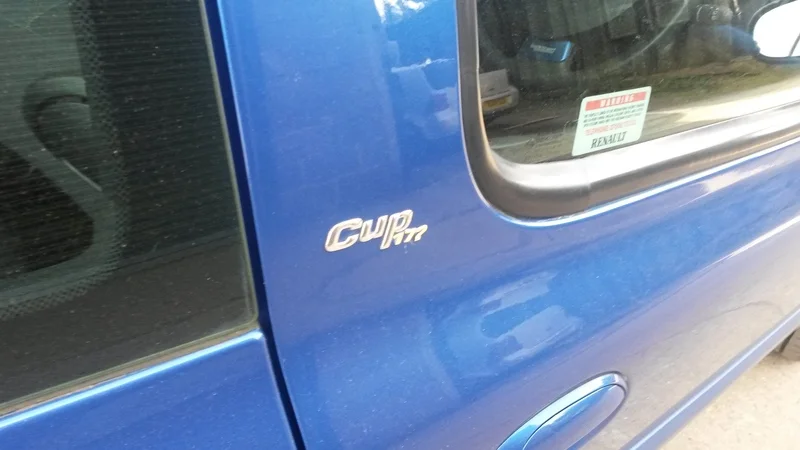

Ive also bought some 172 cup stickers for the door to replace the old ones that are falling apart
massiveCoRbyn
  Several
How much were the stickers? Mine have been replaced at some point but they put them in the wrong place and it's really bugging me!
They cost £28 delivered from Renault
Great work, i like what you have done with the gauges.
Thanks. It took me ages to work out where to put them as i wanted to put them in a place where i could remove them without defacing the dash. Also they were easy to wire up where they are.

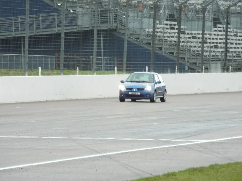

Better late than never! Ive got some of the photos at Rockingham uploaded:
The first session in the morning was sooooo slippery. It was like driving on ice and the car was very tail happy but it was so easy to control, very impressed with the car and how it went throughout the day. Need to book another trackday now, preferably one thats dry! Got a list of a few things that need to be done but nothing serious. :up:
I've put together a few bits of the track day of me sliding around in the morning. It was very slippery, which, I expect didn't help with the choice of tyres I had on the car - Goodyears on the front and ditch-finders on the rear! It was a great way to find out how the car handles due to the slower speeds that we were doing as this was the first time I have driven a FWD car on a track.
How did you install the oil guages? Fancy writing up a guide?
All i did was cut up the clock surround and put a metal plate to hold them in place and wire them up from there. It was pretty easy. I will see what i can do. Ill have a look at the pics ive got to see if theres enough there to do one.

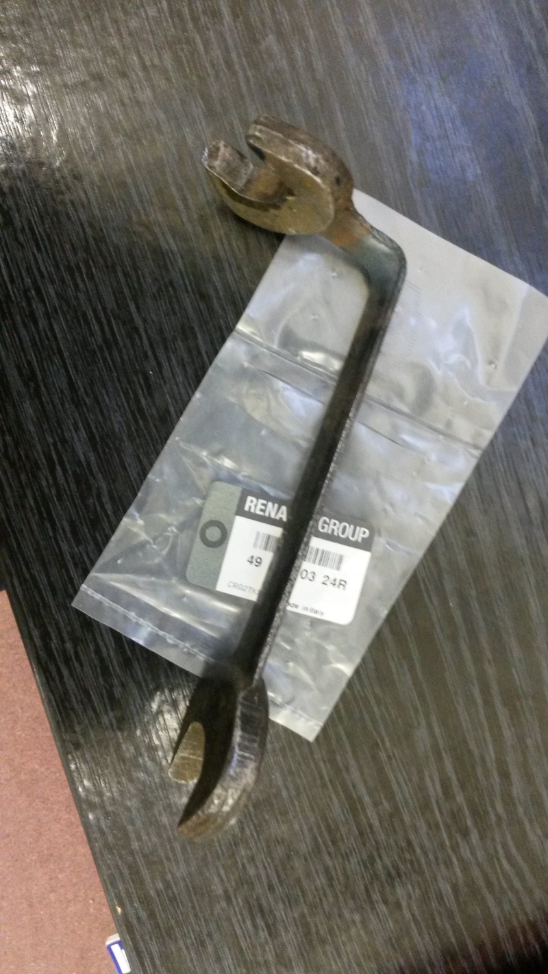

Just a small update as not much has been going on since the trackday. I had to replace the power steering pressure switch as it was leaking fluid everywhere and making a right mess! As it was a right pain to get to i had to improvise with the tools that i had to hand:
It worked well and done it in no time

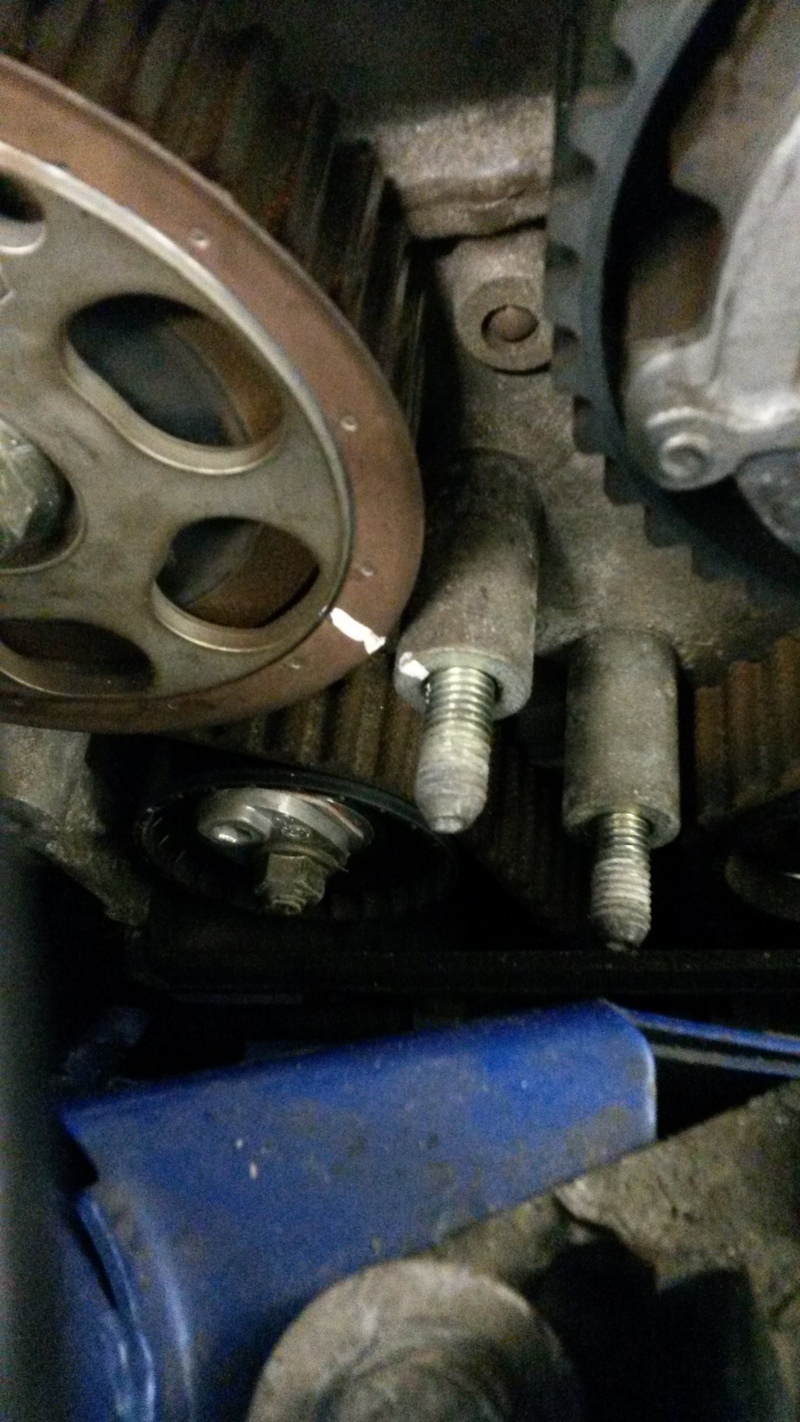

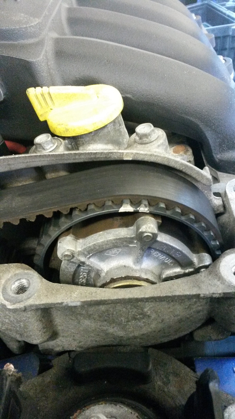

I went to have a look at the cambelt the other day, as i checked it a while ago whilst trying to diagnose another fault. I used the proper Renault timing tools to check it so i knew that it was out but now i know why. This is what i found:
Tippex! everywhere! it was also all over the crank pulley! :rage:
Anyway, ive now done it properly and runs so much smoother.
