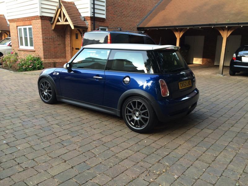

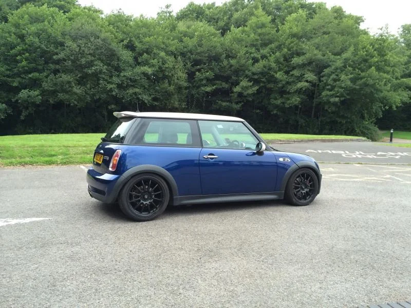

From his list, the current spec is as follows:
1320 Mynes Tune, Newman Cam, 450 injectors, 15% Pulley, Dave.F, GRS 'Motorsport' intercooler, Milltek cat-back.
R56S front Calipers, Nitrac 294mm 12 groove discs, MintexM1144's, GoodridgeSS hoses, Castrol Response Super Dot 4.
MeisterR Coilovers, V-Maxx F.droplinks, OMP lower brace, rear bench brace, Powerflex bushes.
17" TD Pro Race 1.2 with Vredestein Ultrac Sessantas 215/40/17s
Black beltline, 17" TD Pro Race 1.2 with Vredesteins & 16"s with T1R's for track, HALOs, aero grill, stubby aerial.
Scanguage 2, CG Locks.
As such, so ill be mostly fine tuning the suspension, changing some interior parts (chrome be gone) and fitting the works kit.

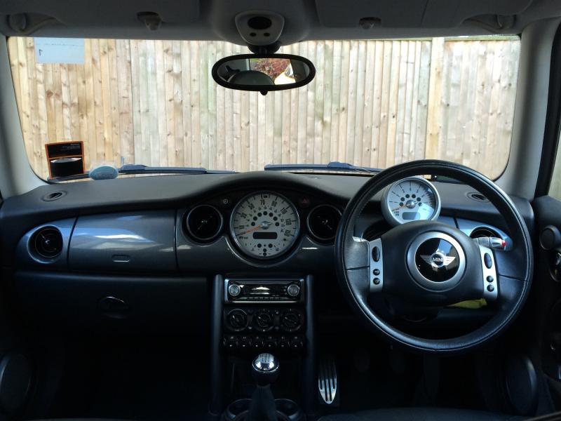

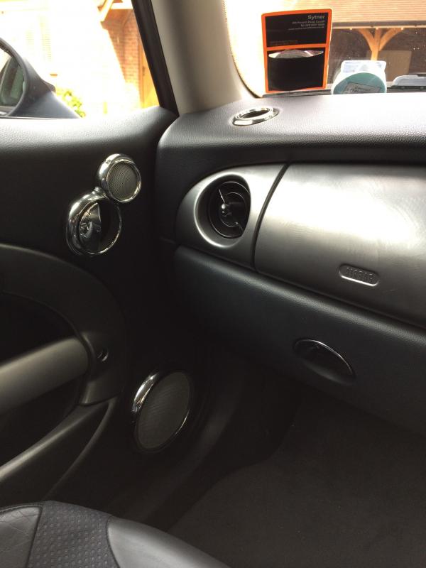

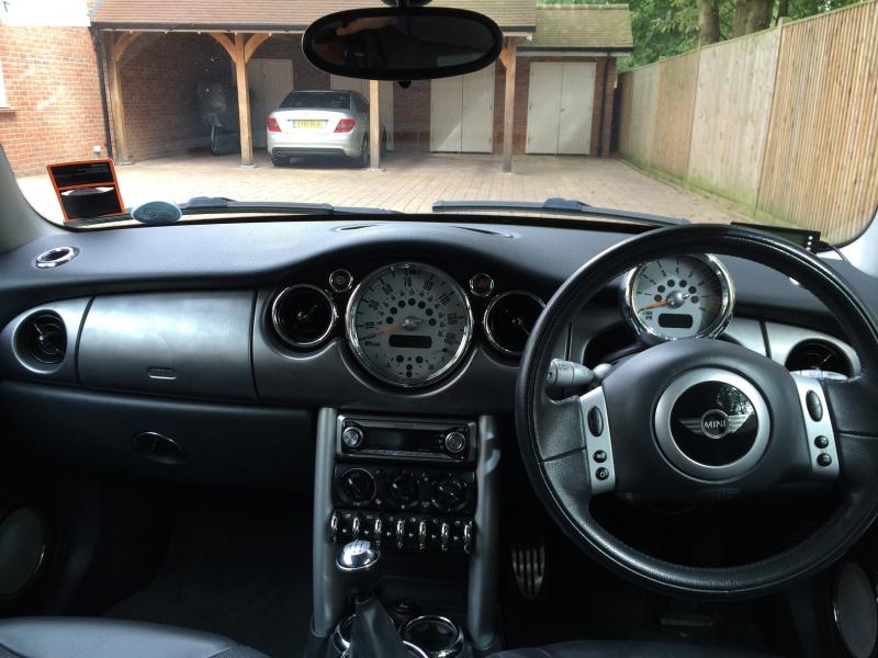

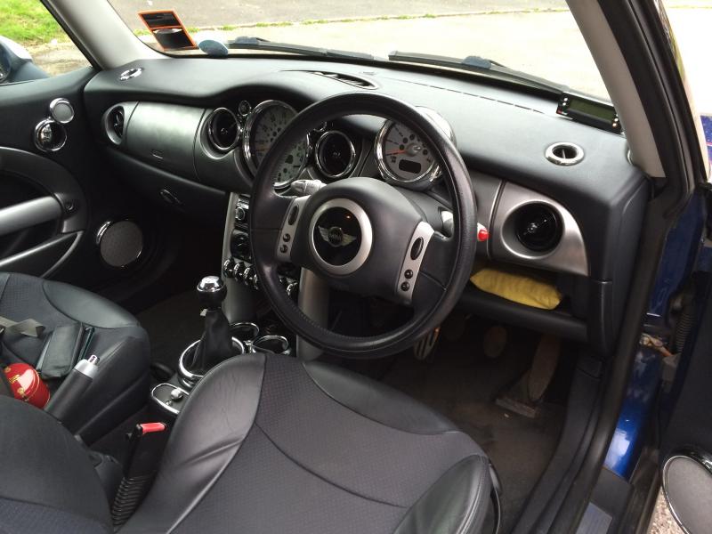

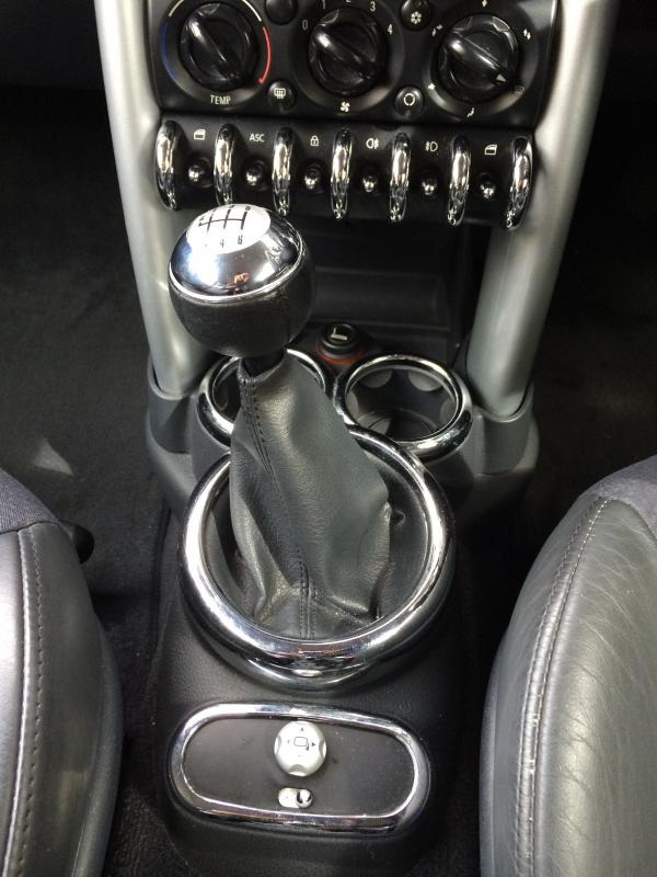

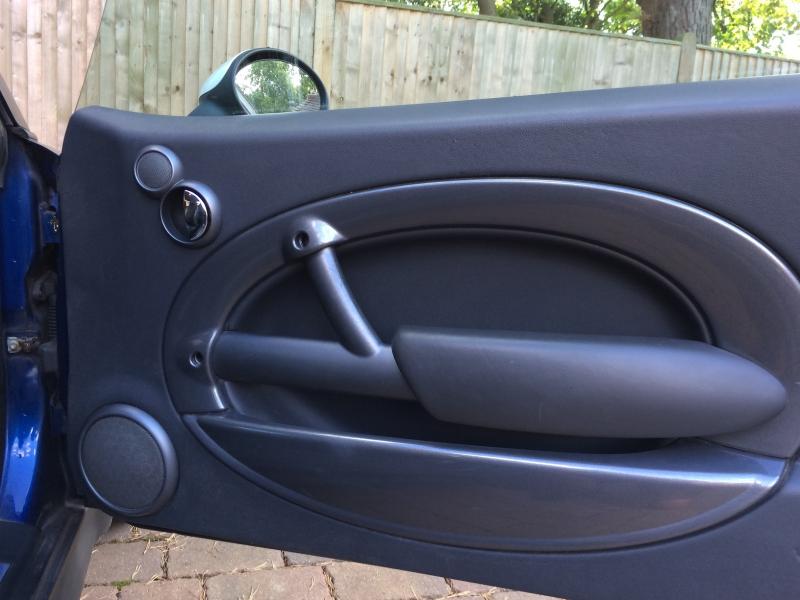

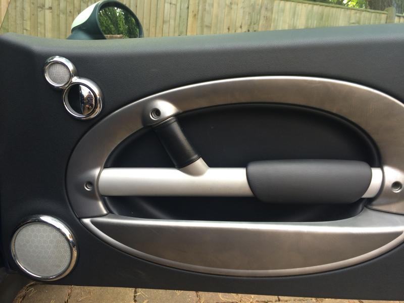

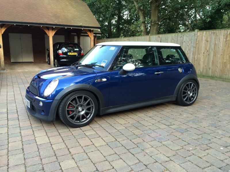

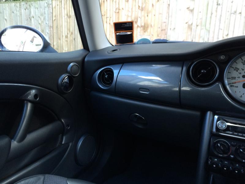

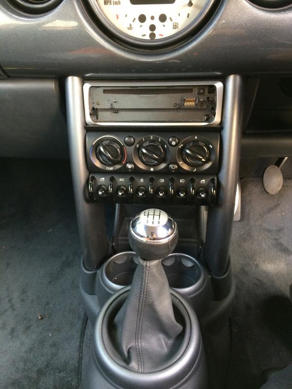

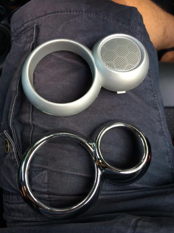

First up was the interior. Firstly as it just felt like i was driving around in Richard's car all the time, & secondly, because quite frankly, chrome can die in a fire :dead: As such, id bought anthracite dash trims (think these were fitted to the mini one), along with some facelift doorcards, to replace the whole lot. Needless to say, when i found that all the chrome was just stuck on, i cried a little, as id wasted a little money, but alas, i prefer the darker colour anyways. And the GP was silver, so always nice to try different things ...
As such, lots of before/afters:
And the offending stick on stuff :quiet:

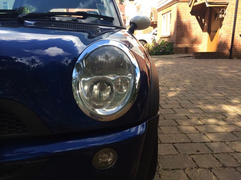

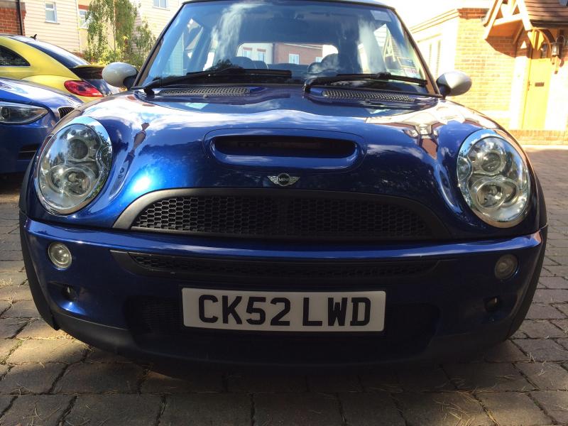

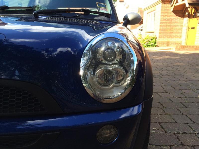

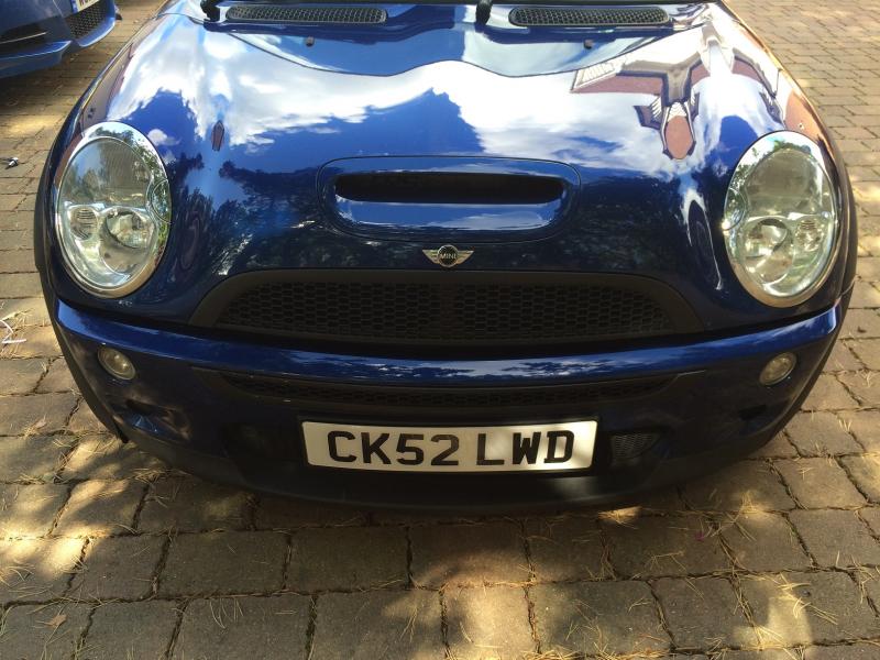

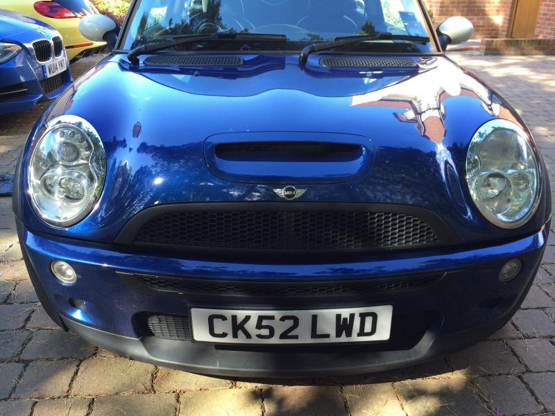

Next up was replacing the standard candles at the front end. Yes, the pre-facelift are xenons, but slighter older "technology" so facelift ones were sourced to improve my ability to see at night. Really easy to swop as well, hardest bit was getting the old headlight rings off without breaking any of the stupid clips!! Slight panic when the drivers side one didnt work, but refitting a loose wire soon solved that problem :eek:
Before
During
Comparison
After

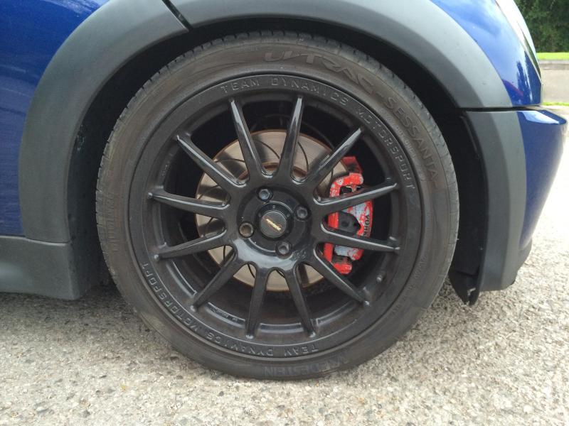

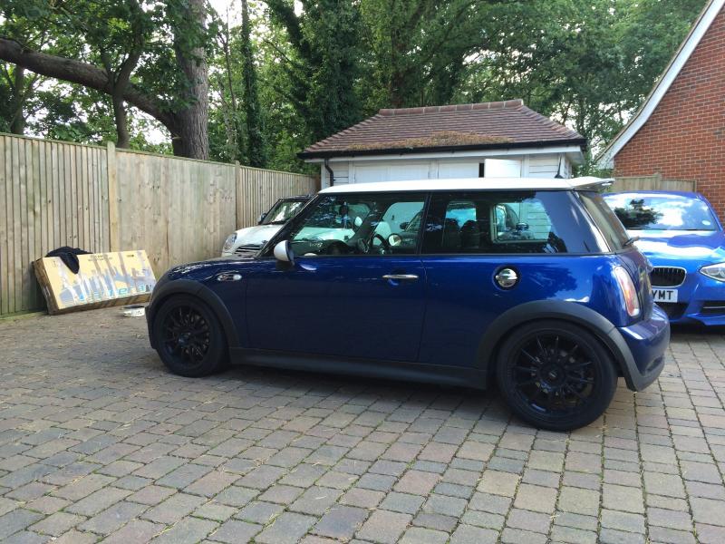

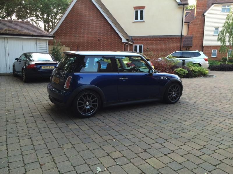

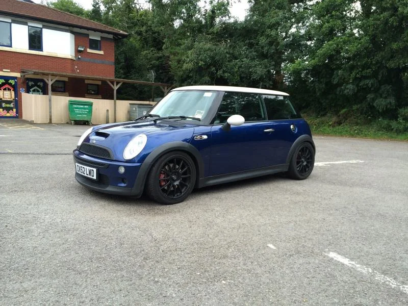

Next up i wanted to fit the turinis, but as the car is currently slammed on 215/40/17's and they have 205/45/17's there was no way they were ever going to fit, not without raising it up a bit first, which i didnt have time to do :dapprove:

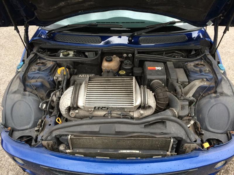

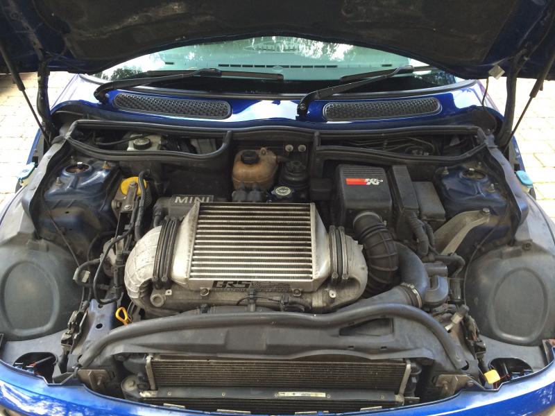

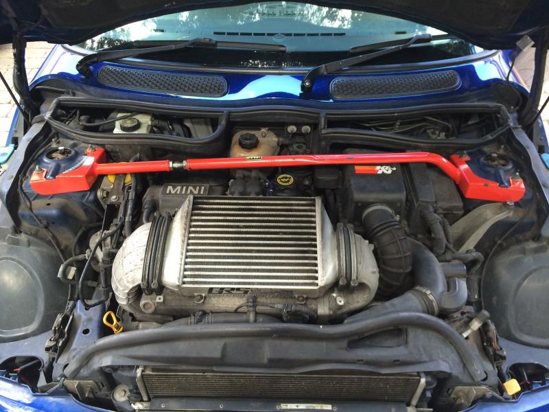

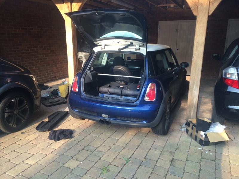

Final bit fitted was the OMP upper strut brace, probably doesnt do much, but certainly brightens up the (in the need of a clean) engine bay! Lower one is already fitted, as Sarah & I bought it for Rich years & years ago for xmas one year. I know its still there as it scrapes on everything.
Next easy things to fit will be the facelift rear lights, my private plate & JCW style facelift steering wheel when i get it back from the trimmers, then onto the rear ARB, camber arms, sorting the coilovers (need re-adjusting for pre-load/height/damping etc), then fitting the wheels.

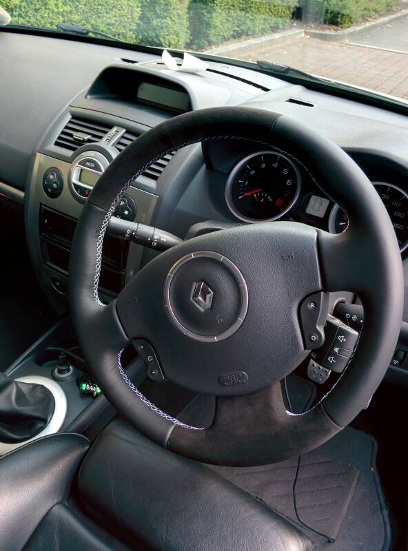

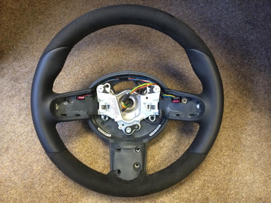

Funny you should say that, impatience has got to me (retrim cant be done for another couple of weeks), so i just bought another of these:

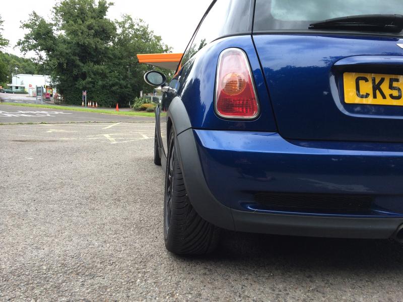

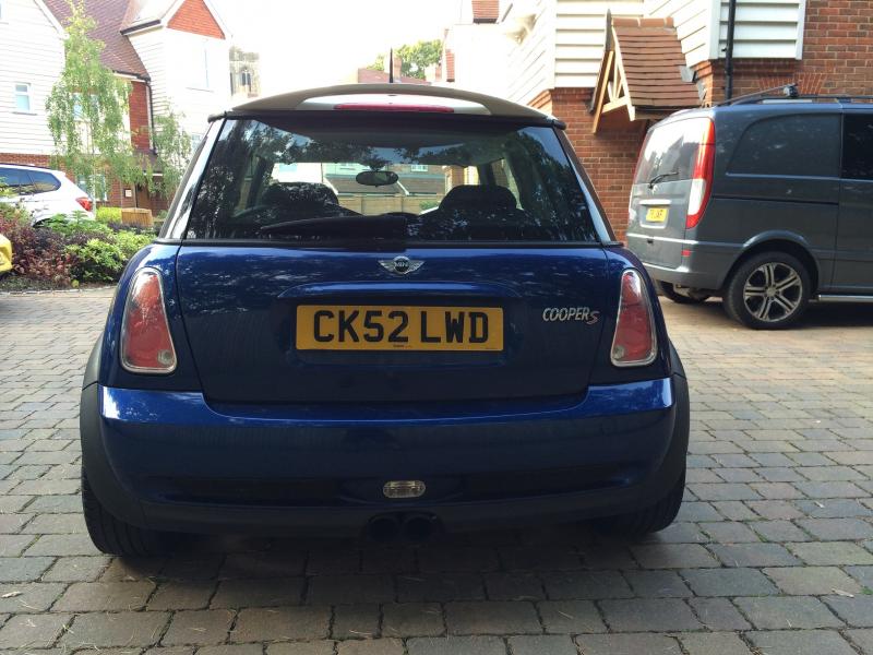

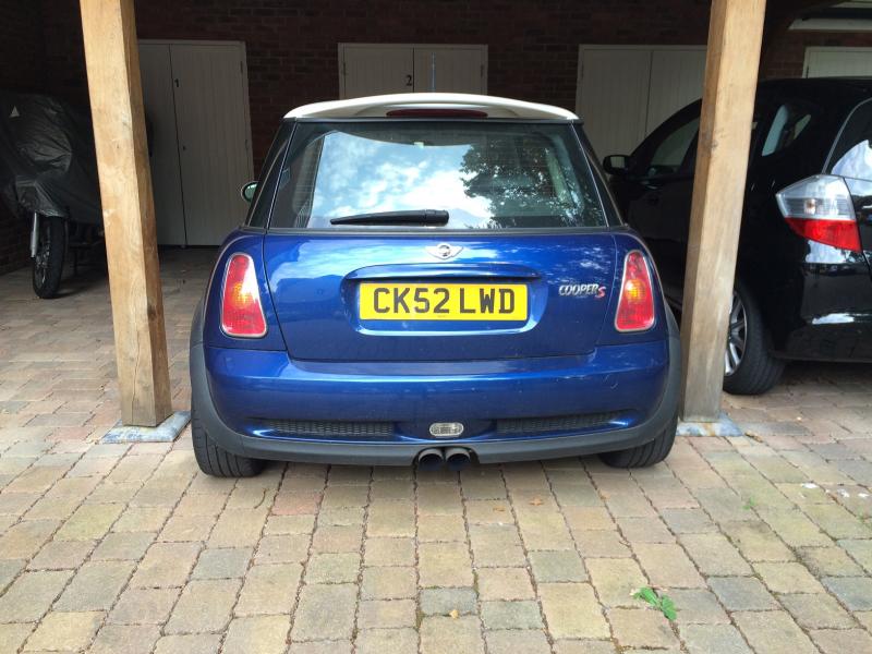

First up was the facelift rear lights, look a little nicer, bit brighter etc. Small amount of wiring changes required as per: http://www.mini2.com/forum/first-ge...er-s-rear-lights-2005-lights.html#post1200693, but hey, that adds to the fun. Just need to buy a clear red fog light bulb now, as my "new" fog light used to be the reversing light, so is currently white lol.
Before/During/After

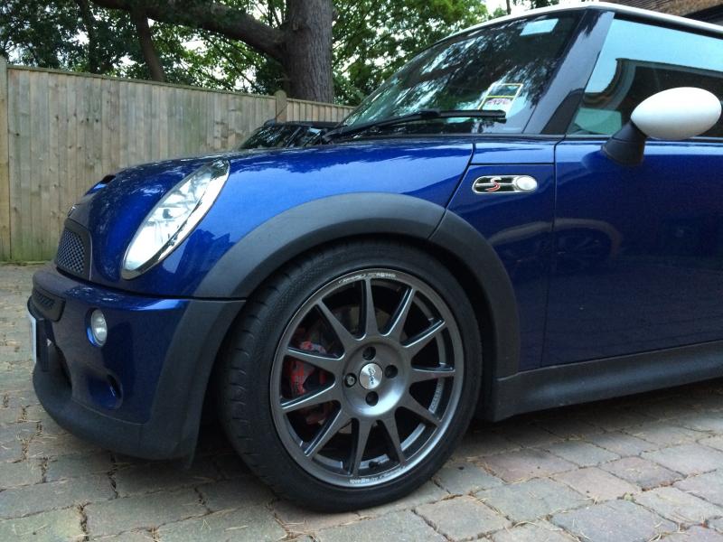

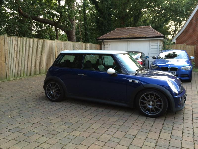

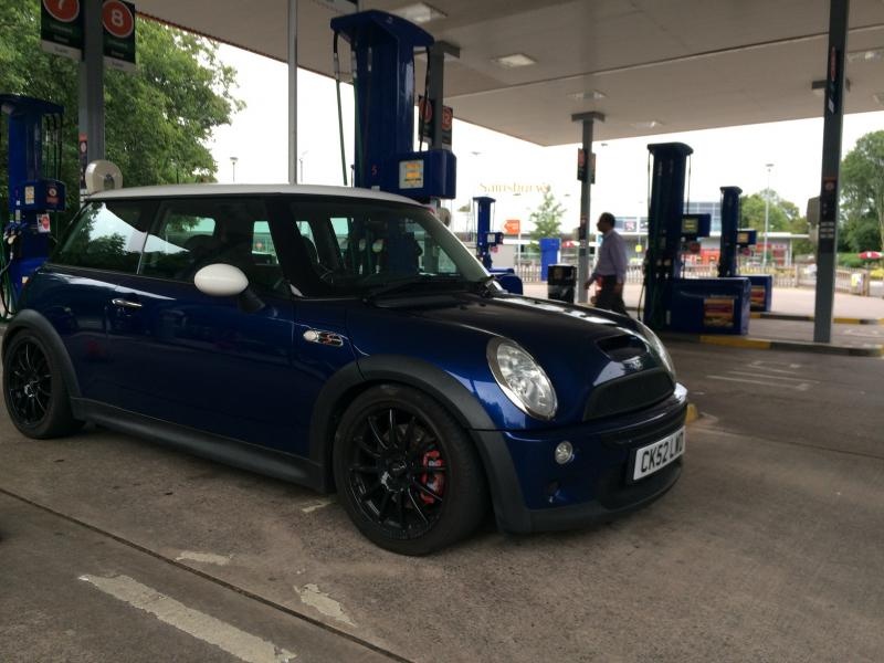

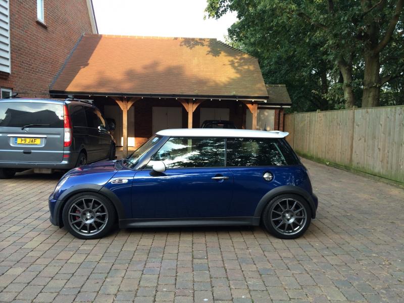

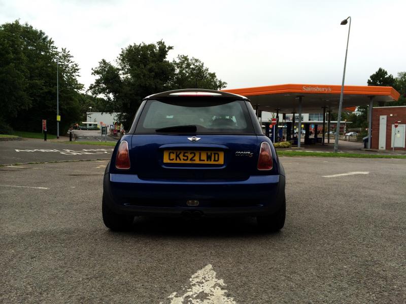

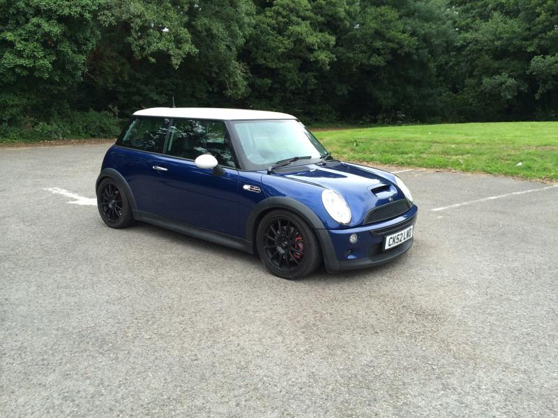

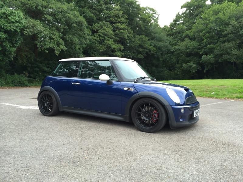

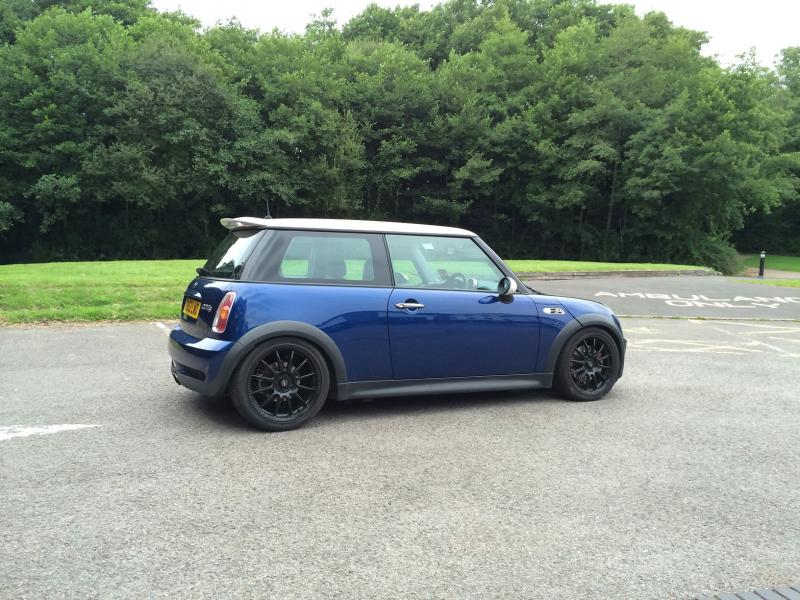

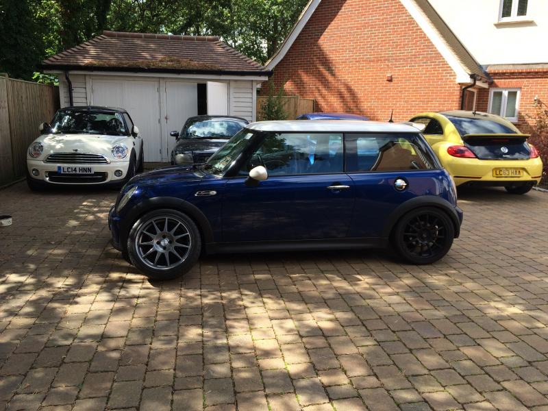

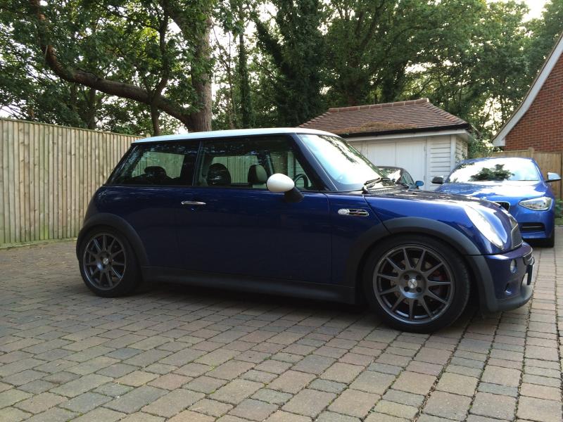

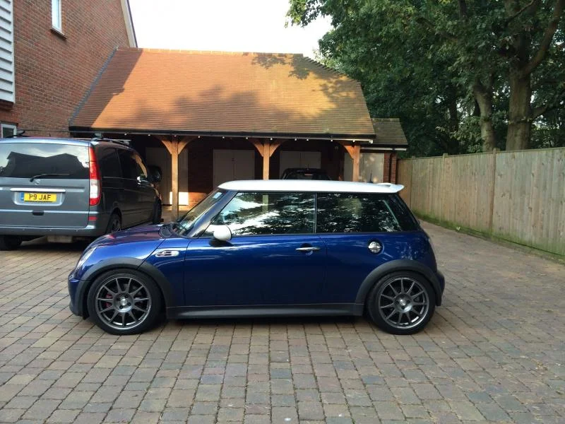

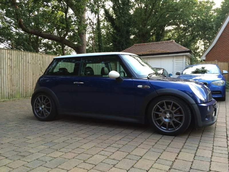

Then the wheels. Couldnt get the 1cm pre-load off the coilovers (as they are currently rather seized), so tried just bunging them on with the height as is. Fitted perfectly, although the drivers side spigot ring really struggled to go on as the hub seems slightly distorted. Rich prob never noticed as he used plastic spigots for the PR1.2's, but the turinis have metal - cue a fair bit of head scratching, swearing, filing & eventually use of a large hammer. So they are on, but swopping wheels again might cause some problems, so ill need to look into a solution next weekend really. More filing required i think. Anyways, i like the look, Cliosport spec now, just with more power :p
Next weekend, get the pre-load off the coils to not only raise it up slightly, but improve the currently awful ride quality!
