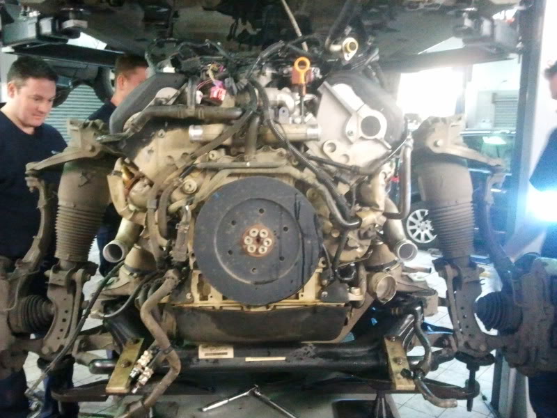

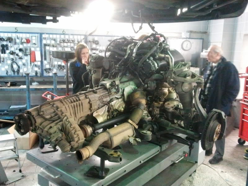

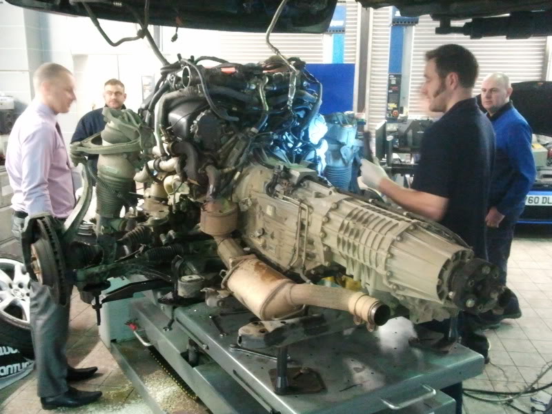

    We had one in which needed a few things doing, mainly the sump was leaking and the tandem pump was too.
    To sort these out, due to the setup, the engine needs to be removed.
    It's a fairly big job, it is pretty much crammed in, and it comes down complete with subframe, air suspension, driveshafts and brakes, gearbox and transfere box.
    So while it was out, I thought id grab a few pictures, if anyone is interested
    [​IMG]
    [​IMG]
    [​IMG]

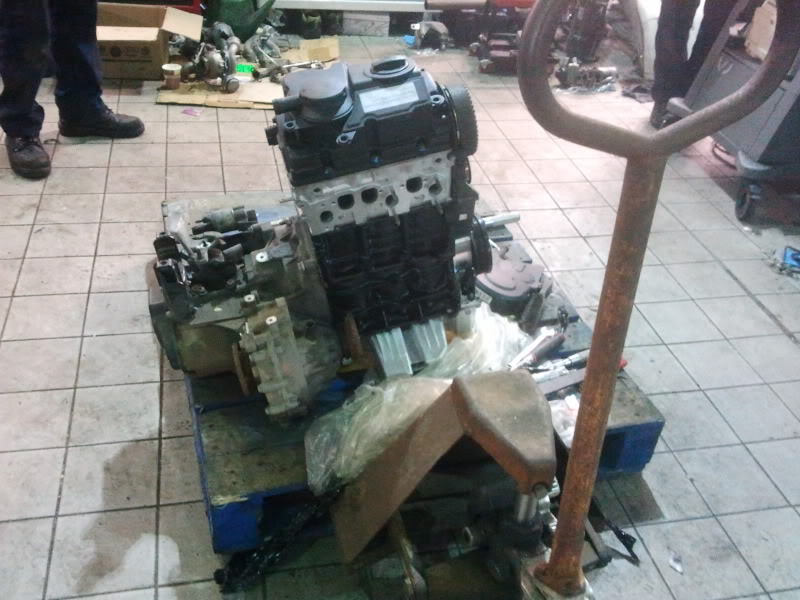

    Compared to this, which is a 1.2 3 cylinder unit out of a Polo bluemotion - bit of a size difference lol
    [​IMG]

    Sump re-sealed, plus anything we found on the way - tandem pump gasket was leaking, so we sorted that, plus a few other small bits, P/S leak sorted.

    Oh, the trolley it is on is a VW tool especially for removing the engines out of Touraeg's, Phaeton's and Audi's Q models.
    It is about 3.5k's worth, and requires 3 phase electric to run it, nice piece of kit, beeps like a reversing lorry when moving it up and down - id hate to even attempt to do it without it! lol
