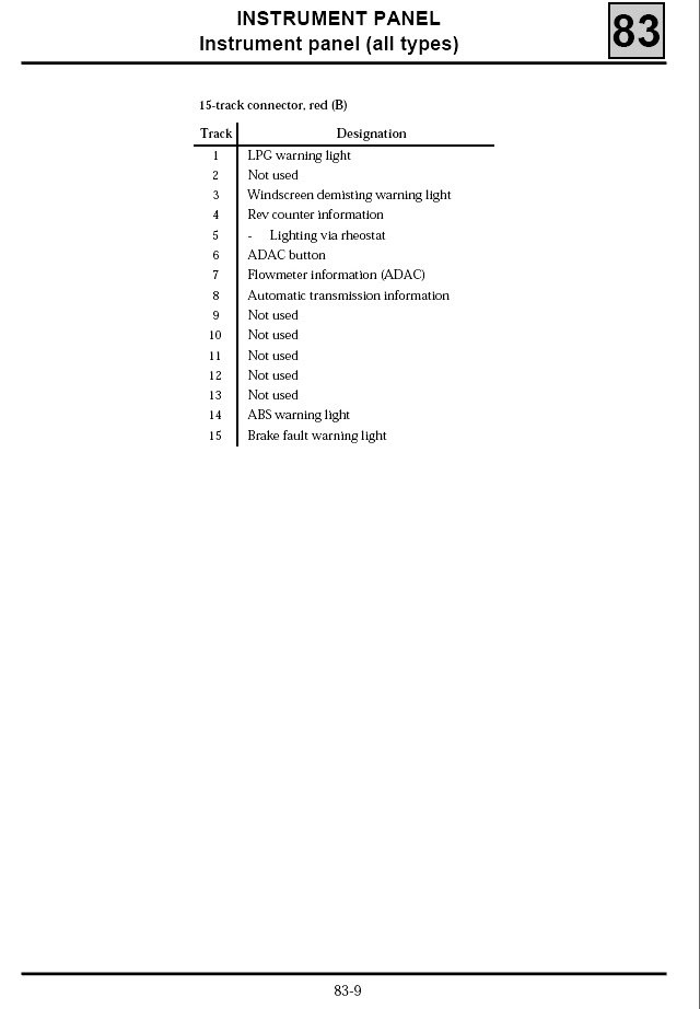

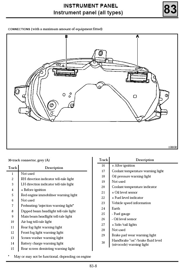

I wish to fit a Race technology data logger and Dash2 to my 182 race car. inputs for the logger I can pick up with independent sensors but for the dash I would like to use existing wiring for warning lights and fuel gauge etc. Does anyone have a wiring diagram/colour code or connector pin out information please?

Try that.
