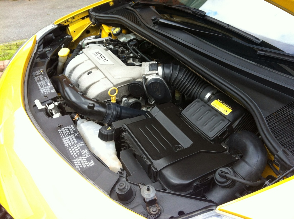

    The air box has the air feed which is the pipe in the middle, then there's the pipe going to the throttle body at the back of the air box, then the one to the right of the air box is the acoustic valve which opens at over 5krpm iirc. It's closed most of the time to keep noise down

    It's the one on the right say I was to make my own induction and use the throttle pipe one for the filter rip out the cold air feed what do I do with that valve one on the right leave it there or does that need to be on the incoming air feed pipe to the induction filter trays all I need to no ill eventually get my car dynod to see if Its a loss or gain .
