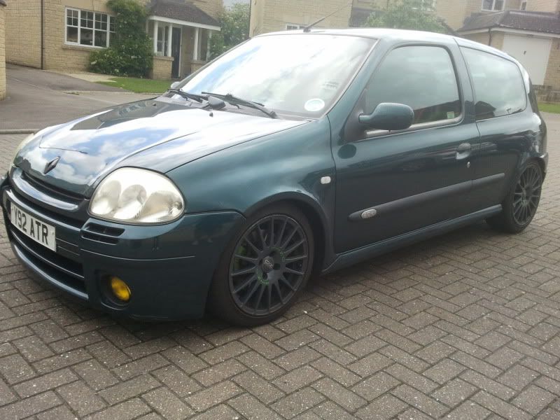

    Ok I will admit I have a problem
    After going through:
    Mk1 RSi
    Mk1 16v
    Mk1 16v
    Mk1 16v hybrid
    Ph1 172 (My itb'd black one)
    Ph2 182 LY
    Ph1 172
    Ph1 172 Exclusive
    Duf (Willy 2) - Which I still have currently
    RB 182 (Sales car, mind)
    I now have another Exclusive lol.
    This one I took in part exchange, but I'm going to hold onto it.
    Some of you will probably recognise it, as I believe it has been owned by 3 CS'ers and is a good spec:

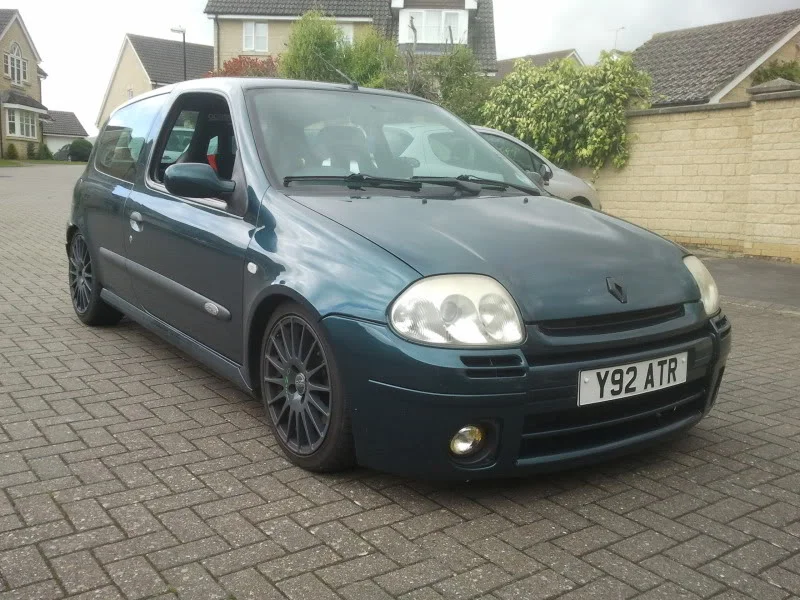

    2001 172 Exclusive
    71,000 miles
    No Exclusive number - I believe the car is an import (reg document says it was first registered in the UK in 2004, though it has an alarm, which is rare for 172 imports I believe?)

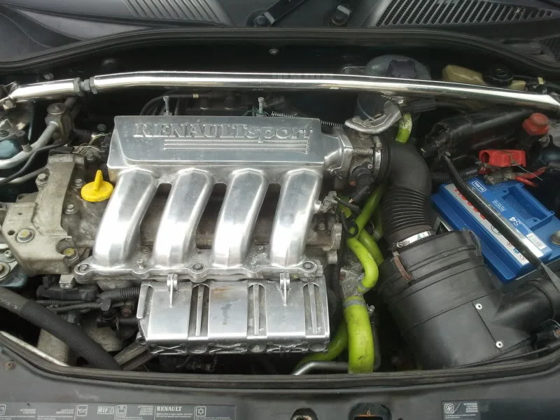

    Engine
    Remapped with RS tuner
    Ph1 airbox with uprated filter
    Ktec mild steel stealth exhaust system with decat (I have the cat, this will be going back on)
    Green Samco coolant hoses
    Bailley polished coolant bottle
    Polished inlet manifold
    Polished fuel rail cover
    Vibrotech solid engine mounts
    Powerflex dog bone poly bushes

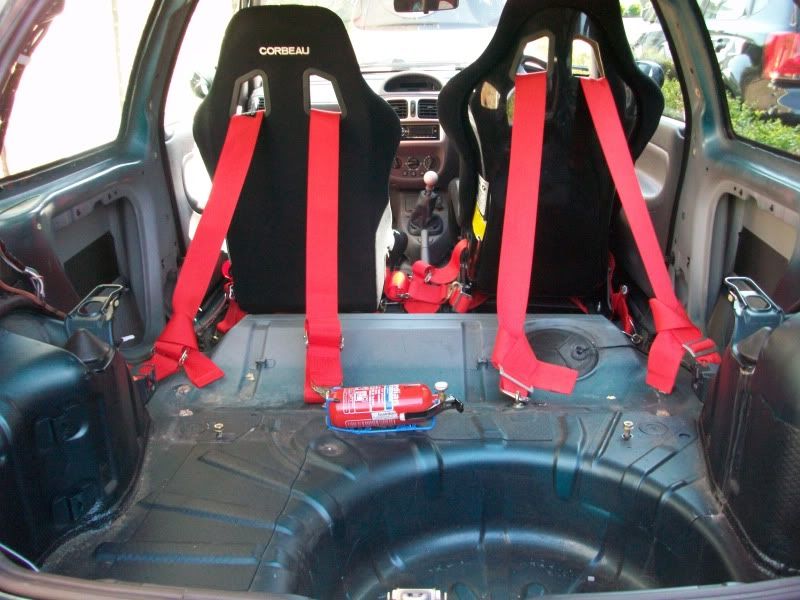

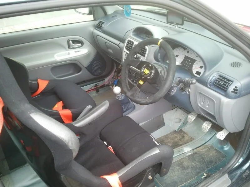

    Interior
    Alpine CD head unit
    Genesis 2 channel amp
    Uprated door speakers being powered by a Genesis 2 channel amp
    Fully stripped
    6 point 3inch harness's
    Corbeau pro series buckets
    Omp 330mm suede wheel and boss kit
    Rear wiper assembly removed
    Suspension
    Gaz height and damping adjustable coilovers
    Front strut brace
    Powder coated wishbones with Powerflex bushes
    Powerflex anti-roll bar bushes
    Whiteline rear arb kit
    -2 degree rear camber shims
    Brakes
    Fronts have Brembo HC's and DS2500 pads
    Standard rears (renewed last month)
    S/S brake hoses
    Brake fluid changed to 5.1
    Wheels
    Refurbished OZ Super-T in 16", powdercoated in grey
    Toyo T1R tyres
    It doesn't owe me very much as it has come with an engine rattle, which is a shame as I can tell it has been very well looked after by it's previous owners.
    It seems to have a rattle/tap on light throttle, but very little on load and nothing off throttle, which I think may be internal damage - possibly a bit of oil starvation has damaged a bearing shell - not sure at the moment, so when I get time I will have a better look but to be honest with how cheap F4R's are now I think I will just chuck another engine in it.
    Apart from the engine noise, it drives fantastic and is very much like a go kart - the front end is so tight and responds to the smallest steering inputs - very good fun!
    I haven't made many plans for it as yet, as said I will most likely have another engine in it, and then strip this one and see what the damage is, I will be removing the polished inelts and fuel rail cover, and will be fitting my spare set of inlets I have (Though I will match them before fitting)
    The stainless header tank will be swapped for a standard one, and the strut brace will be coming off too, and I will be looking for some 15 inch alloys to replace the 16's that are on it at the moment.
    The Apline head unit might be going as it looks far too complicated for me
    The interior will be tidied up, the glue/sound proofing removed and the seats will be moved to a more comfortable position for me, and I will keep an eye out for a cheap cage - I may also fit a 172 cup gearbox - apart from that I will just be tracking it and thoroughly enjoying it

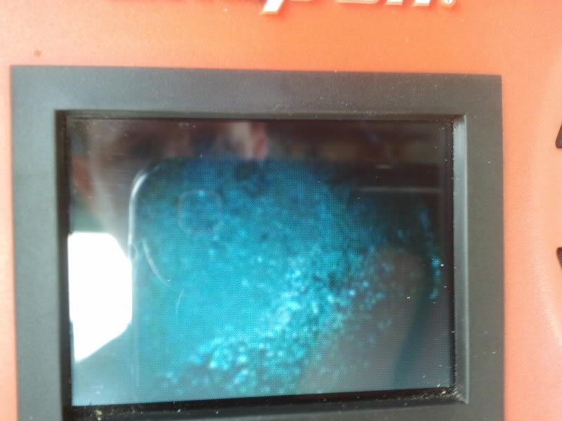

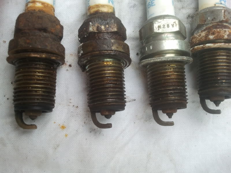

    Shhh you lol, must come and have a nosey around my old car now it's a race car

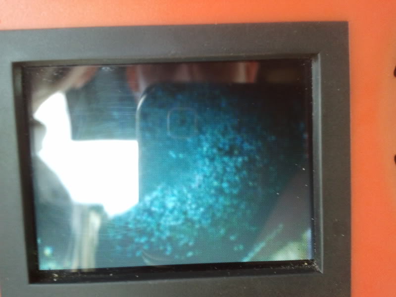

    Just had a spare 10 minutes so thought id whip the plus out ready to bring my mini cam home from work to have a nosey in the cylinders, and this is what the plugs look like:
    the two plugs closest the gearbox side are completely missing their tips
    as you can see there has also been some water in the plug holes at some point as they are pretty rusty

    Need to find a cheap set of plugs to chuck in, f**k putting those back in
