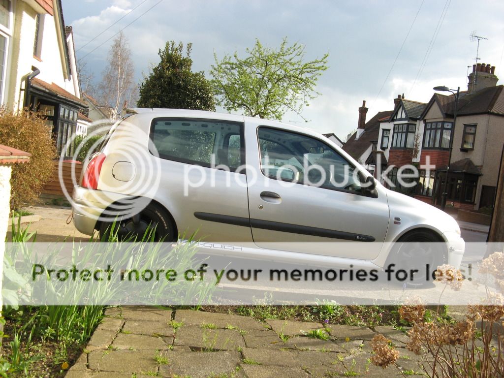

    Yup. For a road car, you dont want to just slam it on the floor, ie:

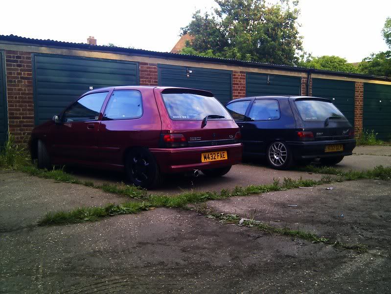

    Heres mine
    Doesnt have baloon tyres anymore mind, So looks a tad strange, Drives well though, Nice playfull rear end when you want too.
    Infact Jim might recognise the pic

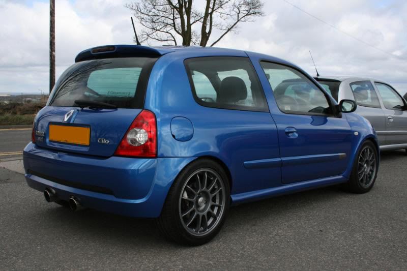

    Here's mine on Coilie's
    Opinions welcome

    ^^ Need to clean the oil stain up
