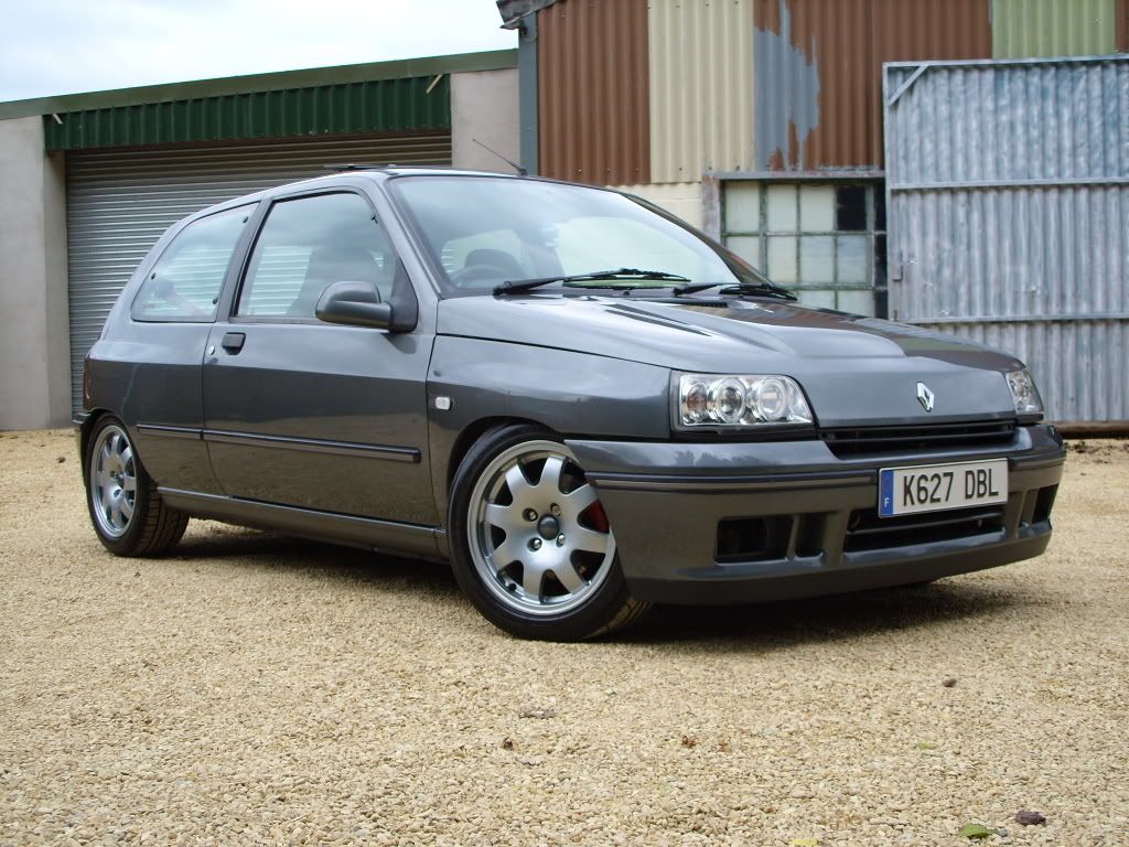

    So i've had this car for nearly 4 years. I bought it from a member on here, Brad Harding, back in sep 2008.
    1993 K plate Clio 1.8 16v with a Hybrid 2.0 bottom end.
    This project has taken a long time (and still isn't finished! lol) owing largely to the fact that I have two small children, a wife that will be ill for the rest of her life and two businesses. Basically, I don't get much time! But this car is my baby and I don't care if it takes another 4 years, as long as its done properly.
    I first saw the car on here way before that and as soon as I did, I sent him a pm stating that i'd buy it as soon as he was going to sell it. Two years on, he pm'ed me and I jumped in my wifes car with my dad and was off to Leicester as fast as possible...
    Now, whilst it was a nice looking car, I can honestly say I bought this thing with rose tinted glasses.
    SO I drove it round like that for about 6 months. I changed the headlights from the awful angel eyes back to the originals.
