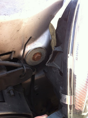

    The nearside headlight was knocking. I had a look and found this:
    Note: large washer, but still cracked plastic bracket.
    Home made top bracket FTL.
    I've removed the headlight and ordered a new one.
    Looks like someone has nudged something with the bonnet and thus it's broken the light brackets.
    Bit of panel beating:
    It doesn't rest on the light now at least. One job done.

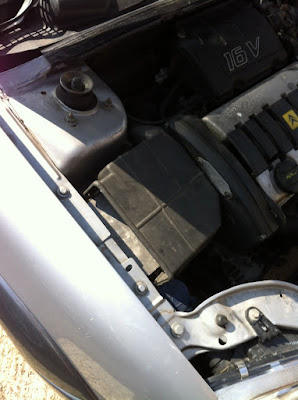

    Next, the ECU cover...
    It wasn't fitting right and rattling away, so much so its started to rub through some cables.
    And rubbing on the bulkhead as pictured too.
    Cable protection restored and made my own bracket adjustments so it fits snug with no rattles.

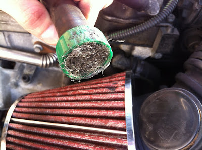

    Next up was the air filter and cam breather...
    Home made cam breather - oh dear. YES that is wirewool and a bottle top.
    Whipped that off and the air filter. Will probably end up saving for a simota intake but have ordered a generic 19mm breather to go on for now.
