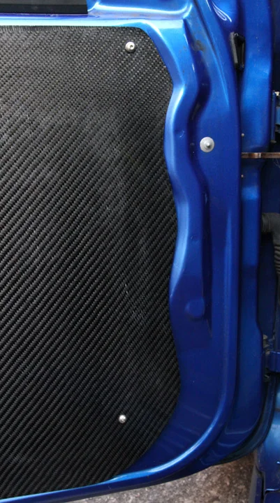

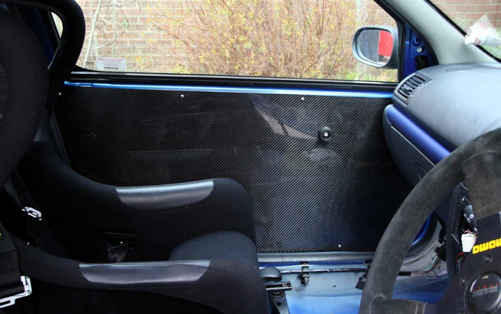

    I'm doing a bit of work on my 172 Cup to make it track-ready, so will post updates here as and when I've done anything. Won't be anything special compared with other cars like Chrispy's, but it'll keep everything in one place as reference for me...
    Here's a thread I made when I first got the car a couple of weeks ago:
    http://www.cliosport.net/forum/showt...-me%29-172-Cup

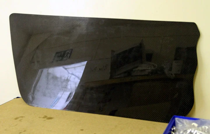

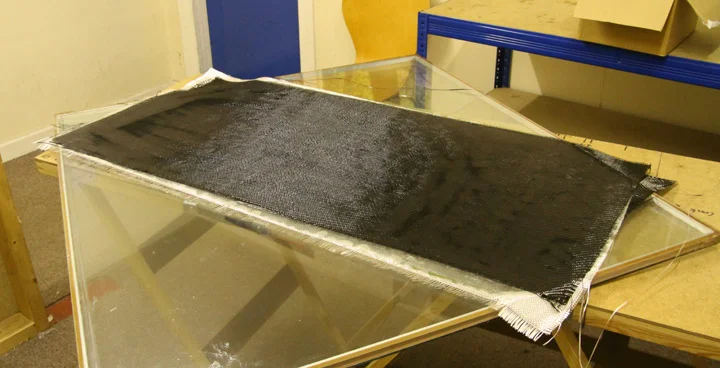

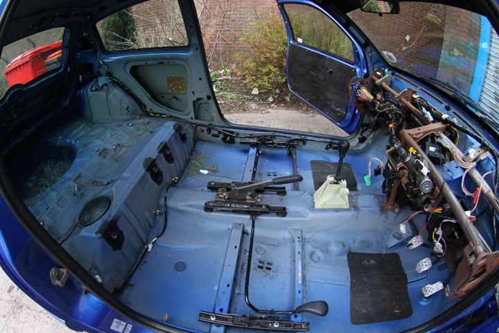

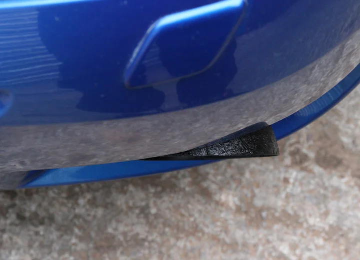

    Since then I've ripped a load of stuff out and saved approx 25kg, added a Skoda front splitter (will make a 'flat' carbon one when time allows) and had a go at making some door cards... Photos below!

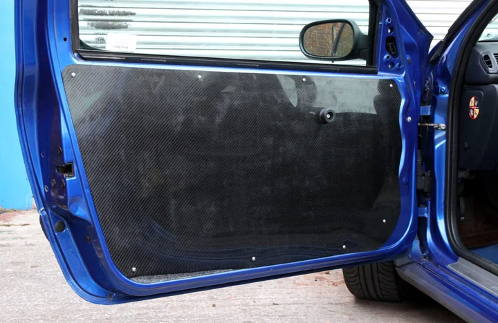

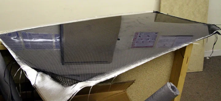

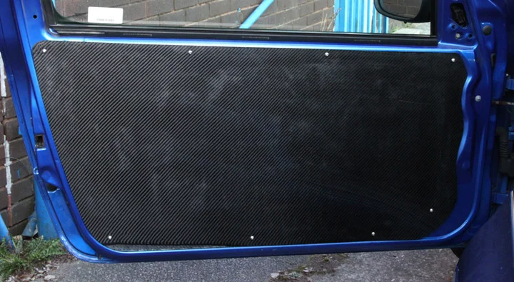

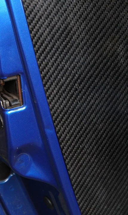

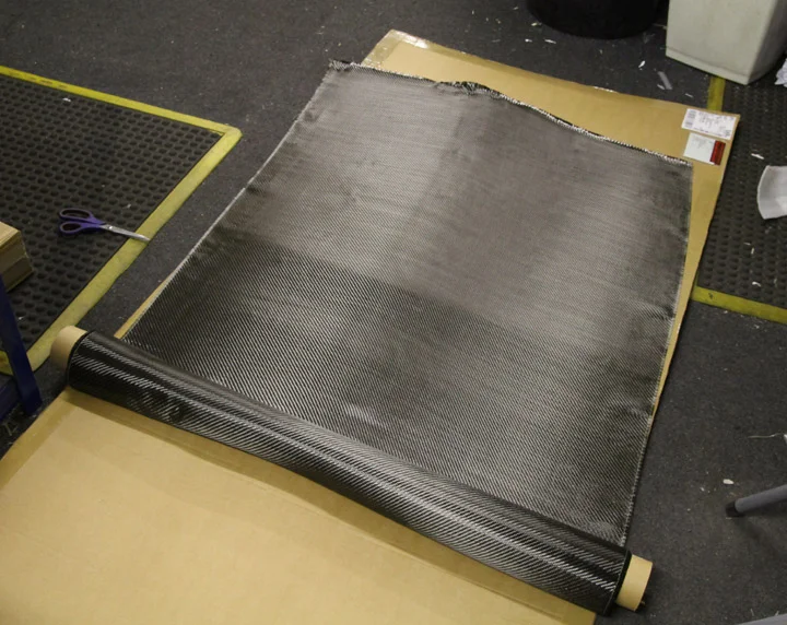

    1) Scarily big bit of carbon cloth, don't wanna feck this up!

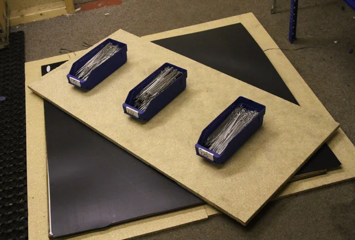

    2. Laid up, ready to cure. Took about 2 hours...

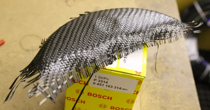

    3. Bit of weight, and left for 36 hours... Possibly not enough as some of the resin pulled away with I released it
    4. However, came out pretty well for a first go, reasonably happy. This is straight off the mould, no polishing.
    5. Trimmed down.
    6. Test fitted.
    7. Checking fit.
    8. Checking fit again.

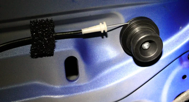

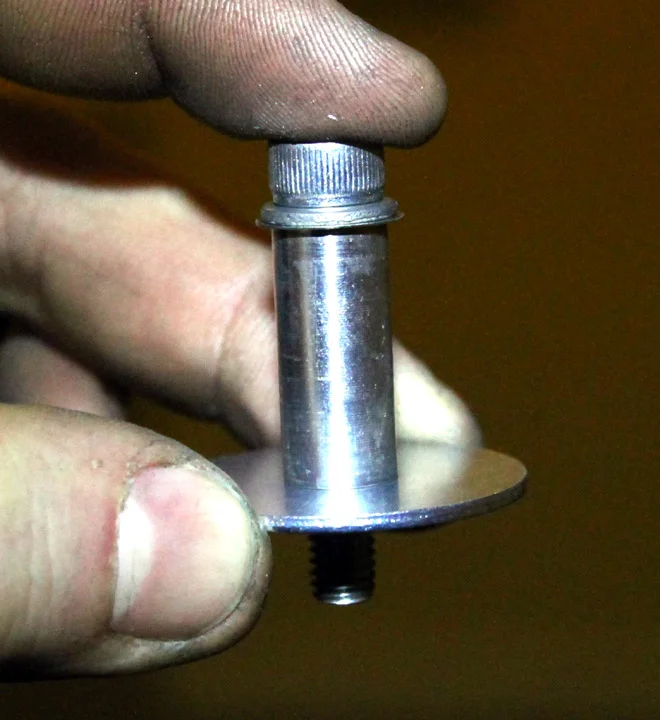

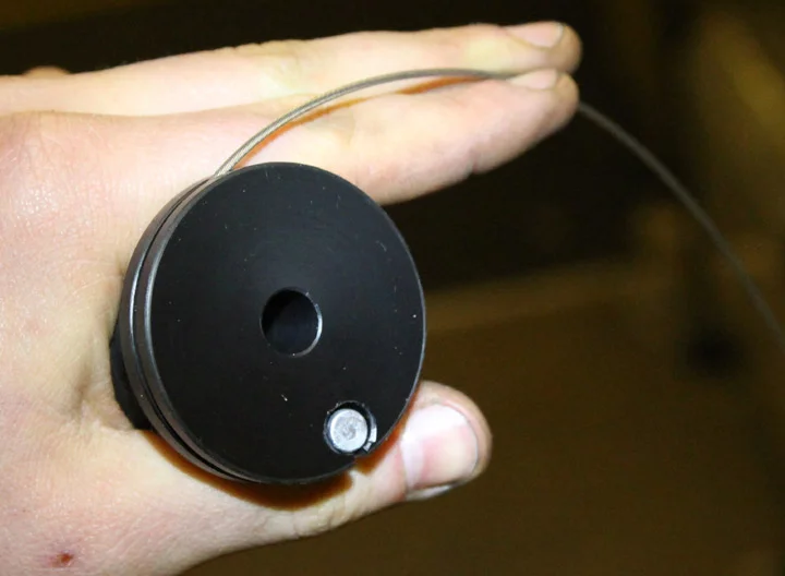

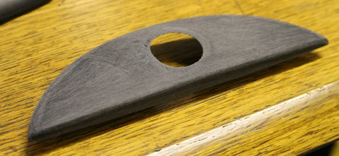

    9. New handle made on my lathe. Wanted to do away with the 'looks like your mums made it on her sewing machine' (nothing wrong with that mind!) pull cord and bin off the original door catches, so had to come up with something that would do both jobs...

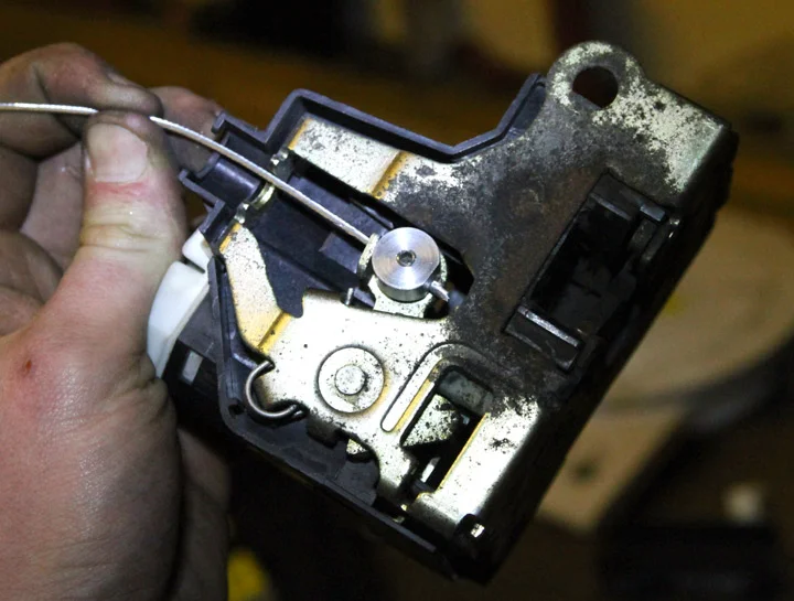

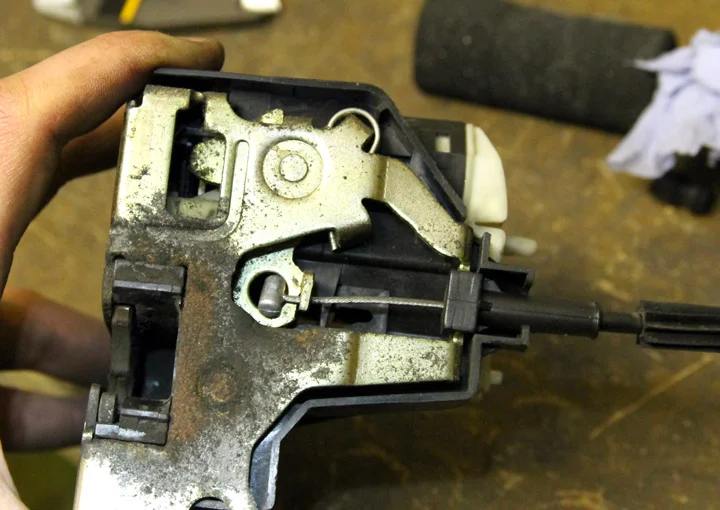

    10. Bicycle brake cable is exactly the same as the cable pull for the catch, fits into the new handle like so...
    11. Other end - normally has a small bit of plastic to shim out the nipple, so had to come up with something to replace it since I would be cutting the OE cable and just using the outer from it.

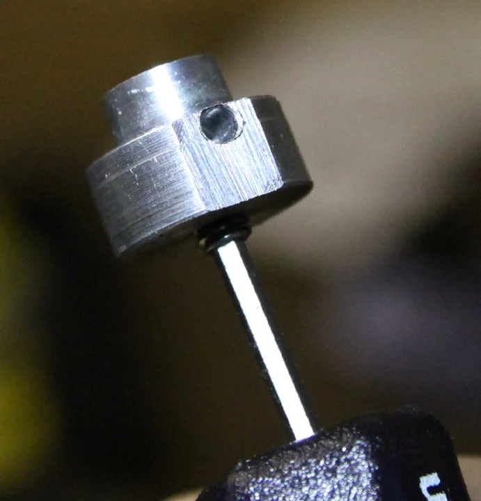

    12. New cable clamp with grub screw (filed a flat section to make it easier to start the cross drilled hole).
    13. How it looks/fits in the catch.

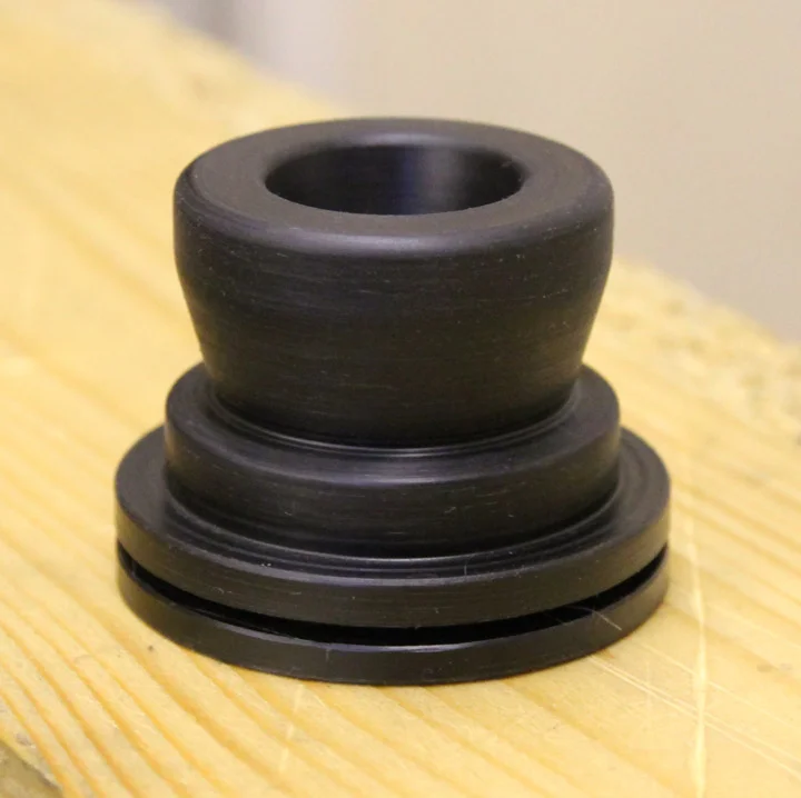

    14. Boss to fit the handle onto, bolts straight into the existing fixture for the OE handle.
    15. Test fit, turn clockwise to open the door, pull to close it
    16. All done!
    Reasonably happy with it, not perfect by any means, but learned a lot for the next one and should be much quicker now I know what I'm doing. Don't think I'd bother making a pair again, the materials cost about £60 so a pair at £115 (performance trim) and not spending ~4 hours each making them is pretry good price! Anyone got any close up photos of the PT ones btw?
    Any questions just ask!
    Next job: Fit roll cage. Should be here this week if all goes well...

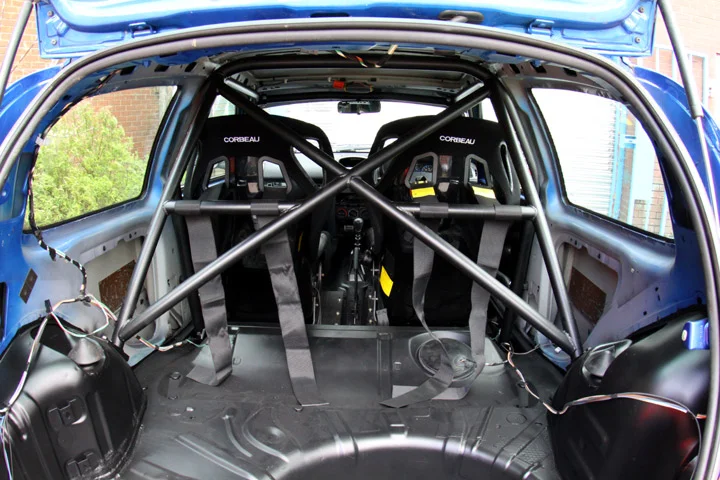

    Cheers - got a Safety Devices 6 point bolt-in on order, should be here next week if all goes to plan...

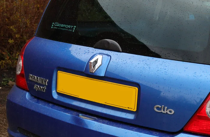

    Another small update, rear wiper is off and carbon skinned the cap. Not a great job but was in a rush... may re-do it at some point!

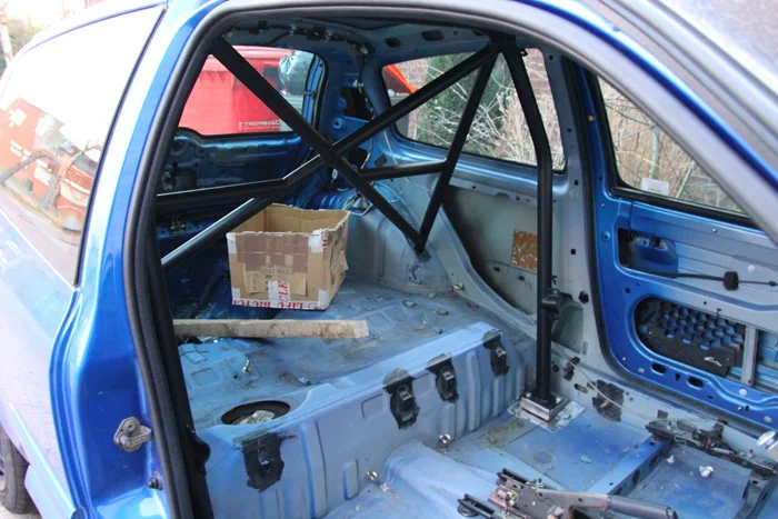

    Cage arrives today! Got my ass to work half an hour early to pull stuff out...
    Had both parts of the dash in and out a few times now so if there is anyone who wants a hand with it just shout... There is a guide for the top half but couldn't find one for the bottom bit. Was a bit tricky 'blind' but with some guidance I can see it being pretty straightforward!

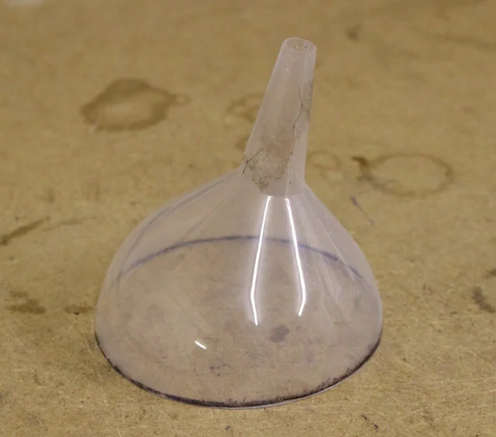

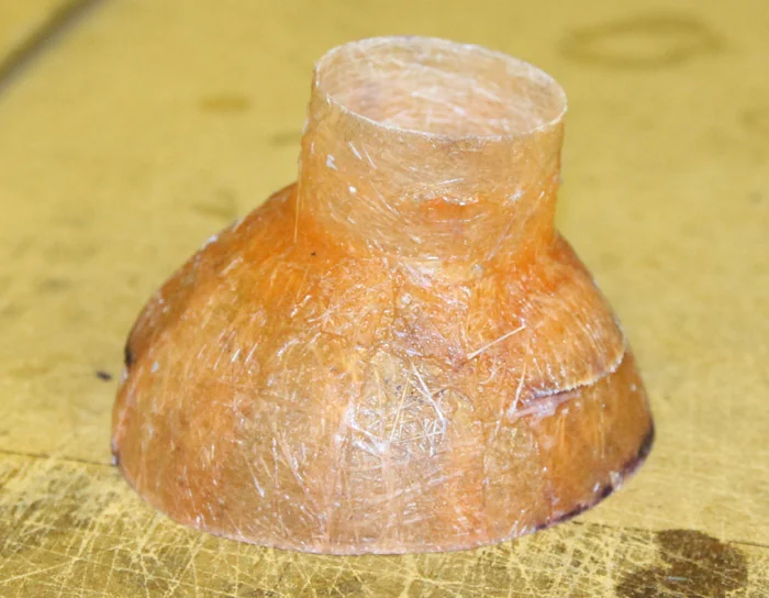

    Couple of updates...
    Been prepping for cage - Safety Devices 6 point bolt in - just needs a bit more paint out around the towers, then ready for welding... Hammering the arches flat was scary, haha. Then the mammoth task of sanding and spraying the interior

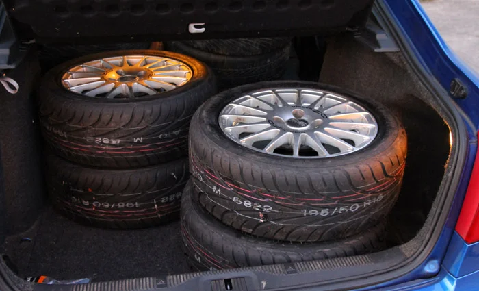

    Got wheels (15" Superturismos - thanks to beng-120!) and tyres (Federal 595 RS-R) sorted...

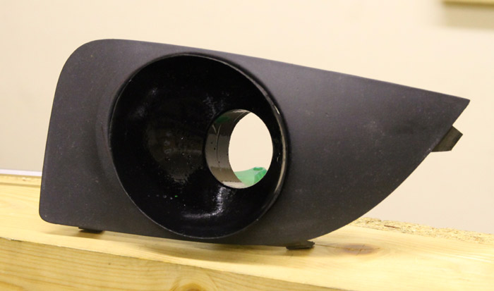

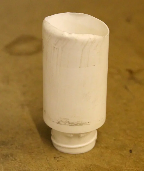

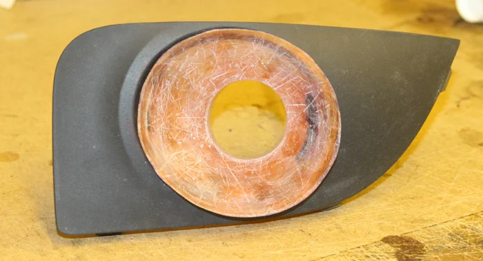

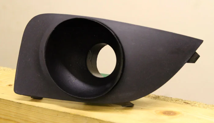

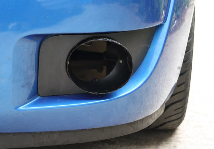

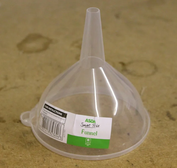

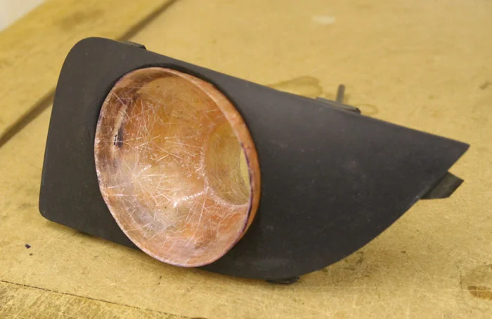

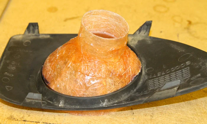

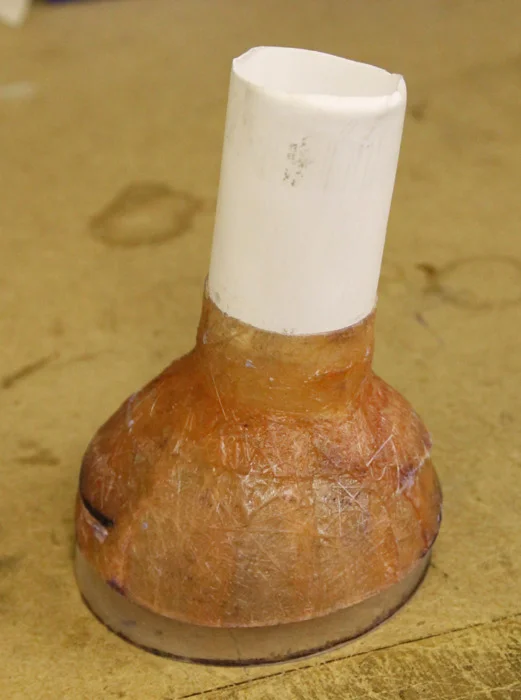

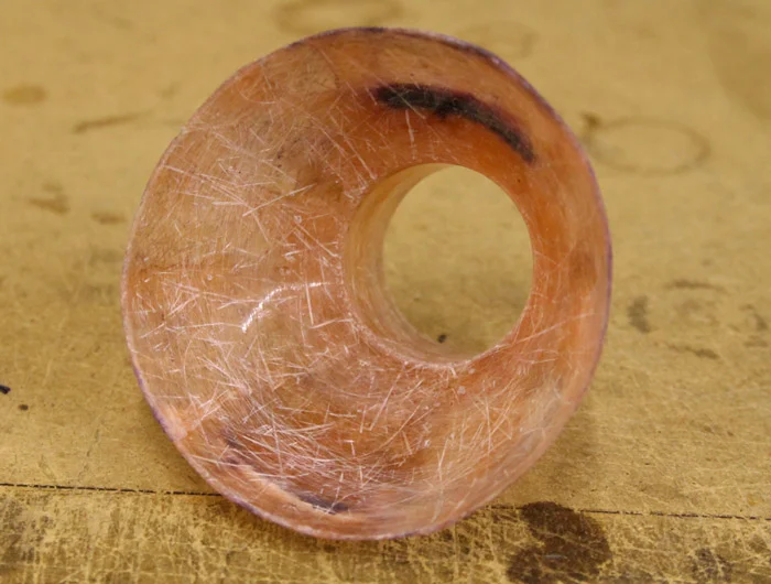

    Then had a go at a brake duct today at lunch and after work. Seems to have come out ok for an hour's work, but might tweak the fixing method a bit. Needs building up a bit 'higher' at the very least I think, you'll see what I mean from the photos...
    47p funnel from Asda
    Chop chop...
    Old Cod Liver Oil bottle - 48mm diameter, builds up to 50mm diameter when fibreglassed around, ready for 51mm ducting...
    Moulded in in two parts (funnell first, then tube) but gives you the idea...
    Added some tabs on the side...
    For clipping into the fog light surround - makes a nice 'snap' when it goes in!
    Quick blast of black spray paint to check how it looks. Not toooo bad considering it's cost about £2 and took about an hour. Considering trimming the excess off but it will obviously 'scoop' more air in as it is... Will probably re-make this one as it was a bit of a learning process.
    Will update in a few days/a week once more stuff has been done

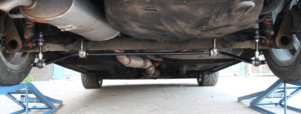

    - Fit RARB if/when it arrives...

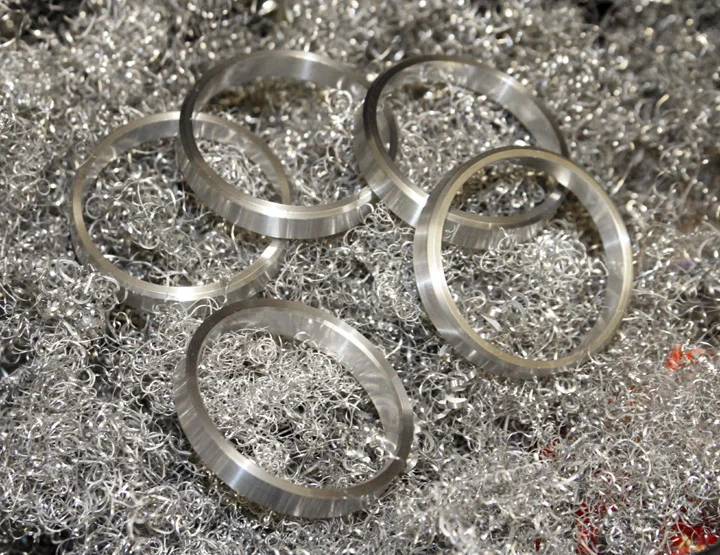

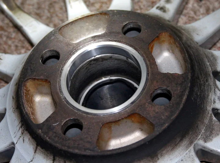

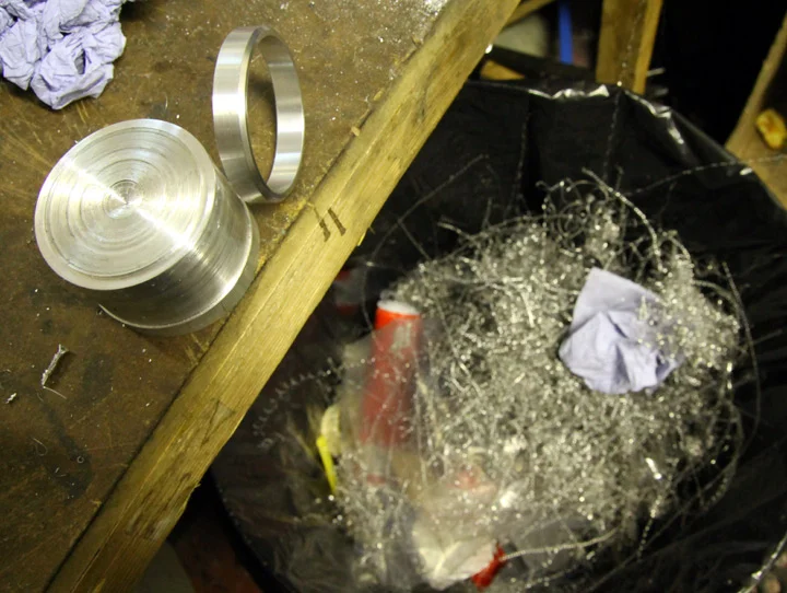

    - Turn up some spigot rings for track wheels (not paying £75 for official OZ ones!) - got the ali bar though the post today
