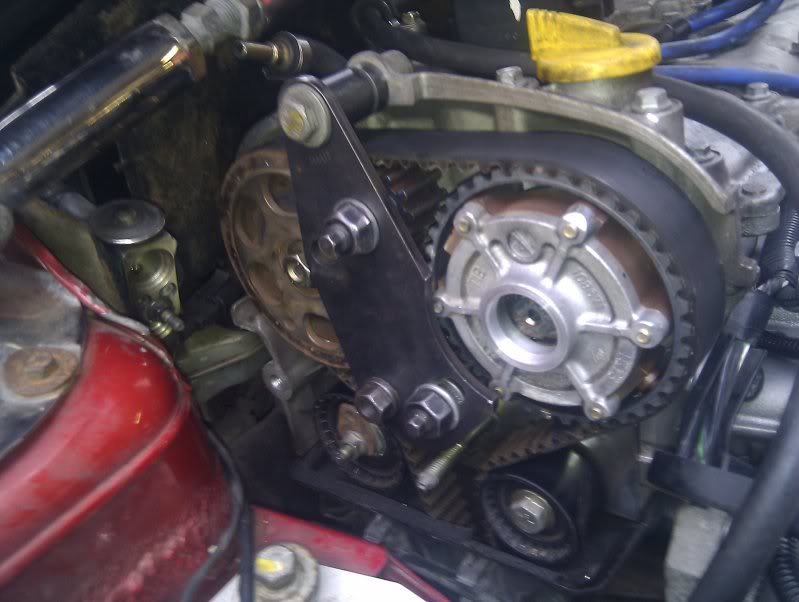

    Not sport specific exactly, but there's extras for vvt, pulley locking tool that only Renault make, and isn't mentioned in autodata. If they went by autodata, they did it wrong

    SO there are more tools than the pin in the side of the block and the locking tools at the back of the Cams?
    I did the cambelt on mine with my step dad and I've not had a problem with it since. He's done a few though, had a run of them a few weeks back and even he said to me you can't do the job without the right tools otherwise it screws up.
