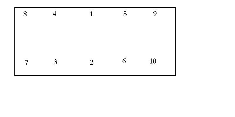

    Hi there, anyone know the torque settings for the head of a 172/182? Im assuming they are the same anyway?!?

    Re: Head bolt torque settings?
    Tighten in the following order to 20nm
    Tighten to angle 1st time to 100 + 6
    2nd time 100 + 6
